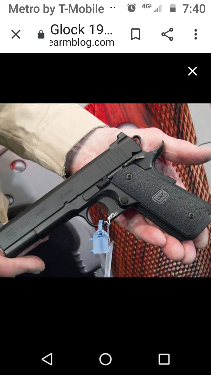

At the Action Steel shoot today in Orlando (CFRPC), during the pre-match announcements it was noted that while P320s would be allowed today, the further usage would be determined at the club meeting later this coming week. Sig fanbois were directed to go to the website to see if there would a ban for later matches. :eek:
Later, one of the members theorized/quipped about creating "Glock"-branded grip modules and slides and offering them for sale... :unsure: 😇
