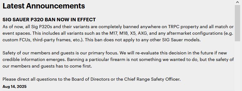

I forget which 320 thread I posted to but the fanboi with three 320s among other SIGs was shooting IDPA at this Titusville, FL club. LINK He's even invited me to shoot an IDPA there and I may have to once they resume next month. But like the CFRPC, they have banned the 320. :rolleyes: Me: "What are you going to use to shoot?" "I'll be using my Staccato." Well lahty-dah! :rolleyes: ;) I guess he's having to send it out to milled/drilled for an optic...
