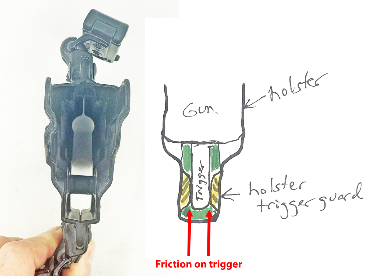

OK... let's see if this makes any sense. I don't own a Sig, so pardon my use of my EDC P80 for demonstration purposes.
The trigger pocket / cover in a holster has an indentation (yellow outline) on both sides that traces the inside edge of the trigger guard. If that indentation is deeper than it needs to be to create a retentive friction point on the gun's trigger guard, it could conceivably put some rearward friction on the trigger itself as the gun is inserted into the holster, right? Perhaps not enough to push the trigger all the way back. But enough to move it... say... a millimeter or two rearward... and hold it there. (continued below the photo)
Then, additional jostling or vibrations may nudge the slide enough to disengage the barely-hanging-on sear, allowing the firing pin to fire.
Here's a diagram I made of the top view of the holster. Again, yellow part is indented part of the holster trigger pocket.
This is how I imagine a potential "uncommanded discharge" happening. The culprit is "out of plain sight."

My little "illustration" wasn't intended to compare Glocks to Sigs. I don't have a Sig, and the Glock was just a "model" gun. It could have just as well been a "blue gun."
I'm just trying to demonstrate how a holster could exert some rearward pressure on the trigger (of any gun for that matter). But combine just enough pressure to pre-stage the trigger AND a sear engagement so precarious that a loose slide could move enough to nudge it "off the ledge" and cause it to fire.

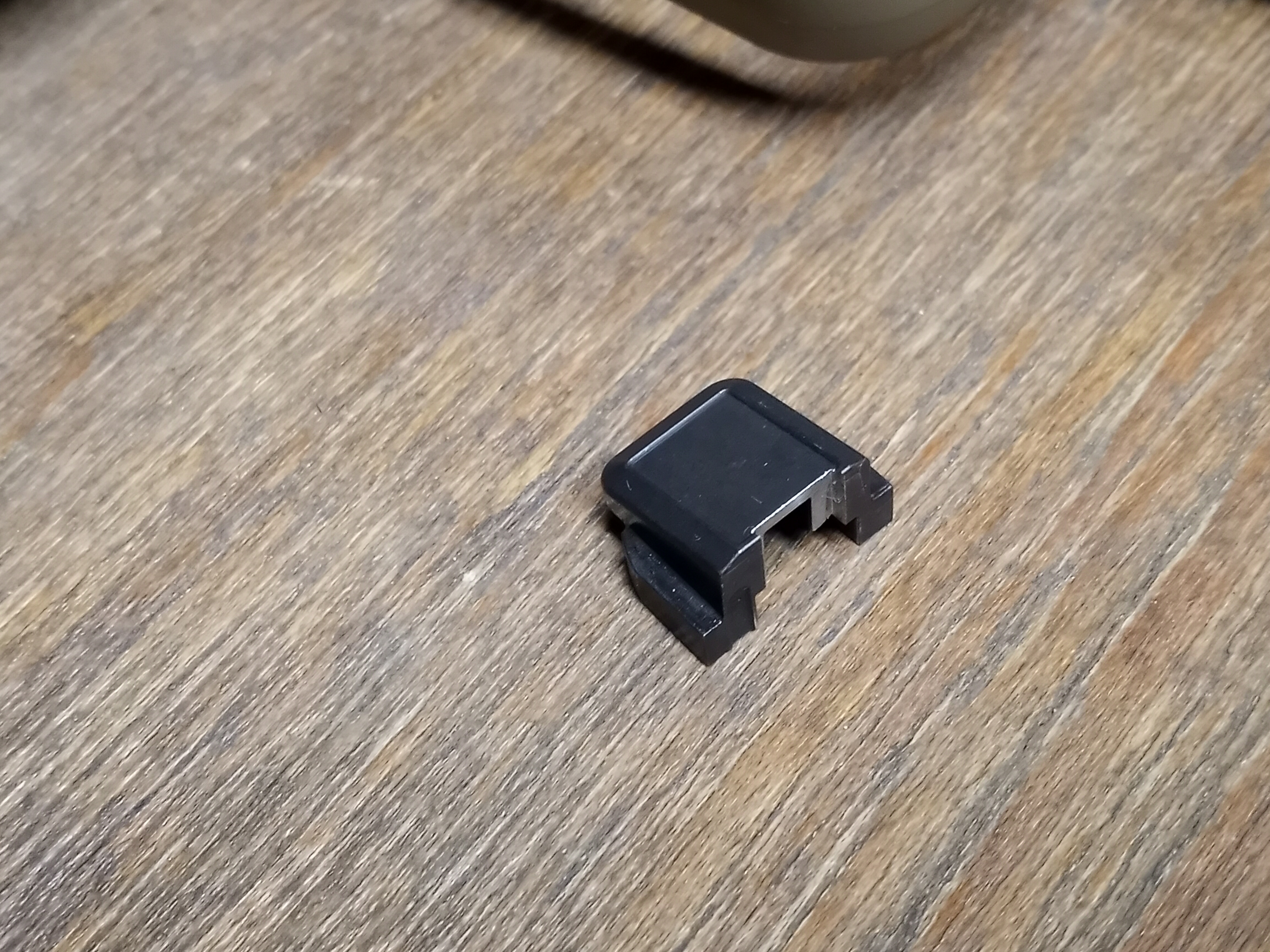

A little something anybody with a P320 should have in the tool box. A cut down slide end plate
Mill off the extension that covers the sear, install it on the slide, and you can visually see the striker/sear engagement, just like the Glock Armorers End plate. I wouldn't leave it on a carry gun for obvious reasons, but on a range gun it is worthwhile to check sear engagement while the pistol is being shot to see if those mating surfaces are pulling themselves towards each other as they are supposed to .
