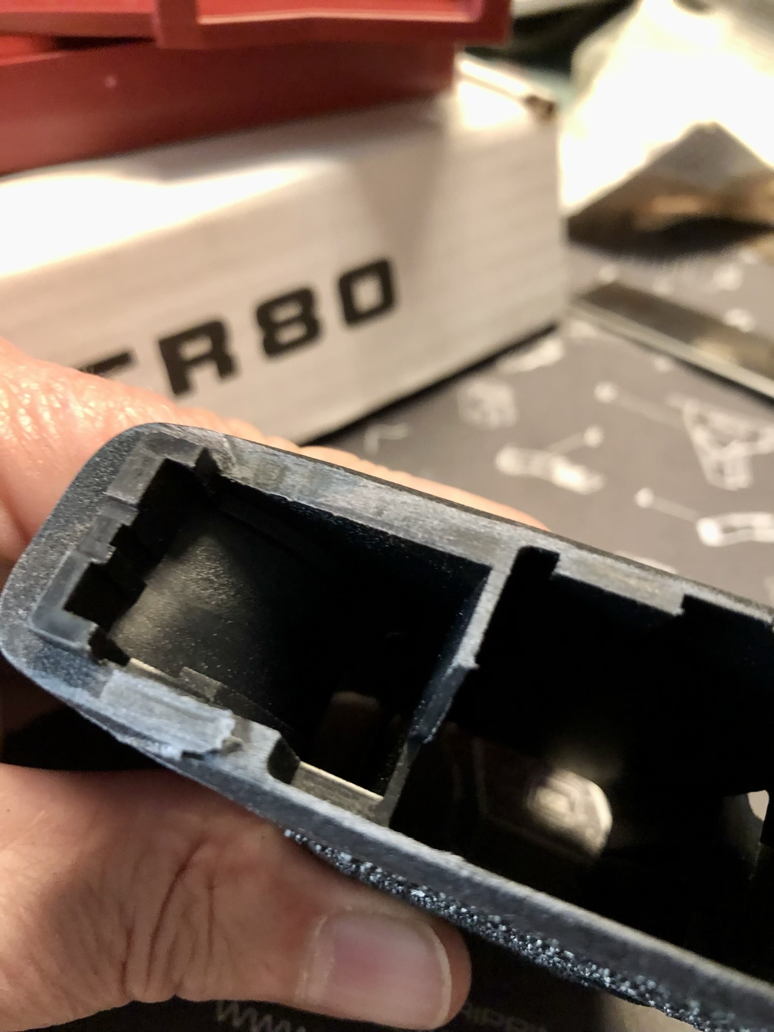

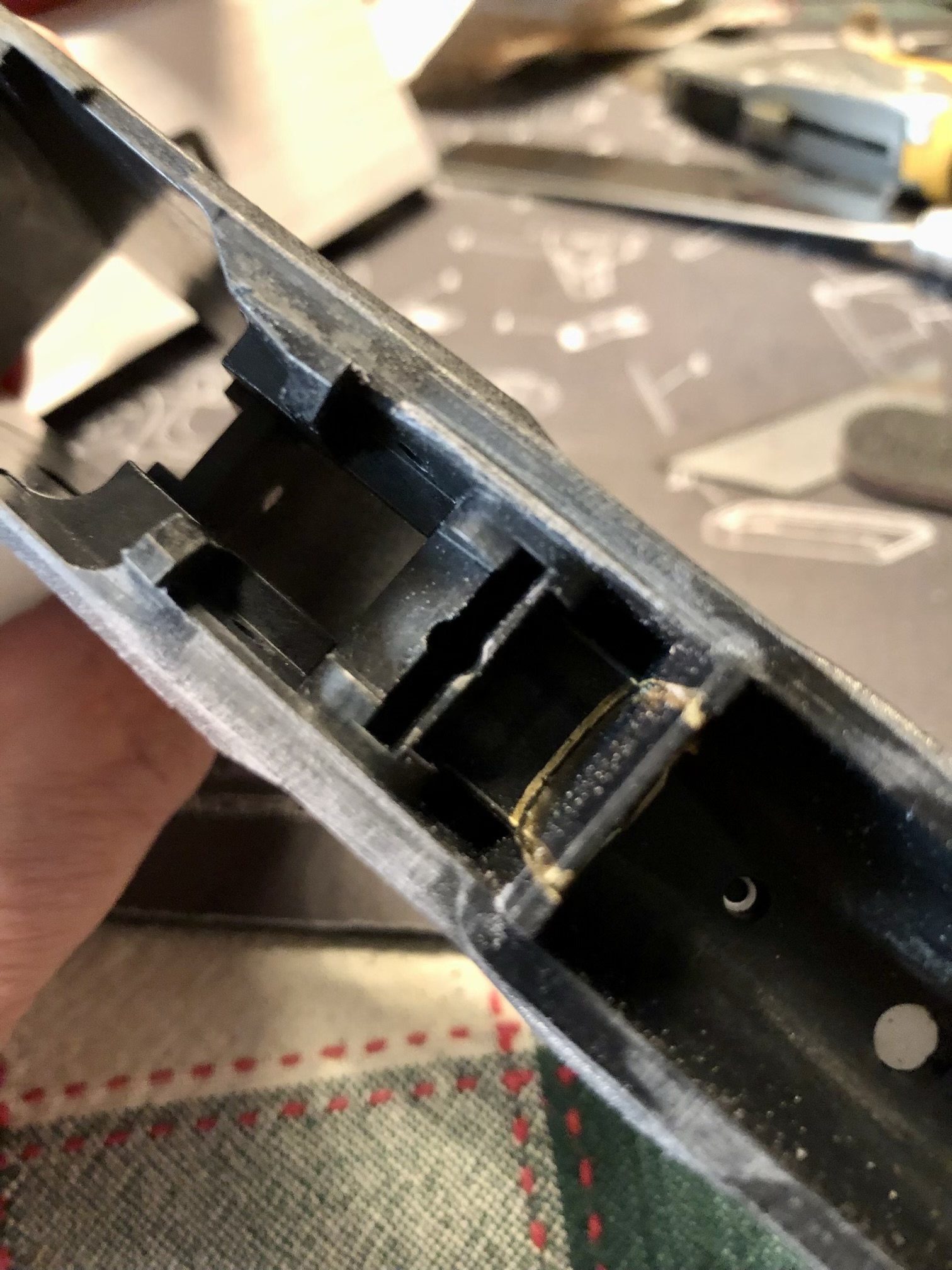

Ok... X-acto Razor saw set is a WIN. I made a mistake on one of the tabs I cut, and have to fix it (superglue?) but overall, this is my new preferred method of tab removal thus far for the P80 frames. I learned that no matter the tab cut, keeping the saw parallel to the frame side (and not 90 degrees) is always the best policy, and you can easily trim the last bit of inside ear of the tab that's dangling, as you want to miss the integral supports and towers cast into the polymer, etc. My goof was making one rear tab cut at a 90-degree angle to the frame. (doh! live and learn....and glue & fix.)
Yup, I have to glue that dog-ear back down & fix it. Aside from that blunder, I really like the X-Acto razor saw approach for this....quite a bit faster and creates a clean cut with far less to clean-up after the cut, vs grinding, etc. YMMV, but it worked for me.
BTW, as I was making that 90 cut on that back tab, I knew better than that and stopped but the owie already had been made. human condition and all that....

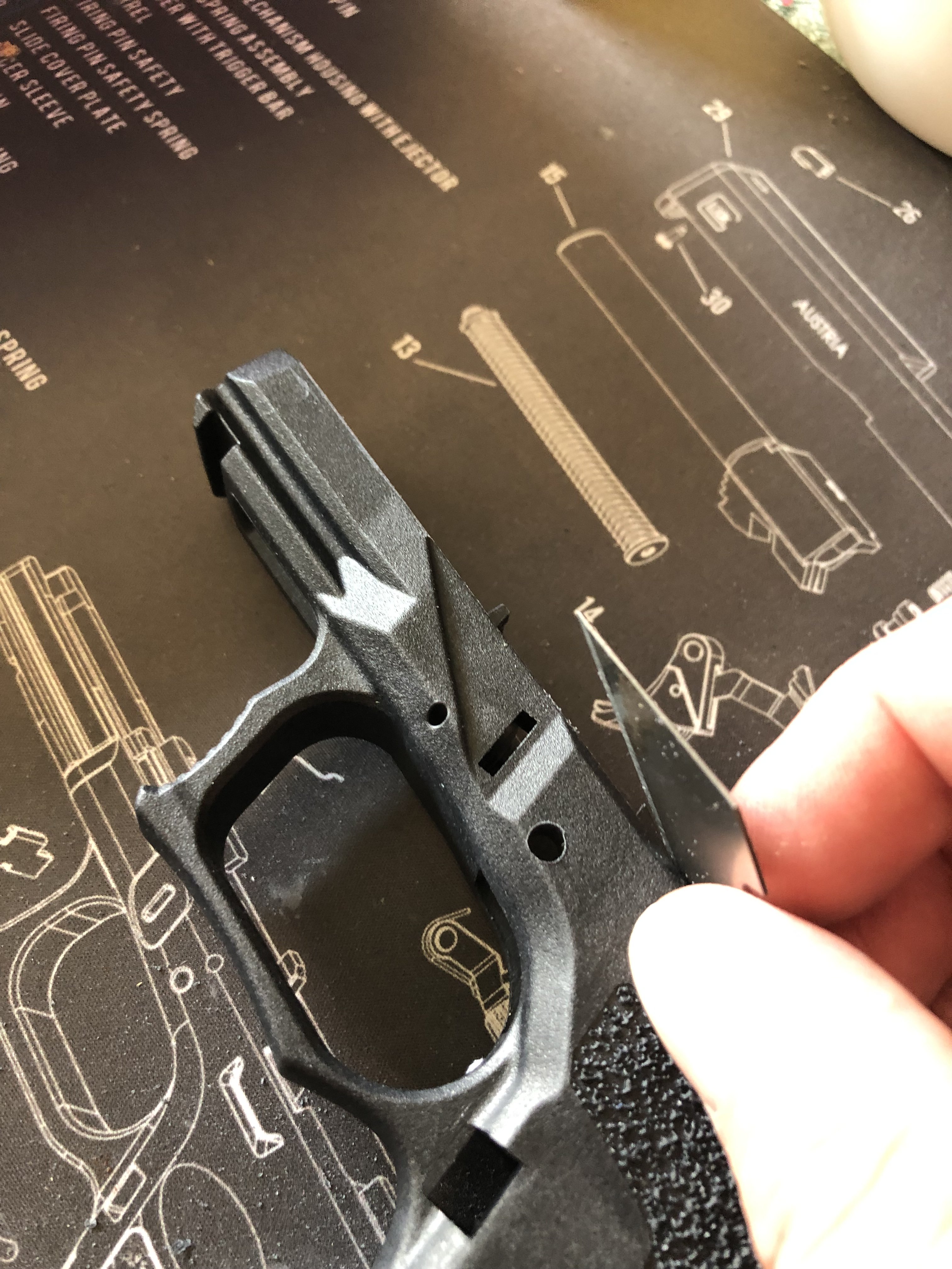

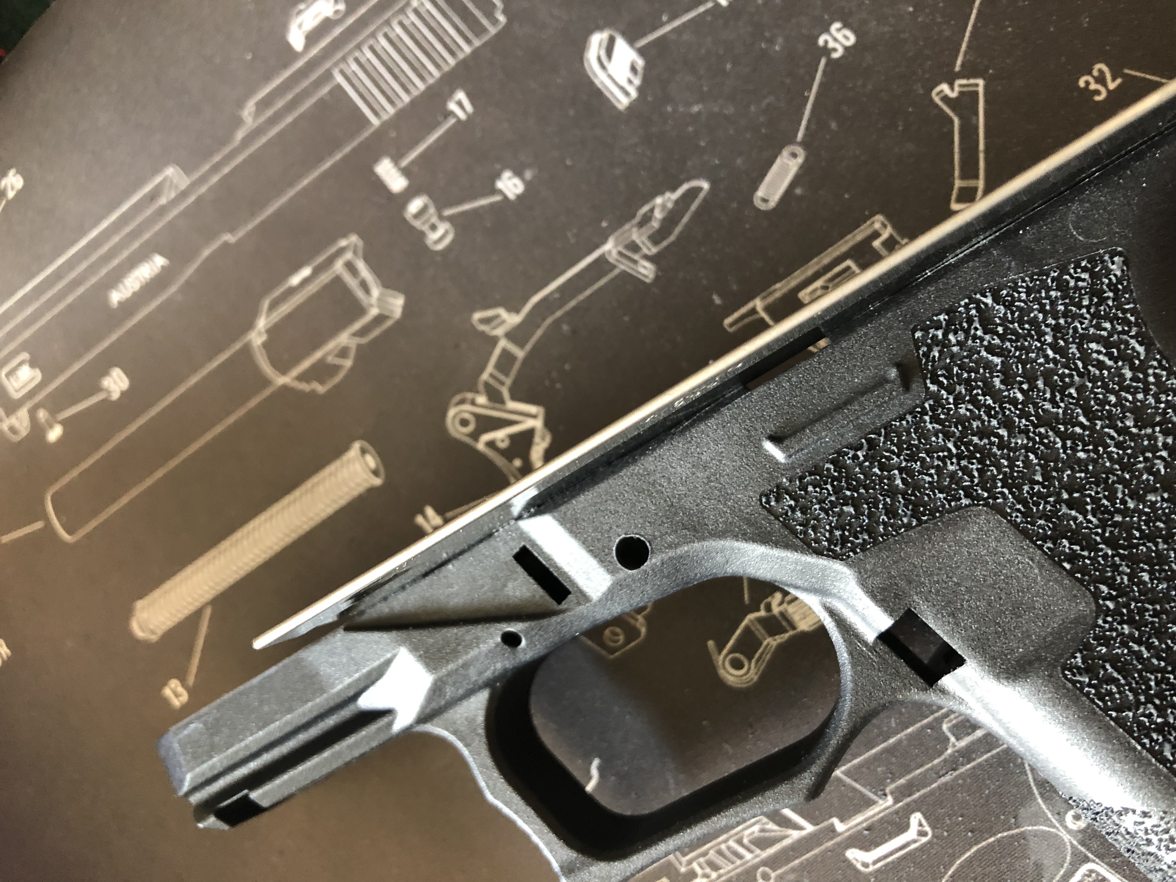

Thanks Racer88. Here are a few pics while I wait..
First, you want to saw like this with the blade flush with the frame:

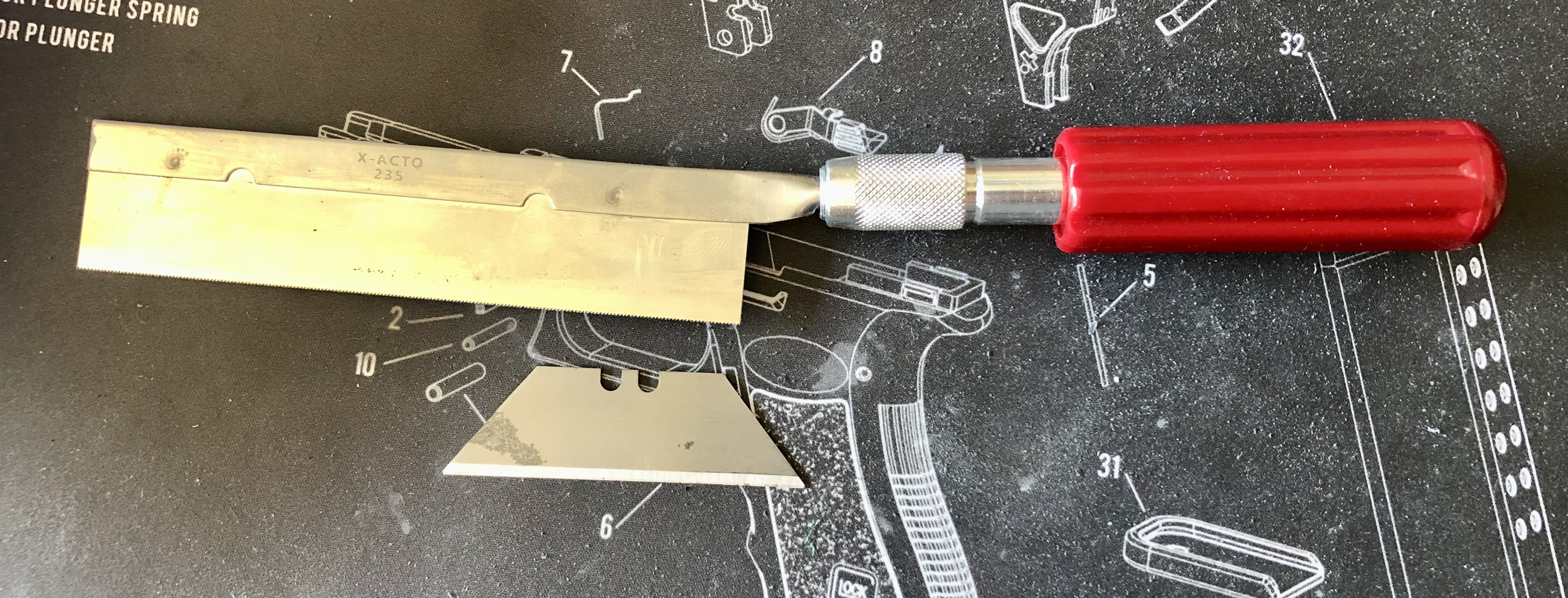

I’m using these two tools for the tab cutting and removal:

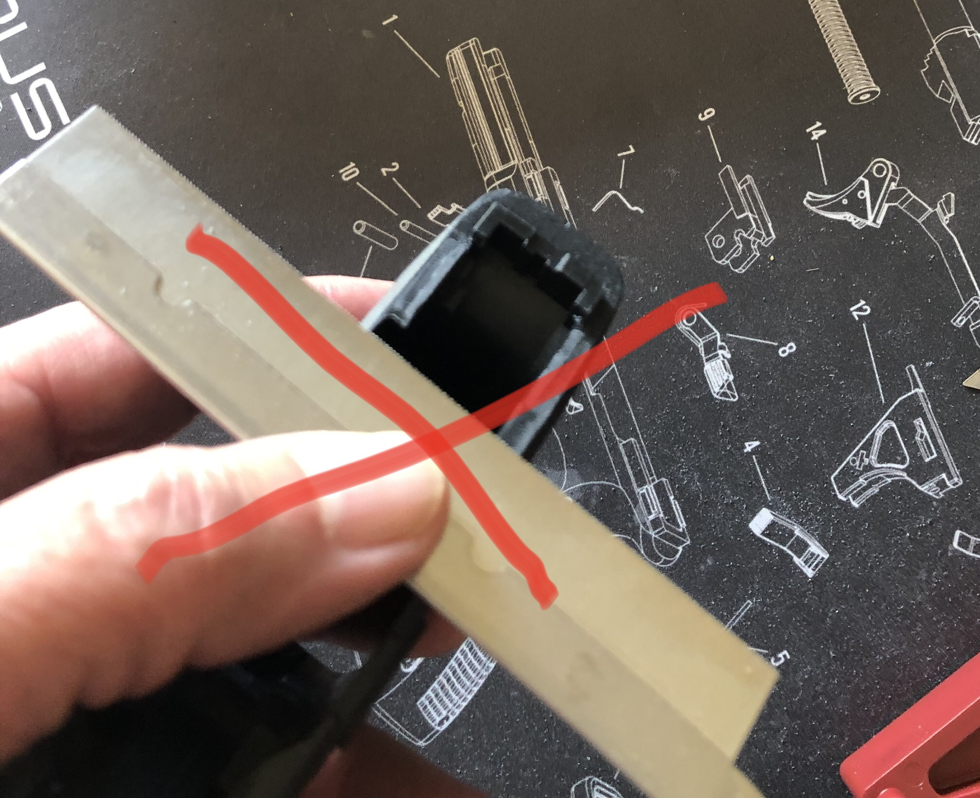

Do NOT cut the rear tabs using the saw at a 90 degree angle like this, as you will have issues. Use the lip of the top of the frame as a guide, sawing parallel with the length of the frame. Don’t do this:
