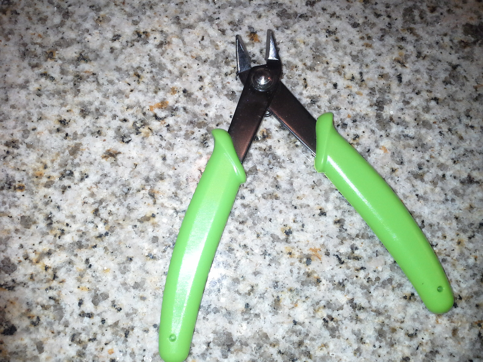

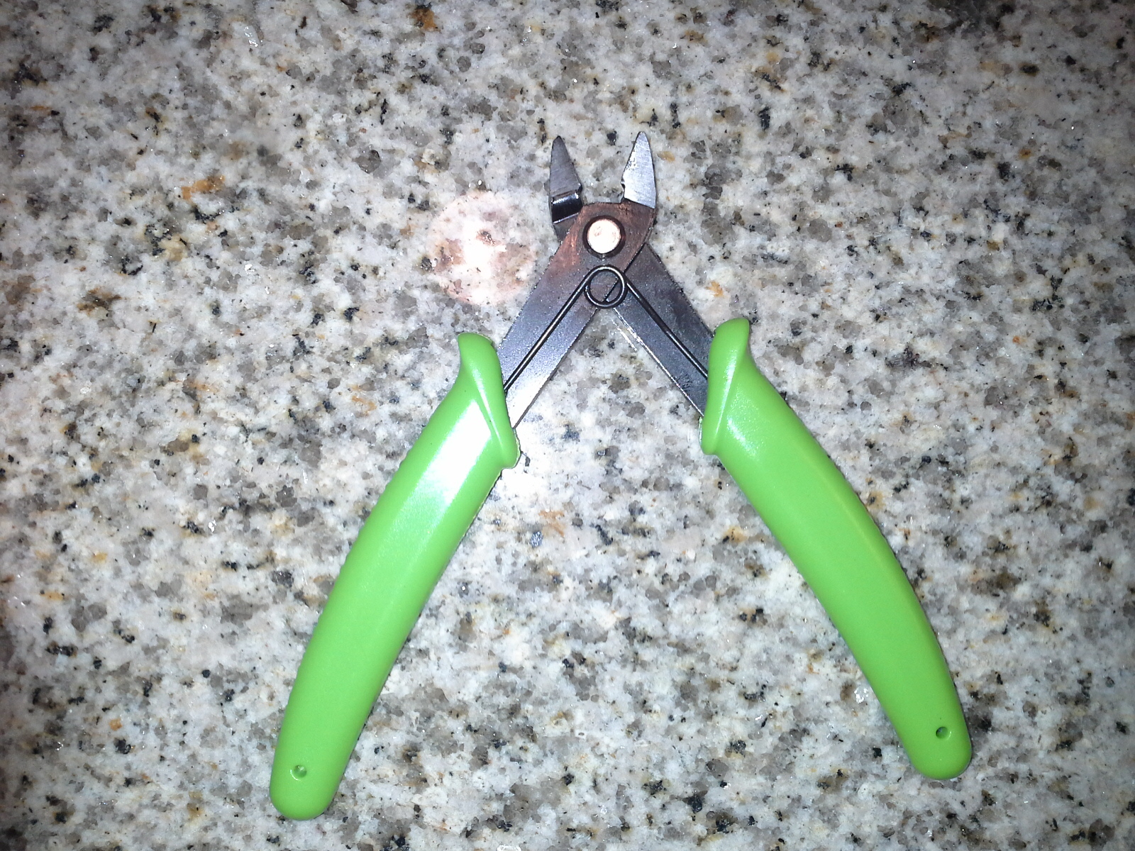

I found these little jewelry making cutters at Walmart. They are sharp, perfect size, easy to sharpen and remove tabs and the channel material cleanly. They are made for cutting necklace and earring wire, they cut polymer like soft cheddar cheese. Already had them, couldn't justify expense of fret cutters for two builds.

Nice! Sounds like they are much sharper than the harbor freight jobbies that are of the same size and design. Good find!

I think you are smart to skip the fret cutters. I got a pair and while they work, I found a sharp razor blade to do a better job on the tabs and allows for some channel removal too. Those jewerly cutters look an awful lot like the snips that came with my 3D printer. Maybe I'll need to give them a try on the next channel.

I have a pair of these I use for cutting off lead that is left on a jig after molding them. They hold up good under heavy pressure and are very sharp. I never thought to try them out cutting tabs. I still use the fret cutter, I just dont cut flush with rail. This way I have a whole tab I can use for melting onto the frame if needed for frame mods or fixes.

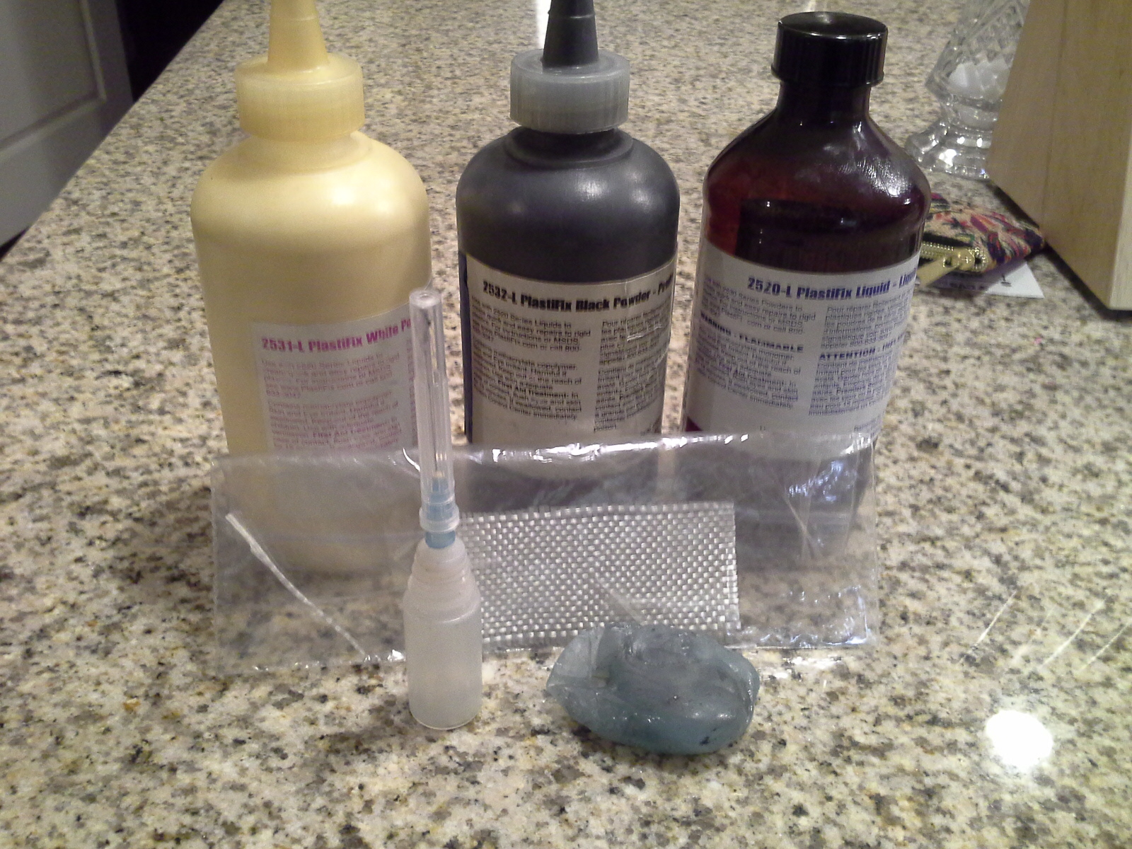

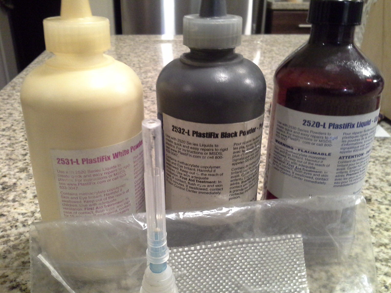

Hawkeye, your comment regarding frame repair material. I used to provide plastic welding with an airless plastic welder and chemical plastic repair services to car dealerships. I used a repair system made by Polyvance (formerly Urethane Supply Company) named PlastiFix. You can fabricate missing pieces, repair mis-drilled holes, etc solid as a rock. Structural repairs, I grind up fiberglas mat then mix with the plastic repair powder. Much stronger and sets up quicker than most epoxys. Professional kit after 25 years I still have workable materials (chemicals): the blue blob is a moulding bar.

Hawkeye, your comment regarding frame repair material. I used to order plastic welding and chemical repair services to car dealerships. I used a repair system made by Polyvance (formerly Urethane Supply Company) named PlastiFix. You can fabricate missing pieces, repair mis-drilled holes, etc solid as a rock. Structural repairs, I grind up fiberglas mat then mix with the plastic repair powder. Much stronger and sets up quicker than most epoxys. Professional kit after 25 years I still have workable materials (chemicals): the blue blob is a moulding bar.
