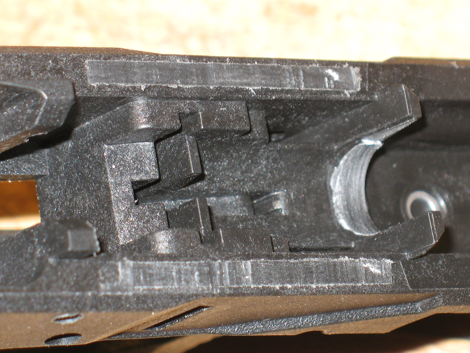

Gave the Dremel 650 bit a shot today. Very handy. Did a hybrid method. Since I've got fret cutters I took about 80% of the tabs off with them, then used the 650 bit to trim it almost flush. Should only need some light emery board work to smooth it out.
My work with the 650 bit is a bit sloppy being the first time I ever used one. I can see getting it more uniform with practice. Definitely a useful bit. I may do the entire tab w/the 650 next time just to get more practice w/it.
When you get down to close to finish, go to high speed, a light touch, and you will have very little hand sanding/touchup.

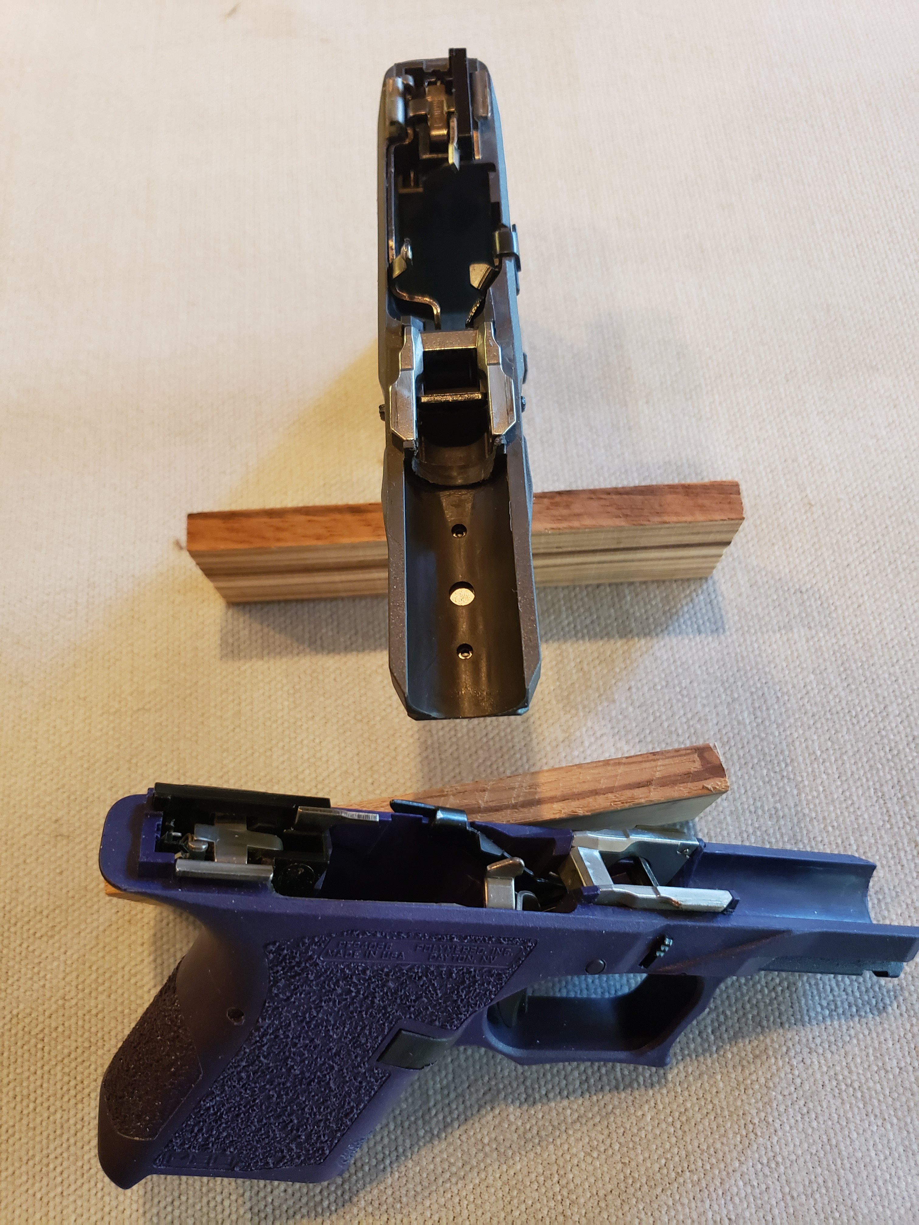

Just leave the frame in the jig and score/cut the tabs off using the top of the jig as a guide. Very little clean up needed and it only takes about 10 minutes. Rails look like this with little clean up.View attachment 2283

Been using this bit to bevel the forend on M1's for years. Turns out, it does a nice job on the P80 tabs too.
Set the speed fairly high to prevent chatter. Buzz off 90% of the tab, and then slow down and get deliberate. Take very slow, light cuts. For the final passes, let the smooth portion of the cutter shank ride on the plastic jig. You will be left with very little file/sandpaper work to finish.
Unlike the sanding drum, you can get right up in the corners and it doesn't clog with melted plastic either.
After cutting, before filing/sanding.
