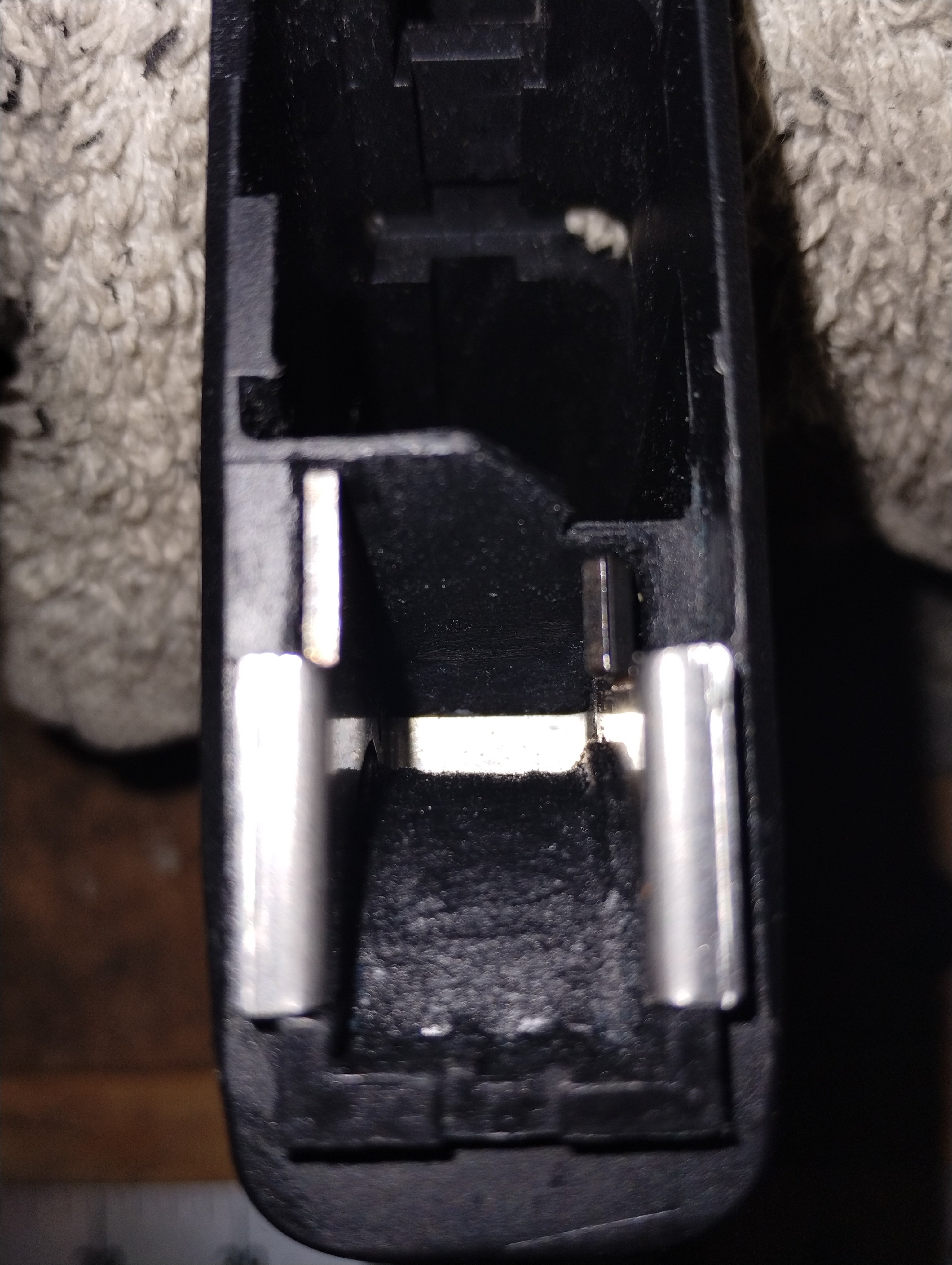

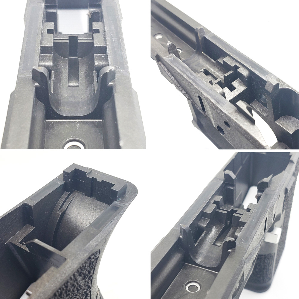

For the life of me, I can't figure out why P80 made the trigger pocket so hard to clear out. It is impossible to remove all those fins/sprue without compromising the frame. Meaning... the walls of the frame become too thin. Seems to me one obstruction would have satisfied the new rules/regs. Or to provide a means of 'snapping' those fins out with pliers and finishing with a burr would have been better.
These P80 bridge frames are a joke. Total film flam. Even when you put in all the time and patience to carefully prepare the frame, you are left with a bodged piece of junk. The barrier between the mag well and trigger pocket is rather thin even on a finished factory gun. The frame is also rather thin around the curve of the beavertail.
Even under the best of circumstances and performed by skilled hands, the P80 76% frame isn't worth the time and effort. I dislike having to buy a serialized frame thru the FFL process for a DIY project, but the alternative - which results in a piece of shit - isn't better. Might as well make a zip gun out of a stapler.

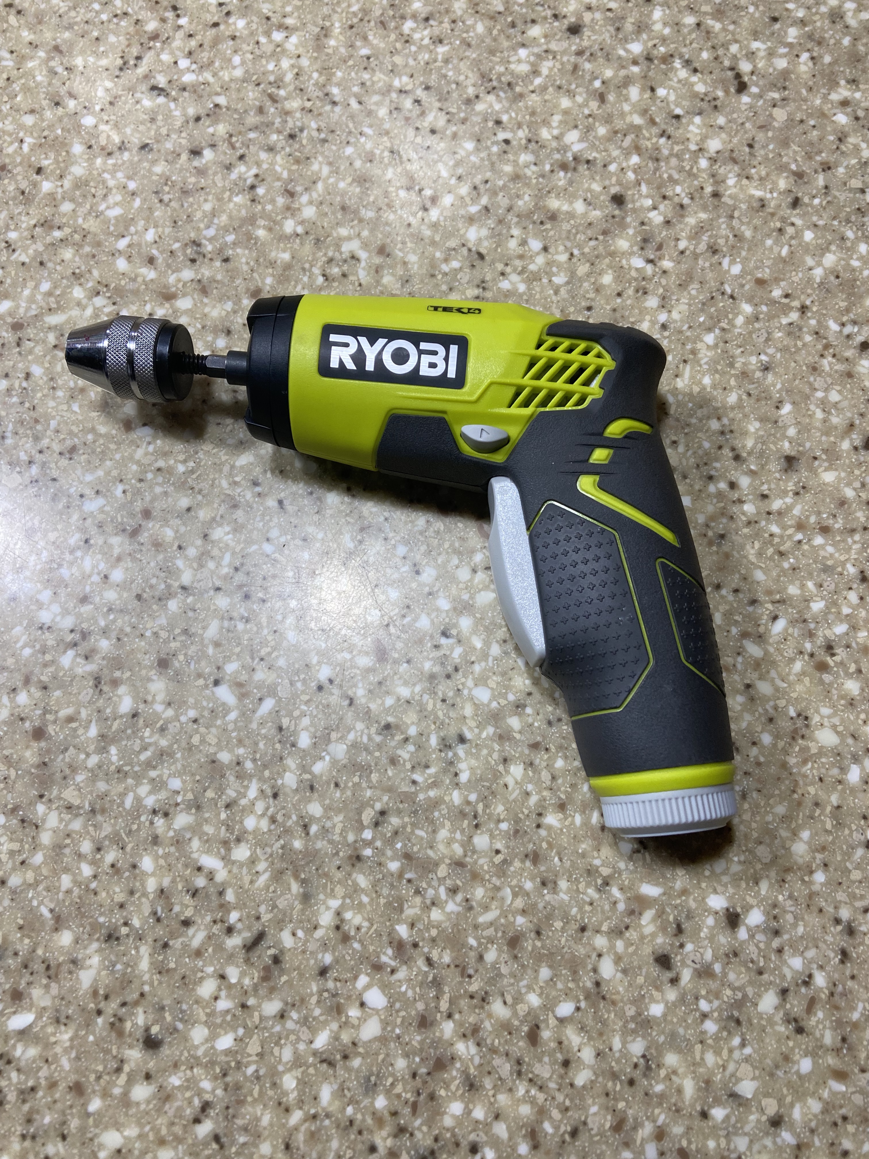

3) New tools I'm going to try:

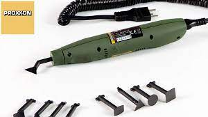

Micro Sander- This is a knock of of the Micro Mark power sander...cuz Im a miser :LOL: too cheap to spend the money on M.Mark. Takes forever to get to USA from chiiiiina
View attachment 9739 View attachment 9740

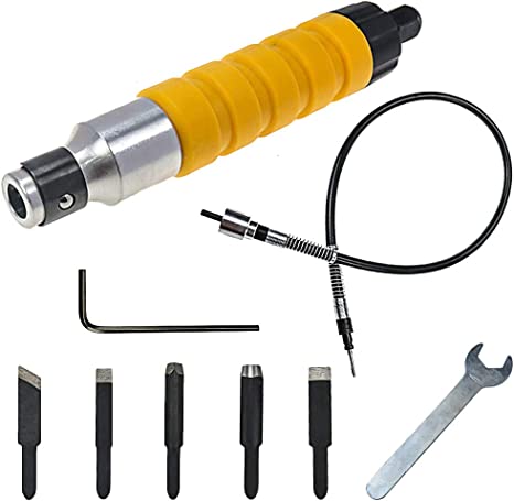

Electric wood carving chisel - another piece of cheap china junk. I returned the 1st one it was bound/frozen and wouldn't work. Getting another today. Only good thing I have to say about this tool is it's a one day ship. Hoping this next one works. Does not work with the Dremel as the fitting is too large. Chuck it up in a drill.
View attachment 9741View attachment 9746
This chisel tool oscillates. Im hoping the vibration will cut through the polymer. There are 2 flat blades the small one fits nicely in the pockets the large at the rear rail area.
View attachment 9743View attachment 9744View attachment 9745
Ill post up more as I get on this. 🎉

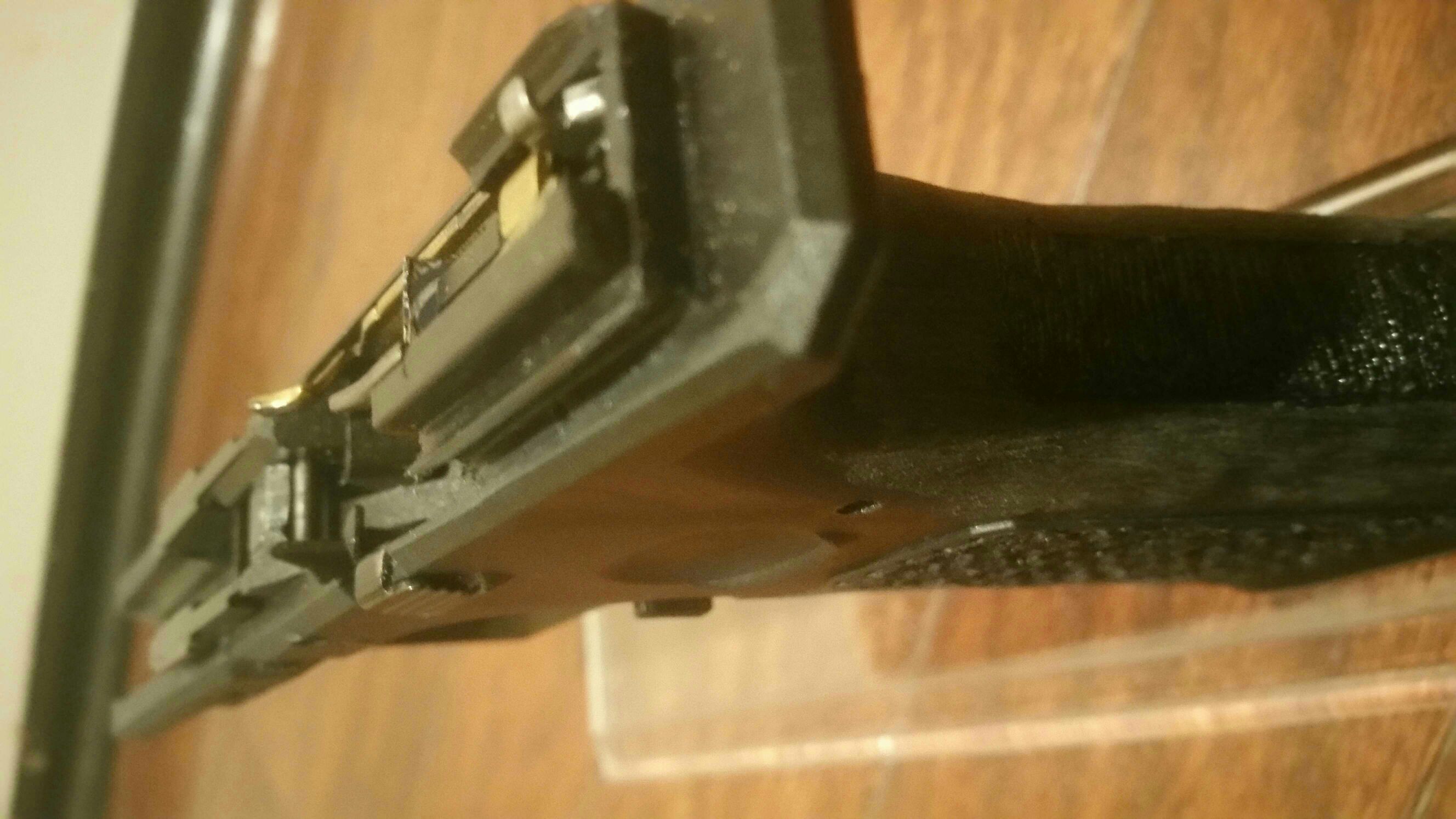

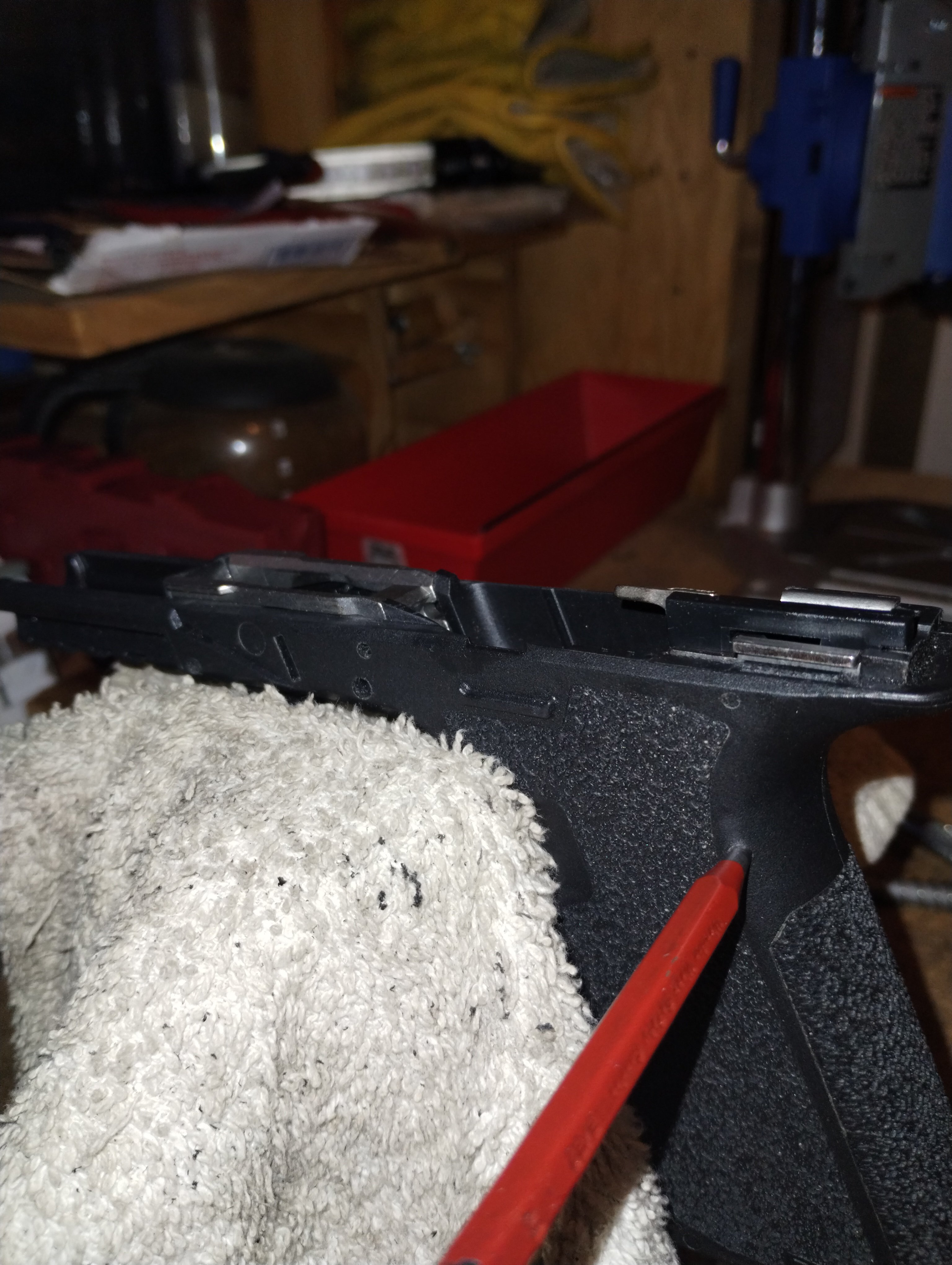

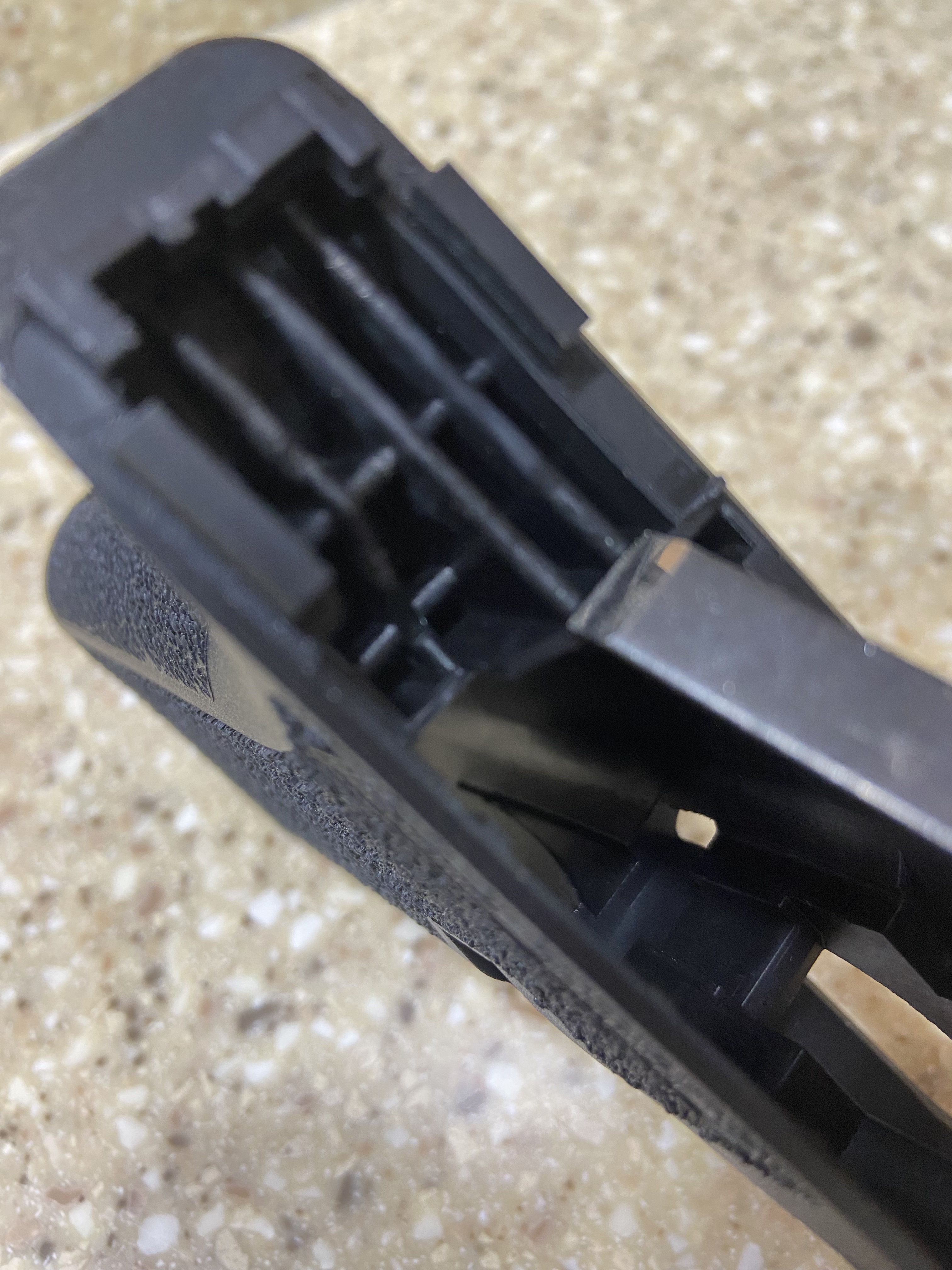

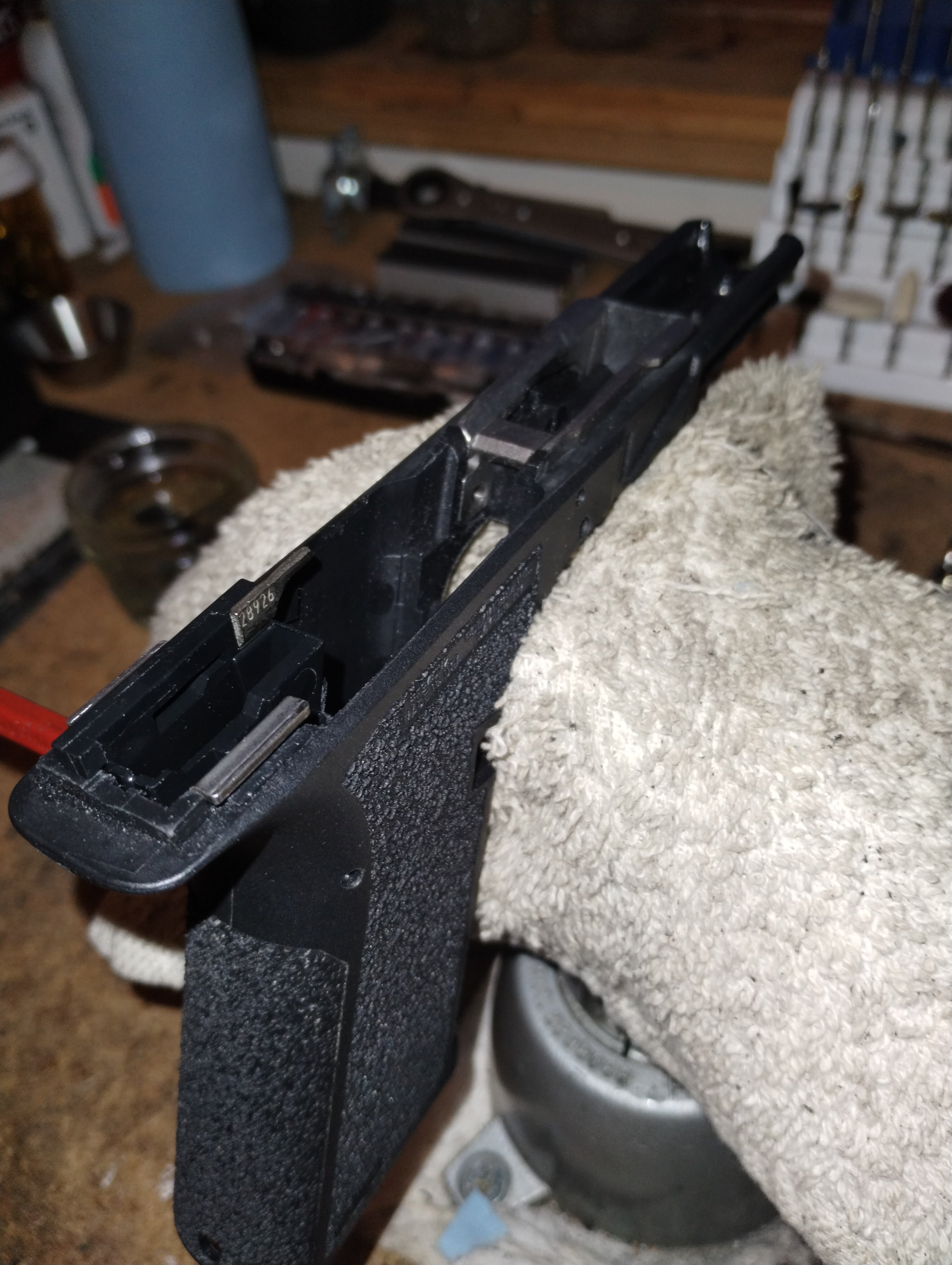

Here is a few pics of my new 76% frame with rails and trigger housing fitted. I think if you use a jewelers saw and take your time you can cut out the bridging without to much damage to the frame. All the pin holes are drilled and lining up properly as well. I use an old frame and marked the front hole from another frame.

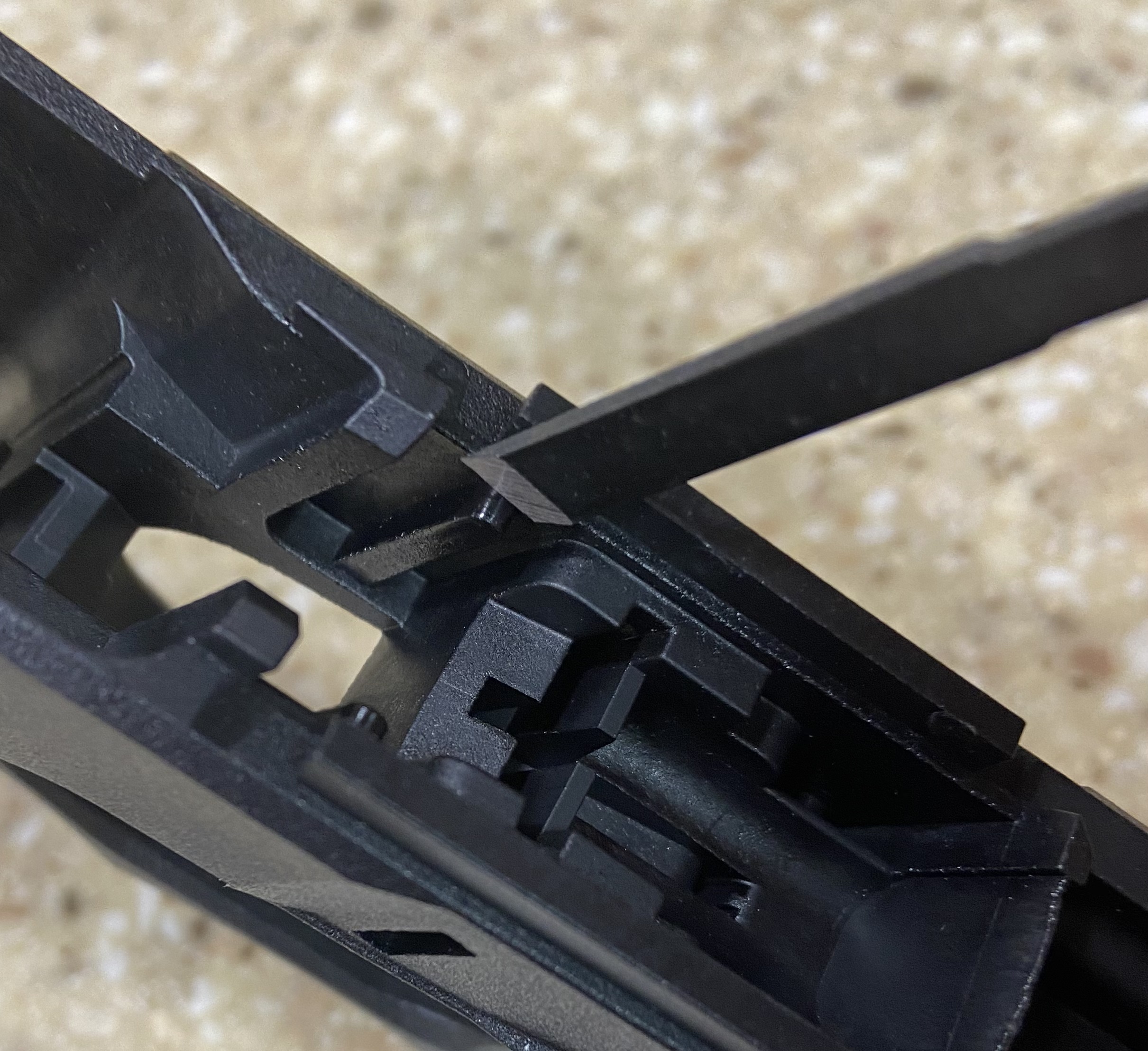

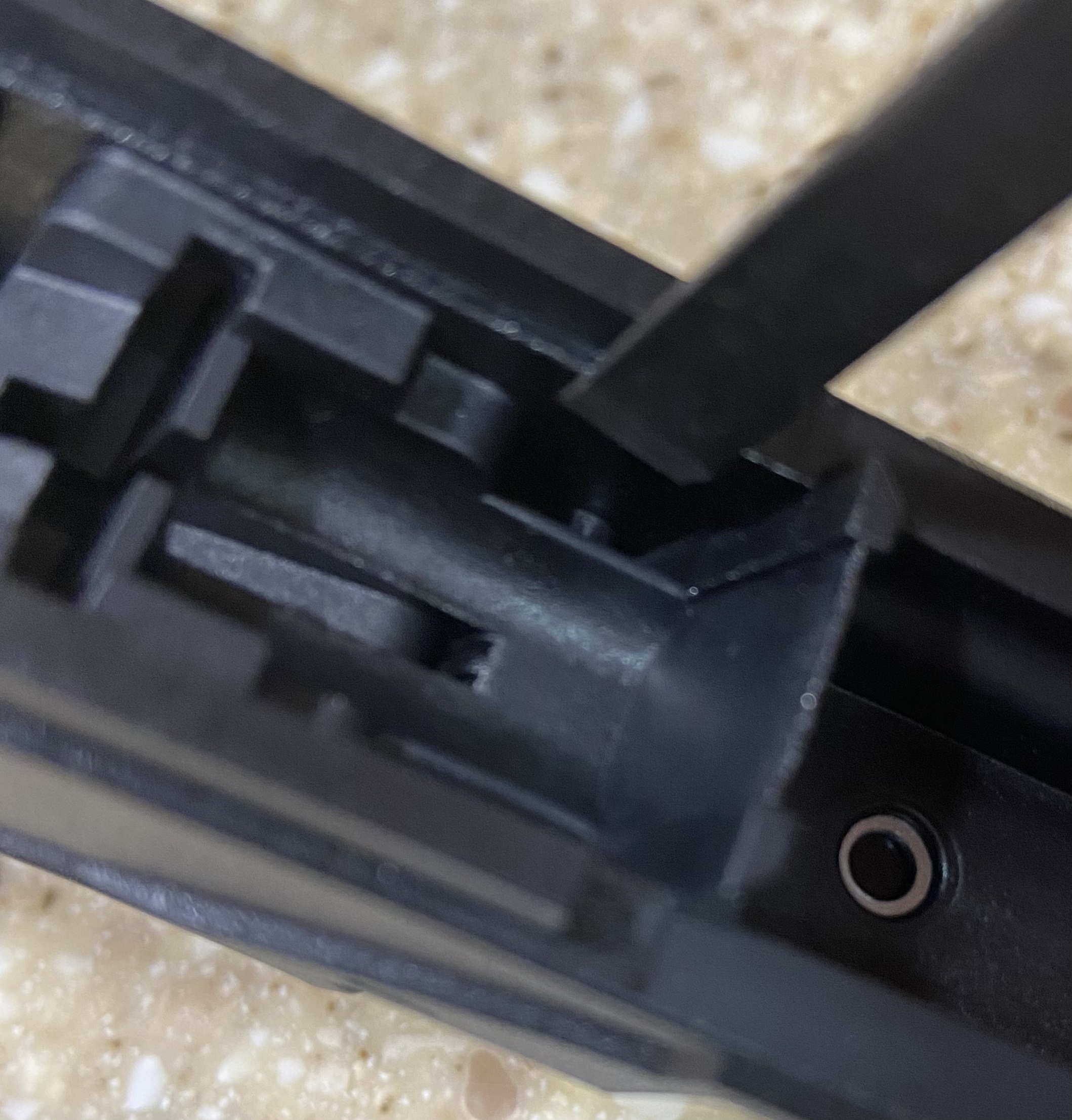

I recommend that you cut the bridging along the magazine wall first before you try and clip any material away with nippers.
You did a nice job on that. You are a better man than I, Gunga Din! Certainly more patient.

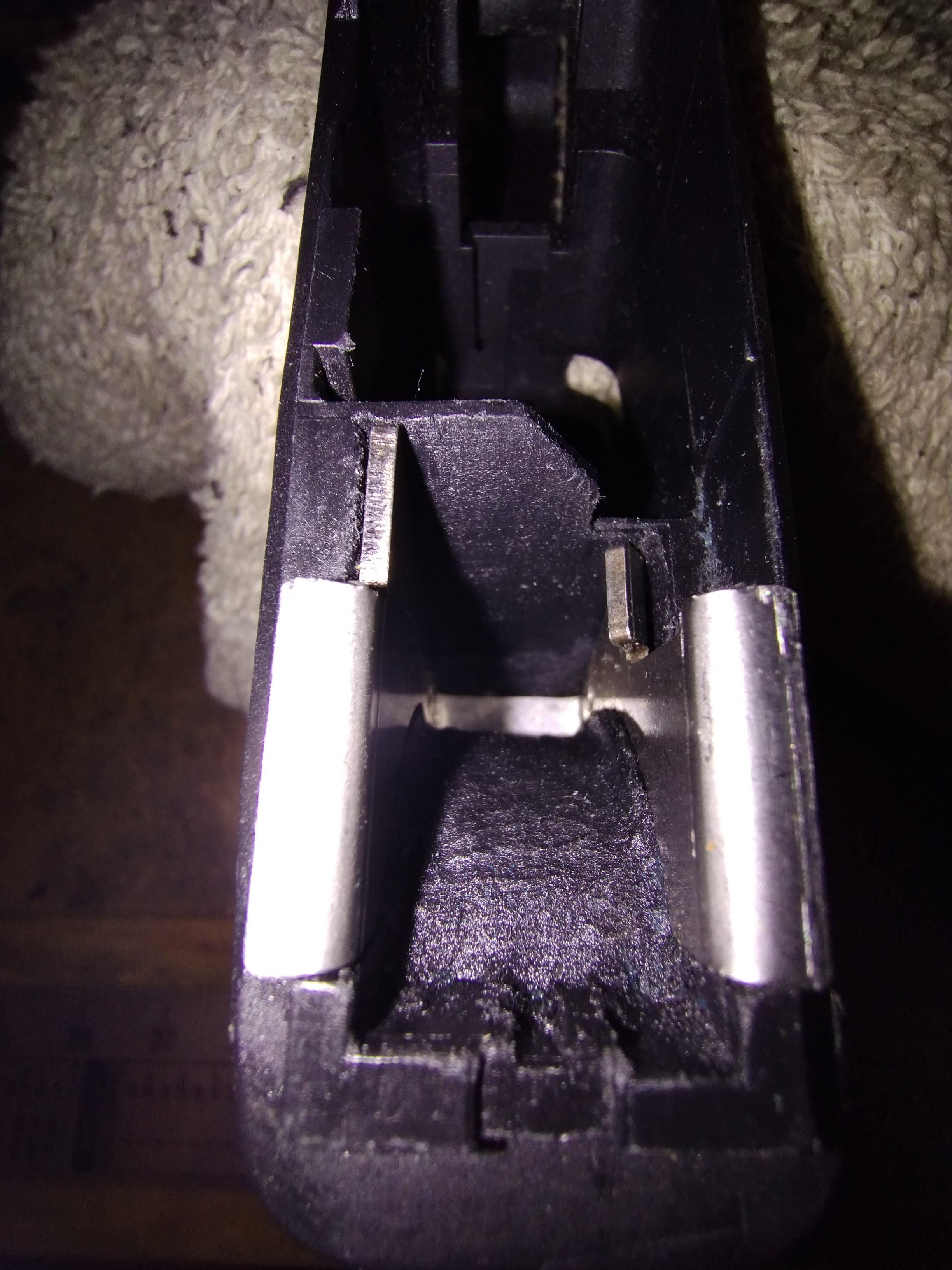

The bridge frame isn’t all that bad. The front block area is a non issue and easily cleaned up.
The trigger housing upper section isn’t all that difficult either however before doing any work protect the surrounding frame edges so it won’t get damaged while tooling.
The hardest part is the lowest area of the TH below the curve due to a small space and difficulty lighting while working in there.
Seems a few peeps have some decent looking builds going on. If taken the time to clean out the TH with care it can be made into a fine weapon the operates as designed to.

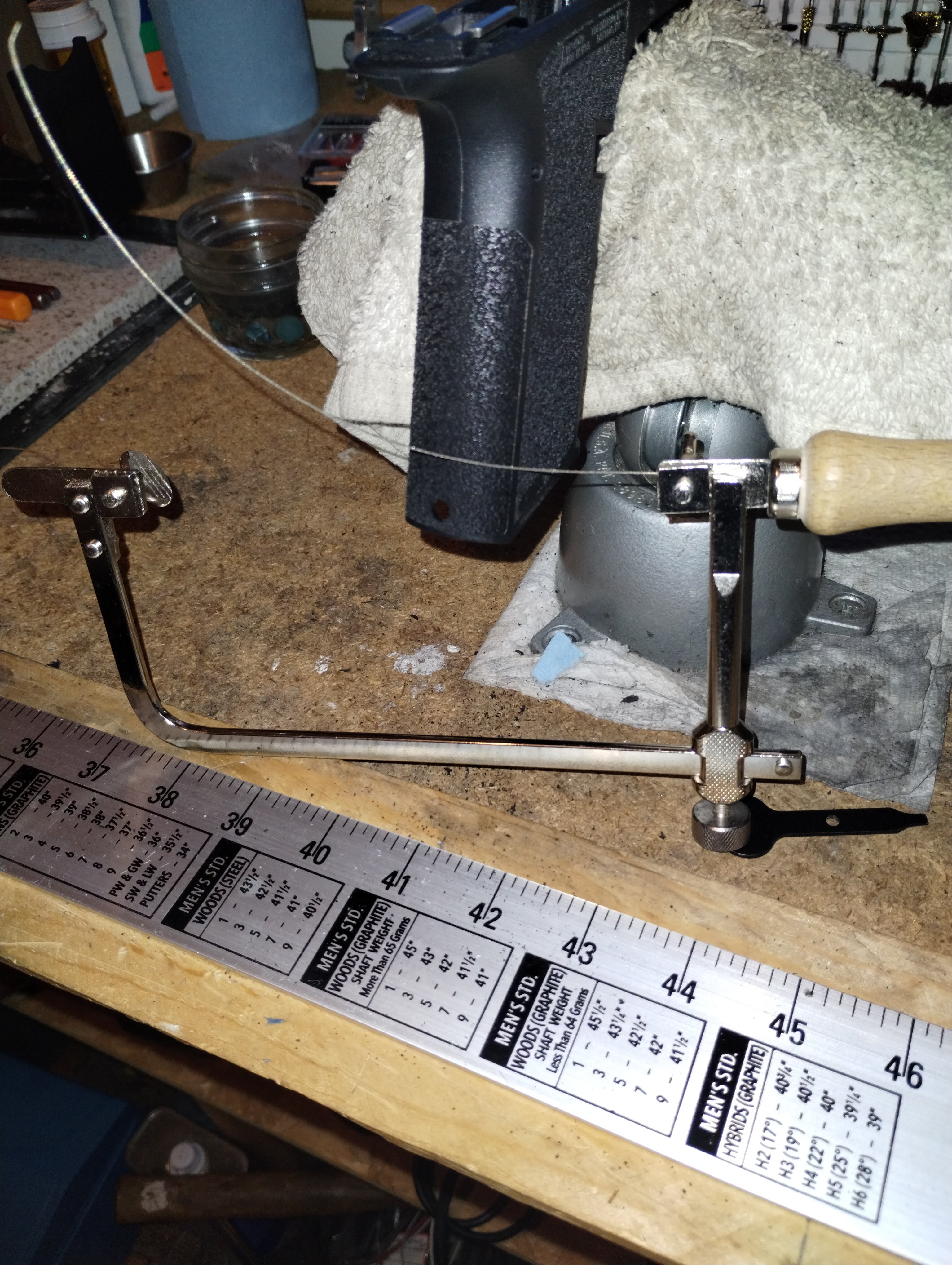

Here is a few pics of my new 76% frame with rails and trigger housing fitted. I think if you use a jewelers saw and take your time you can cut out the bridging without too much damage to the frame. All the pin holes are drilled and lining up properly as well. I use an old frame and marked the front hole from another frame.
Very nice sir ! A ha …a coping saw. Great choice of tool. Perfect to get down into that lower grid work and cut any flat areas of the TH as well. I’ll be adding that to our tool list thank you sir.

Very nice sir ! A ha …a coping saw. Great choice of tool. Perfect to jet down into that lower grid work and cut any flat areas of the TH as well. I’ll be adding that to our tool list thank you sir.
