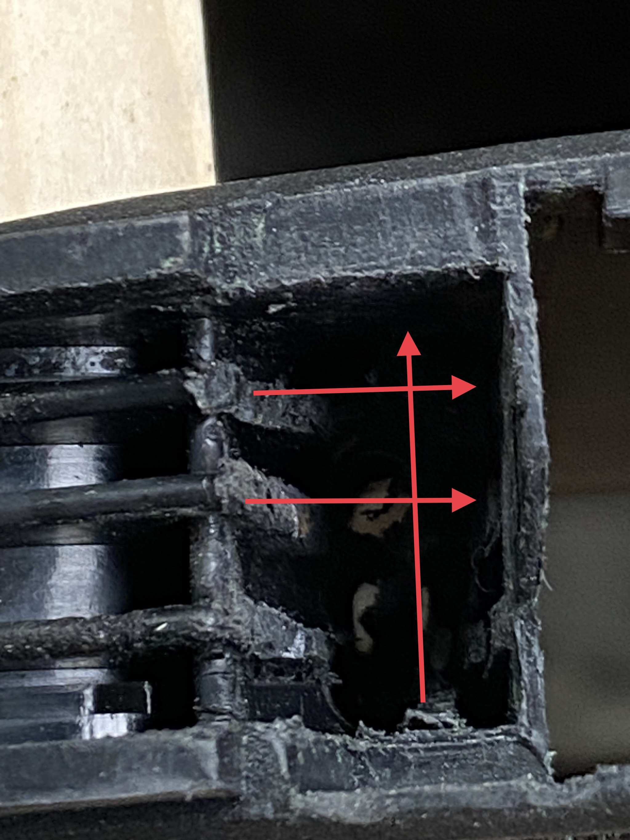

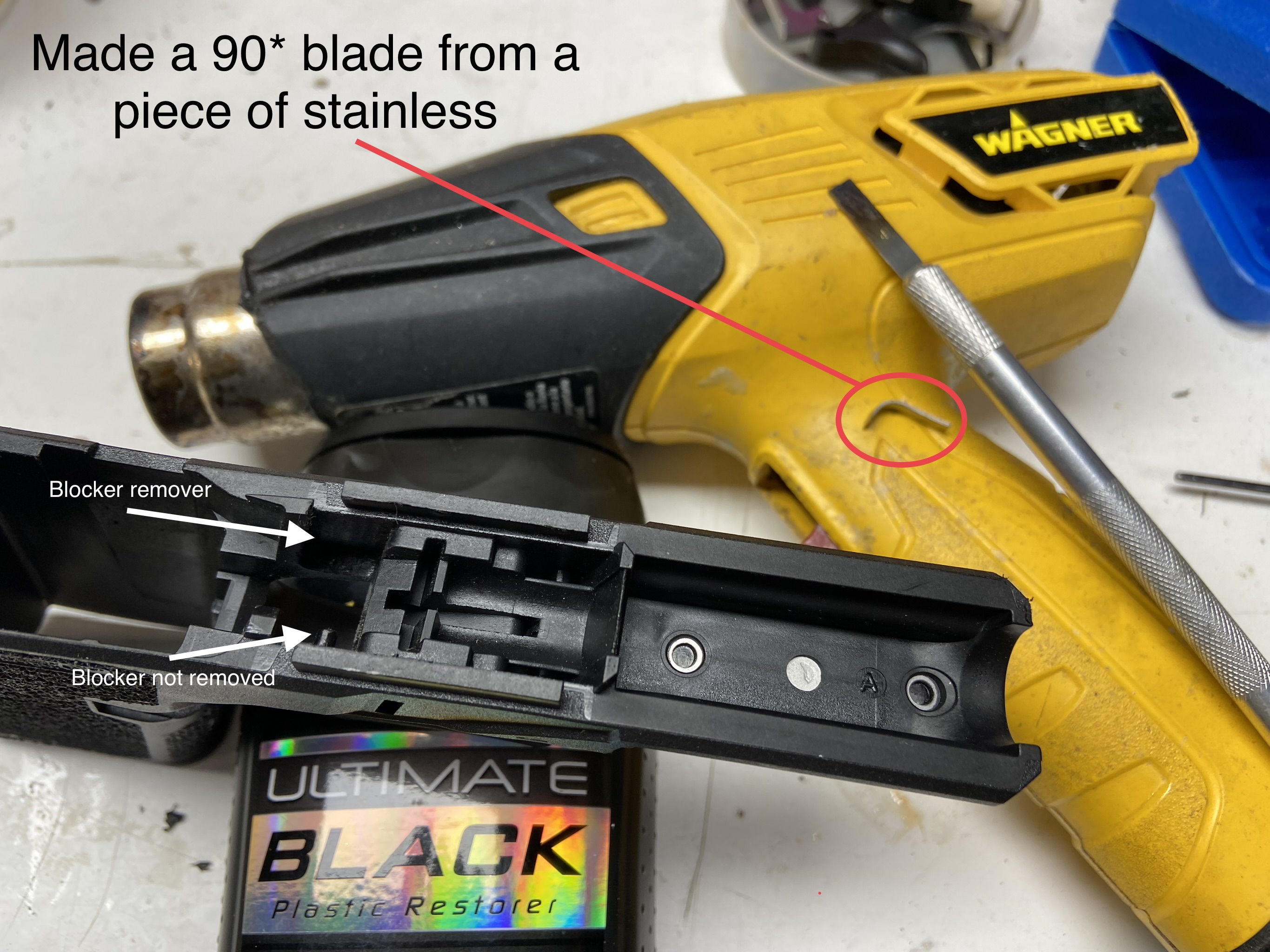

What tool(s) did you use to remove the obstructions

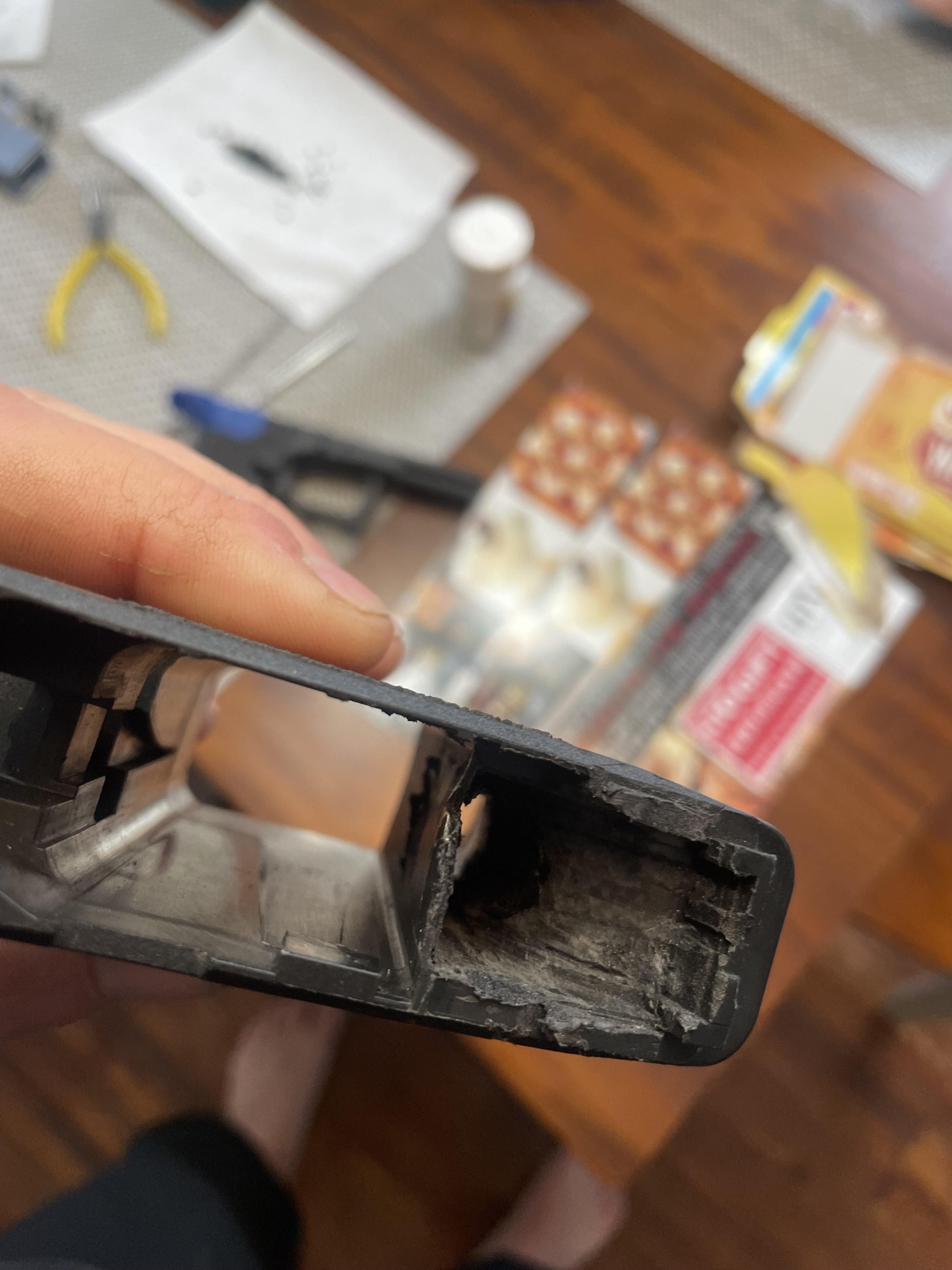

Ok the china junk has shown it’s colors. The key that operates the mechanical parts turning them is nearly worn to nothing after about 20 minutes of jack hammering the fins. It quit on me. So… that’s a definite no go. That cheapo $20 tool is on its way back. Can’t expect much for $20 I guess. However, I’m not giving up on this technique. What little bit I have done I’m fairly happy with.

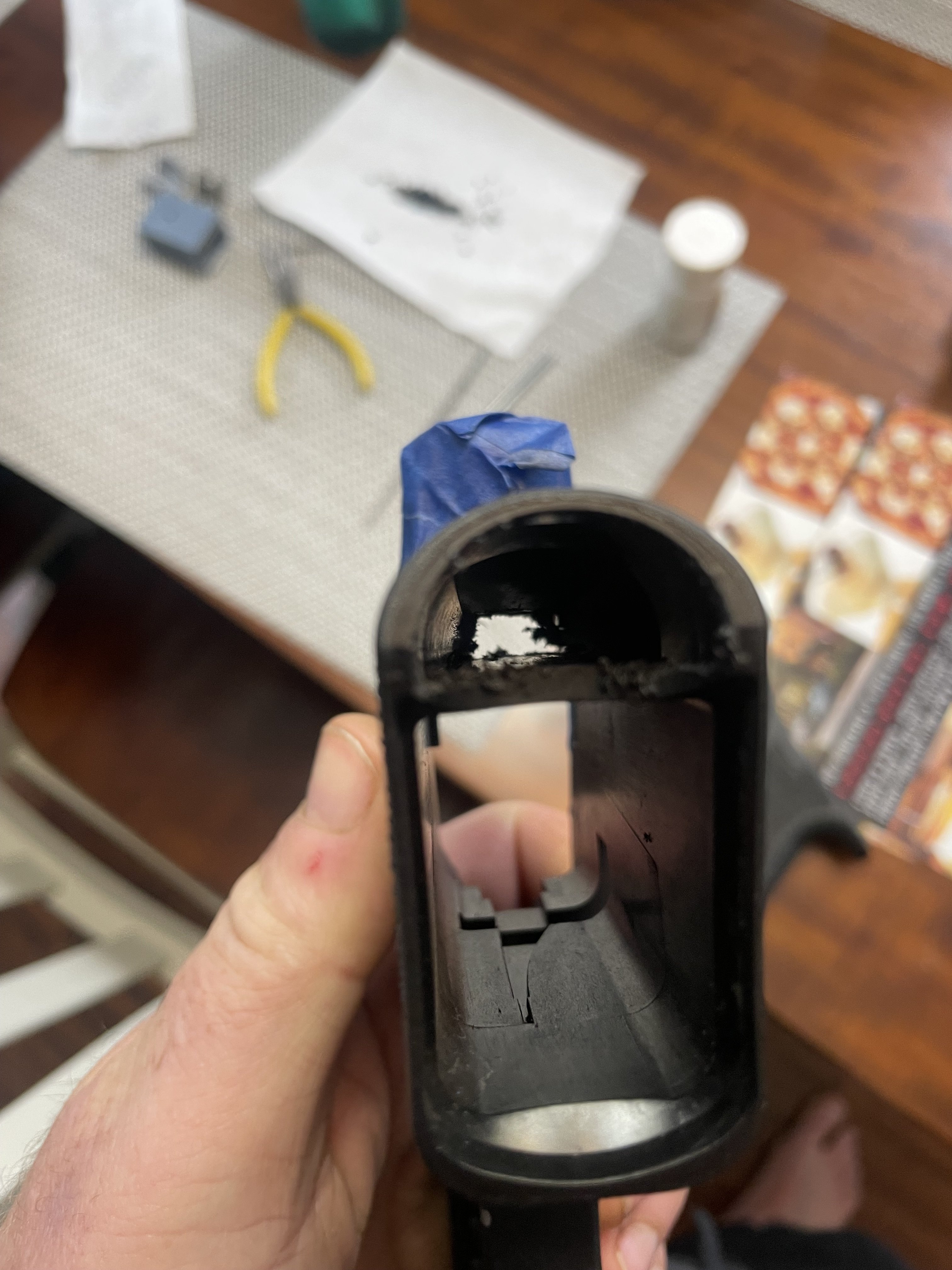

This is a work in progress…it’s still pretty rough looking & can all be polished up. (NOTE: don’t go running over to Reddit to post my unfinished rat eaten work. 😂 You know who you cross poster are 😝) The flat carver did a pretty good job of removing the fins flush at the areas identified by the arrows. The tool heats up a tad due to friction So polymer is easily shaved. This pocket is small with the front wall angled, it’s pretty thin and easily damaged if not cautious.
Think I’ll use the MGBs recommended cutters to get most of the rest of the meat out. Then try out my new Ryobi carving tool👈(amazon link) I just got at Home Depot. I’ll update on this tool

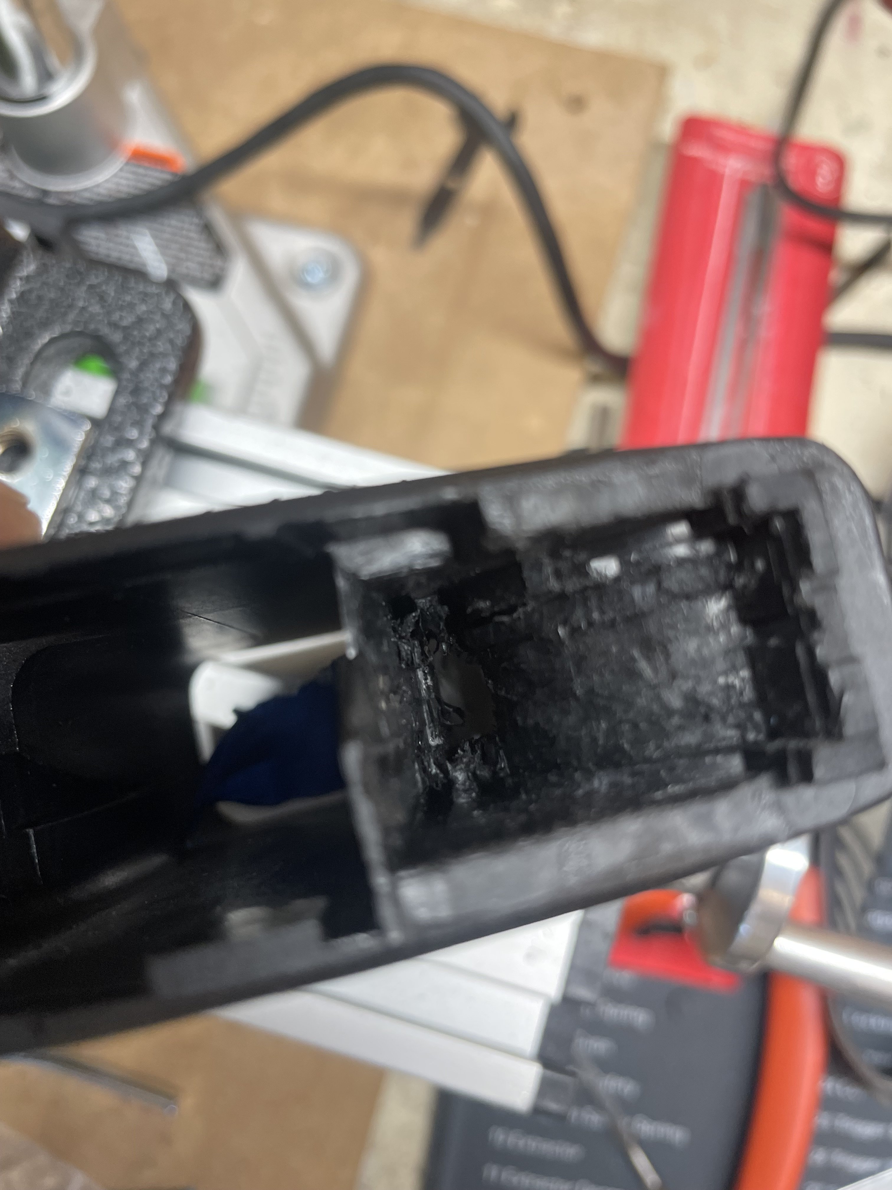

The Ryobi Carver was somewhat effective, but only after I spent a couple of hours sharpening the chisel blade. It requires a bit more eye/hand coordination than the complimentary Ryobi Rotary Tool, which uses the same batteries.
The Ryobi Rotary tool was overall the most controllable and efficient tool I tried. Cutting as much as possible with nippers then finishing with the Ryobi Rotary seemed to be the right combination. The Ryobi makes quick work of nicely removing the 'tabs' on the 80% frames, so even though I will definitely not do another 76'er, the Ryobi tools were not a waste of money.
I ended up using both the Ryobi tools. The sharpened chisel was especially good for removing what the rotary tool left behind. Making the surface a bit smoother. As I have mentioned in other posts the time and effort involved with preparing the 76% frames was not worth it to me. The net result - a completed frame - just isn't up to my standards.
My only beef with either of the Ryobi tools is the battery life, but I bought extras. The chuck is a little flaky... cheaply made, but not much different from a Dremel. Both are pretty useful tools to have around.

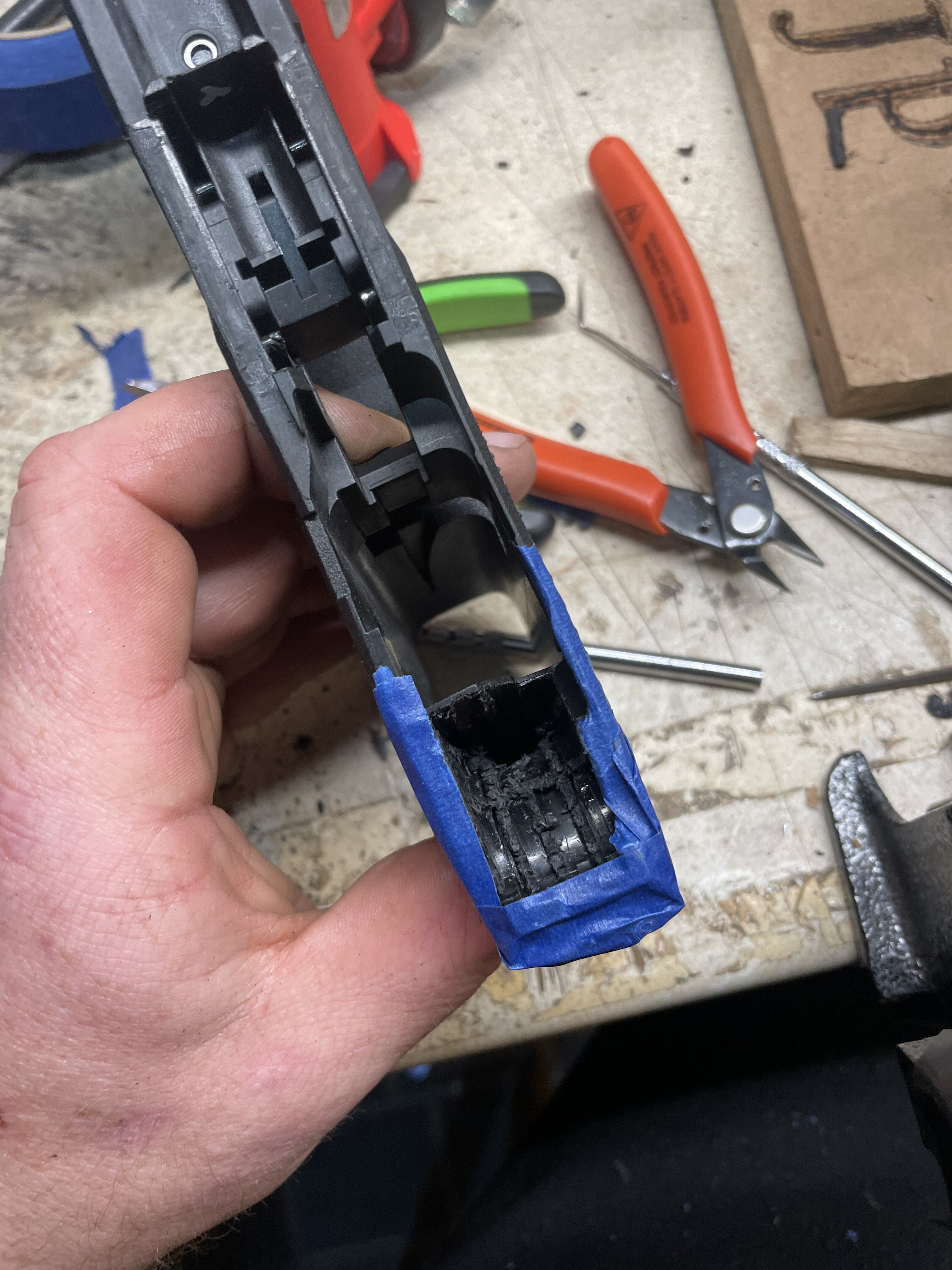

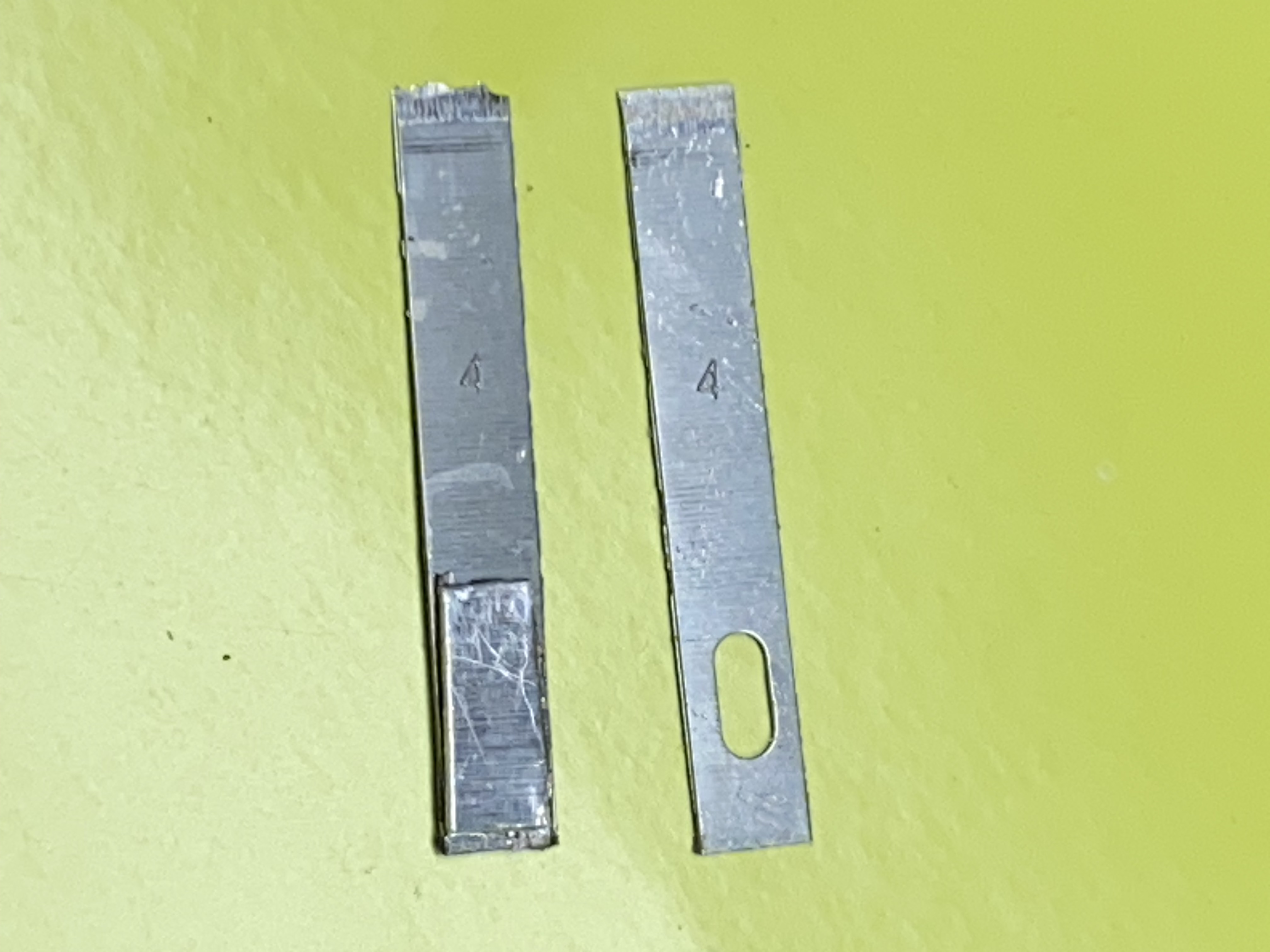

Yes sir. It was very effective in making vertical cuts. Did not use blades it came with, too big, use xacto chisel blade. Nice smooth cut. Used it along with diy hot knife for front block came out FTQ.

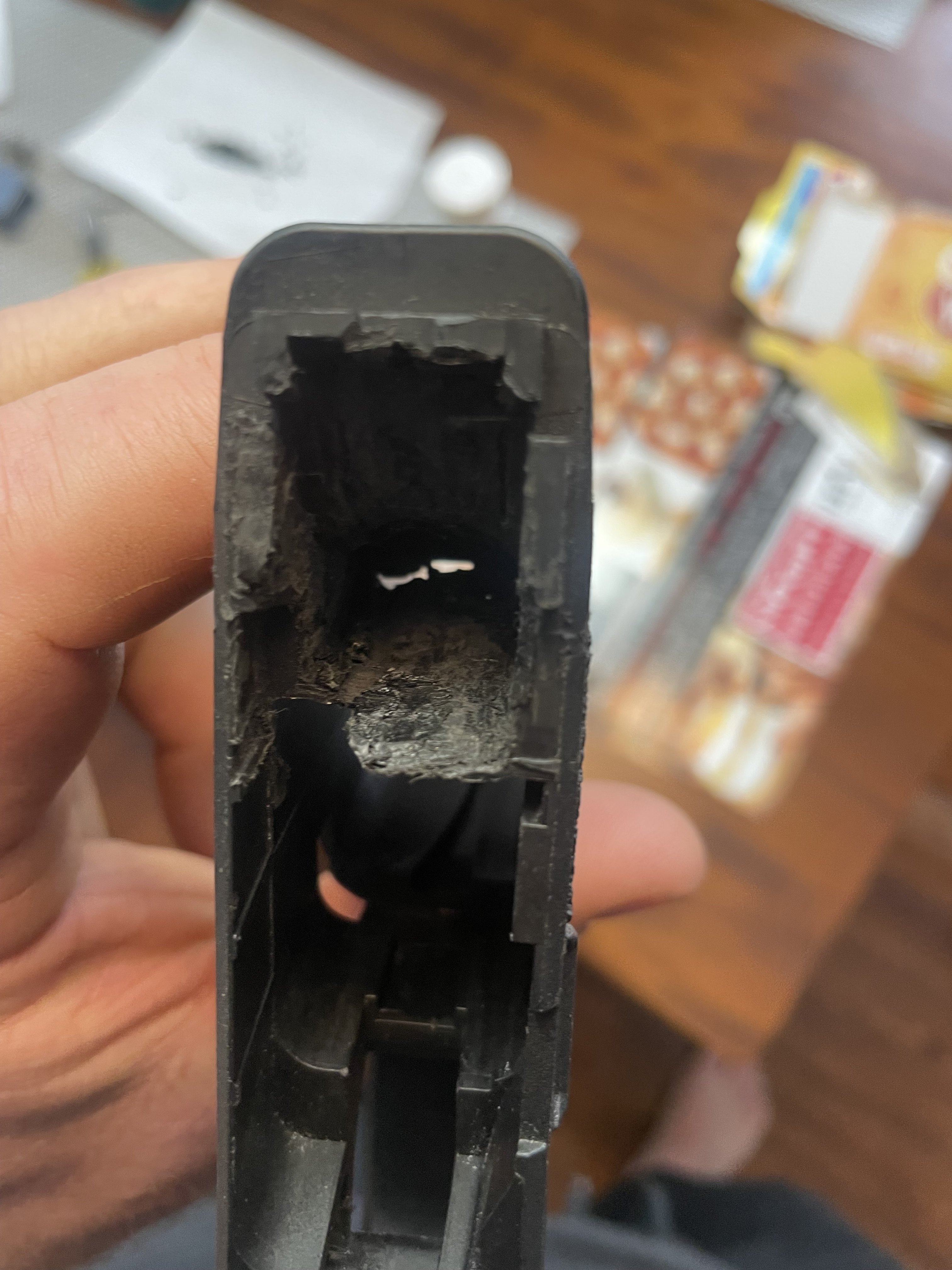

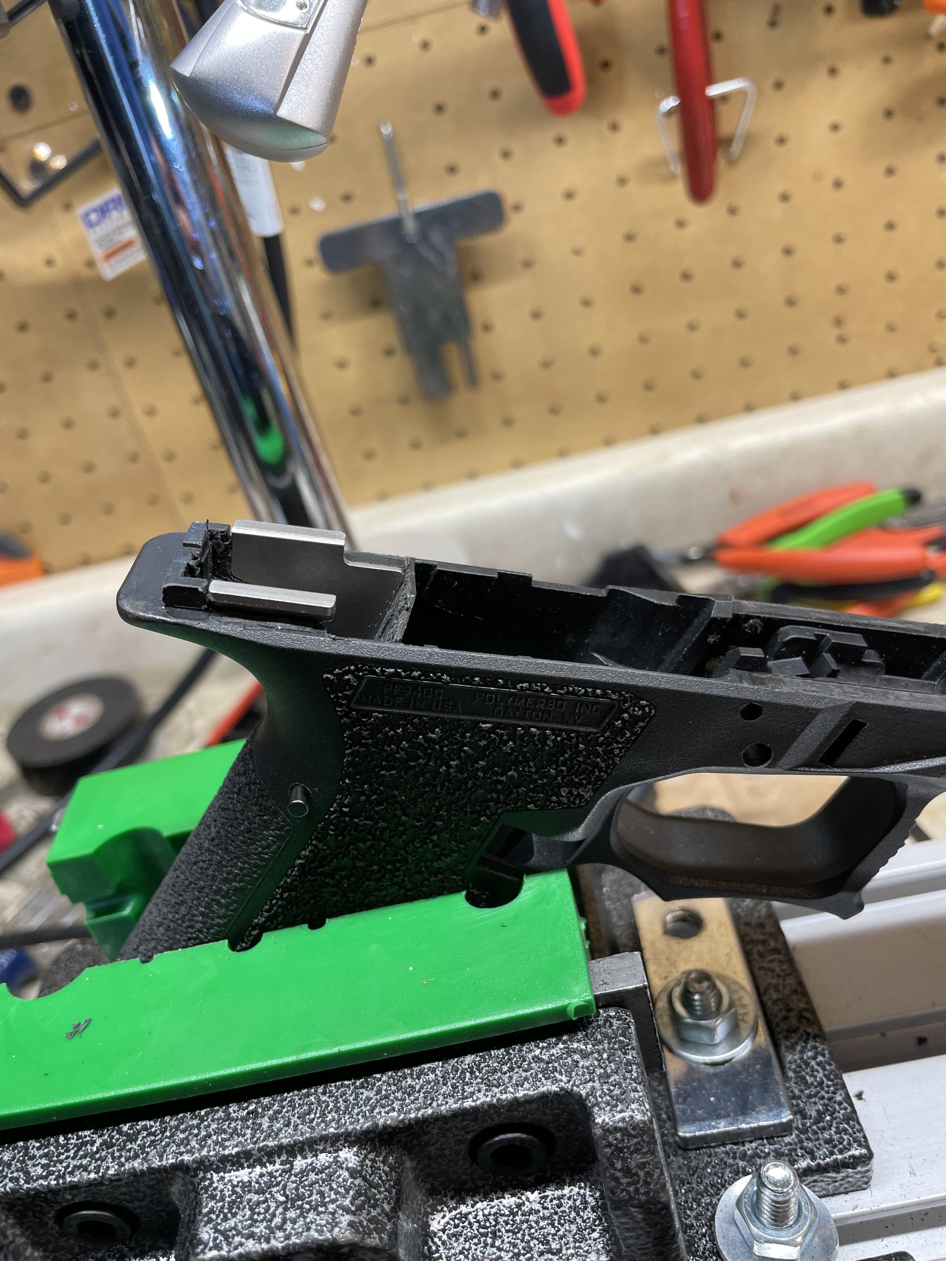

I really wasn’t pleased with the rear rail area of either. However, the rail fits as it should although it’s not pretty.
Here’s my second frame. Came out better but not what I’d call FTQ

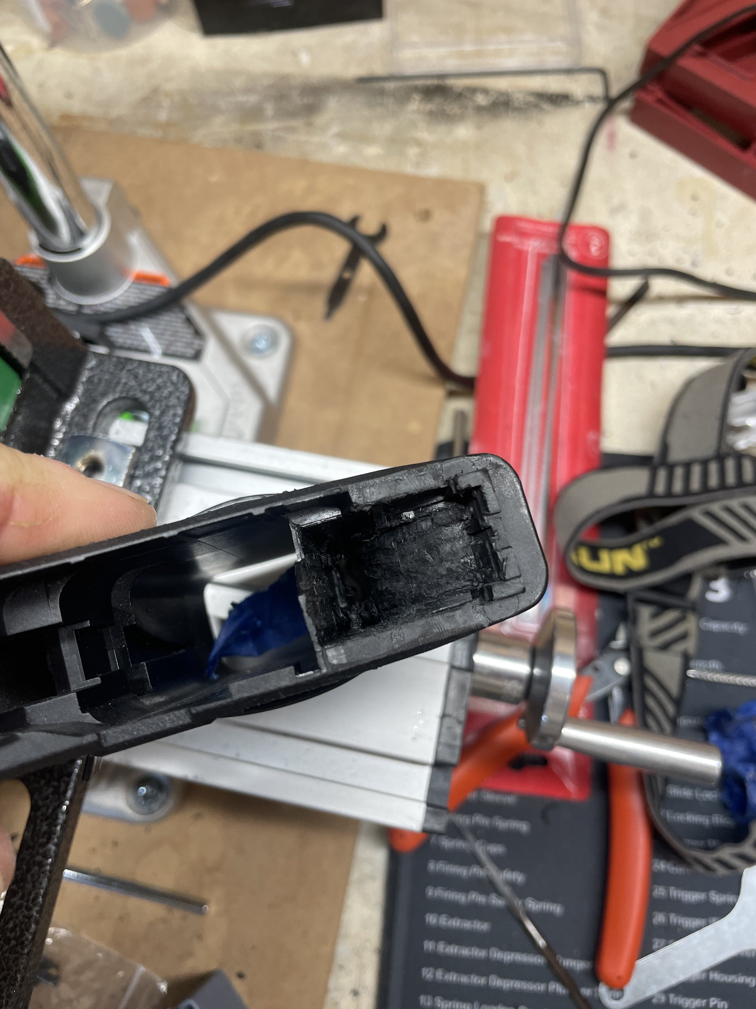

I recommend that you cut the bridging along the magazine wall first before you try and clip any material away with nippers

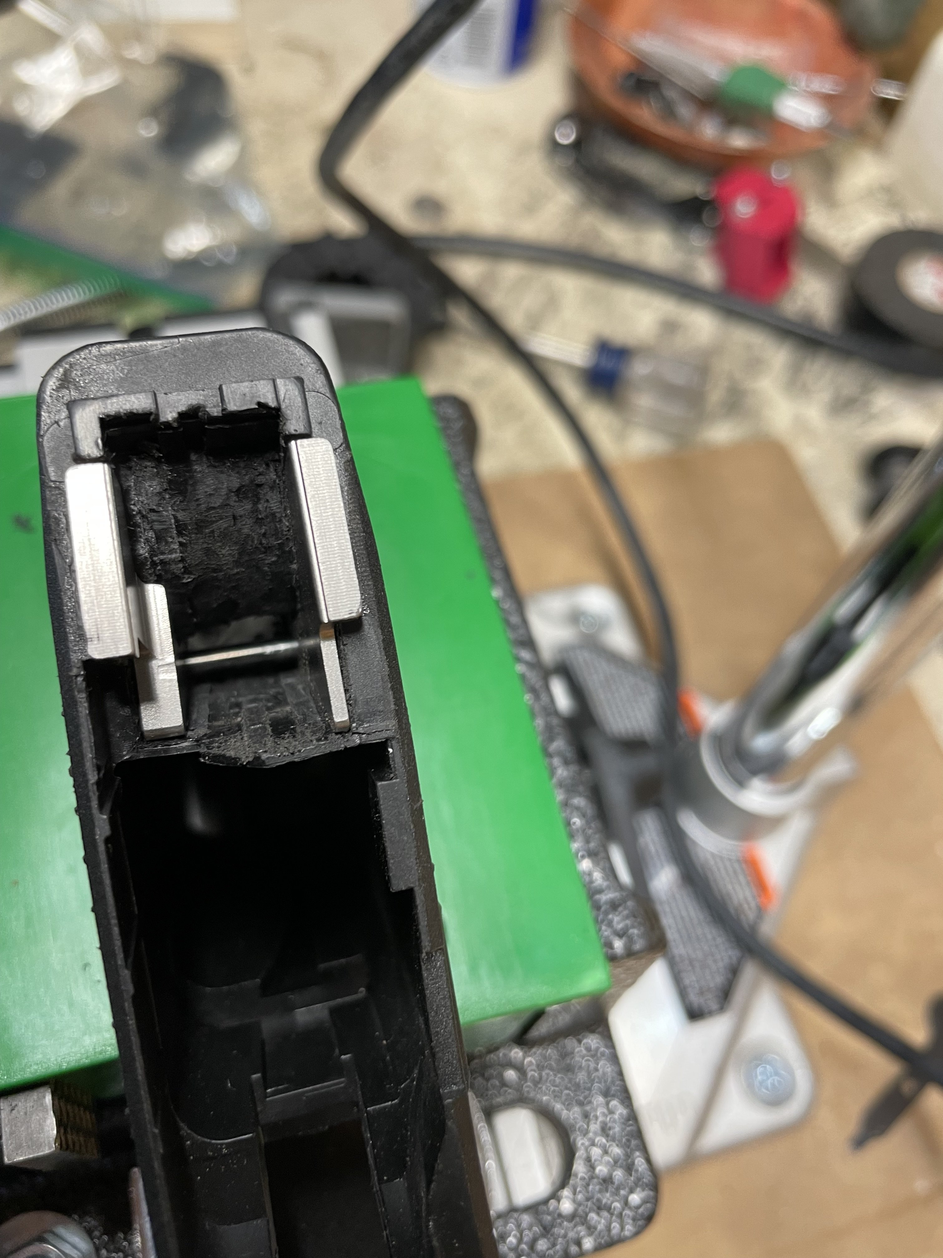

First time posting and recently new member… I second this^^^^ after cutting thru the mag well wall on my first attempt I used a coping saw to cut out the middle sections of the polymer. It was hard to get the saw blade down thru. Had to actually remove the tab the holds the saw blade In place then re attach it. Definitely recommend putting tape or something down, it helps to let you know when you are tearing up the walls. I still have to go in with the dremel and flatten sand everything out. But off to a better start compared to the first time. (Frame with the tape is my second attempt,obviously)
Looks like you're on your way to a good result! I'm sure you'd agree that taking your time is a big factor.

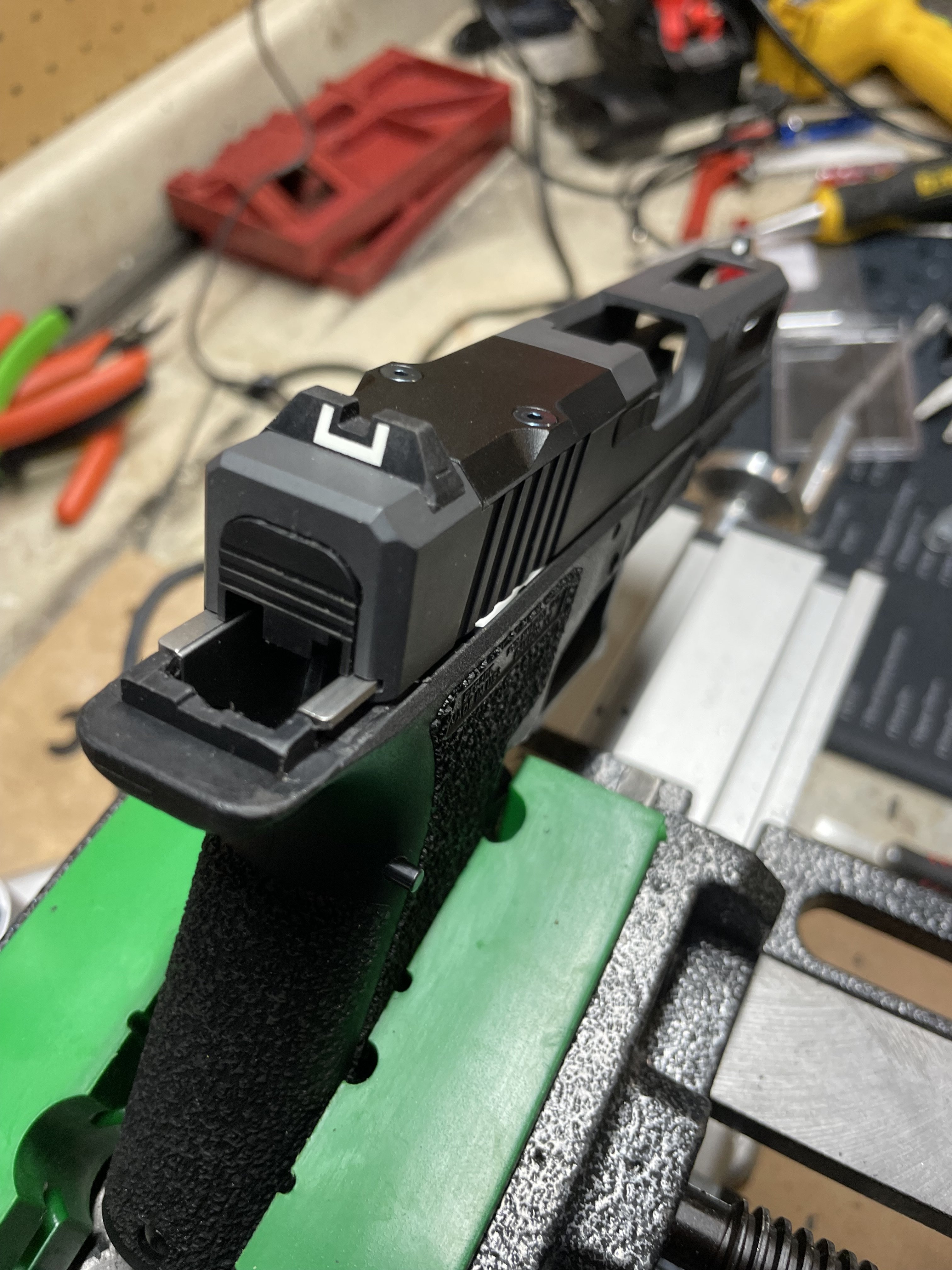

Little update. Was just able to get my rear rails in. Using rook tactical rails is a huge benefit compared to normal ones. You done have to clean out as much. Once you get the middle section out with the coping saw blade all you have to do is use a 1/4 chisel and go straight down the sides. Obviously need to clean up a bunch and make it look FTQ but this method was way easier compared to using a dremel. I will use the dremel on the top to clean everything up and polish but I don’t think I will be going down into the “throat”.
