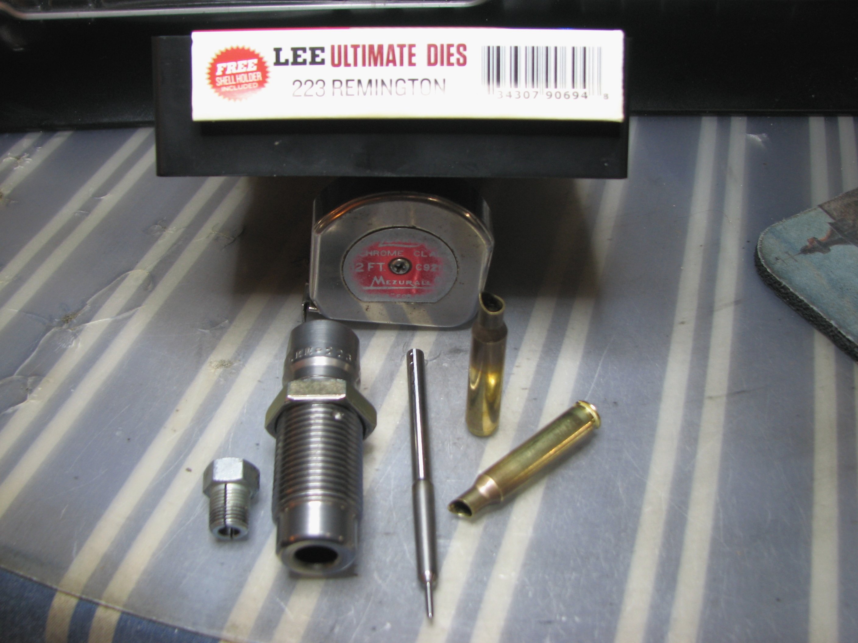

I bought Lee's .223 Rem Ultimate Die Set a few years ago from a popular seller on Ebay.
The set was sold as brand new and upon receiving them, I couldn't see any signs of having been used.
Ended up getting busy with some other jobs and so I had to hold off on using them.
Since then, I had built up a pile of brass over the years and so wanted to start preparing them for reloading.
I ran the casings through the cleaning process and then lubricated them according to the instructions on Lee's container.
I then set the die's depth in my Redding T-7 reloader according to Lee's instructions (The die has "LEE - 223 - FO" stamped on it)

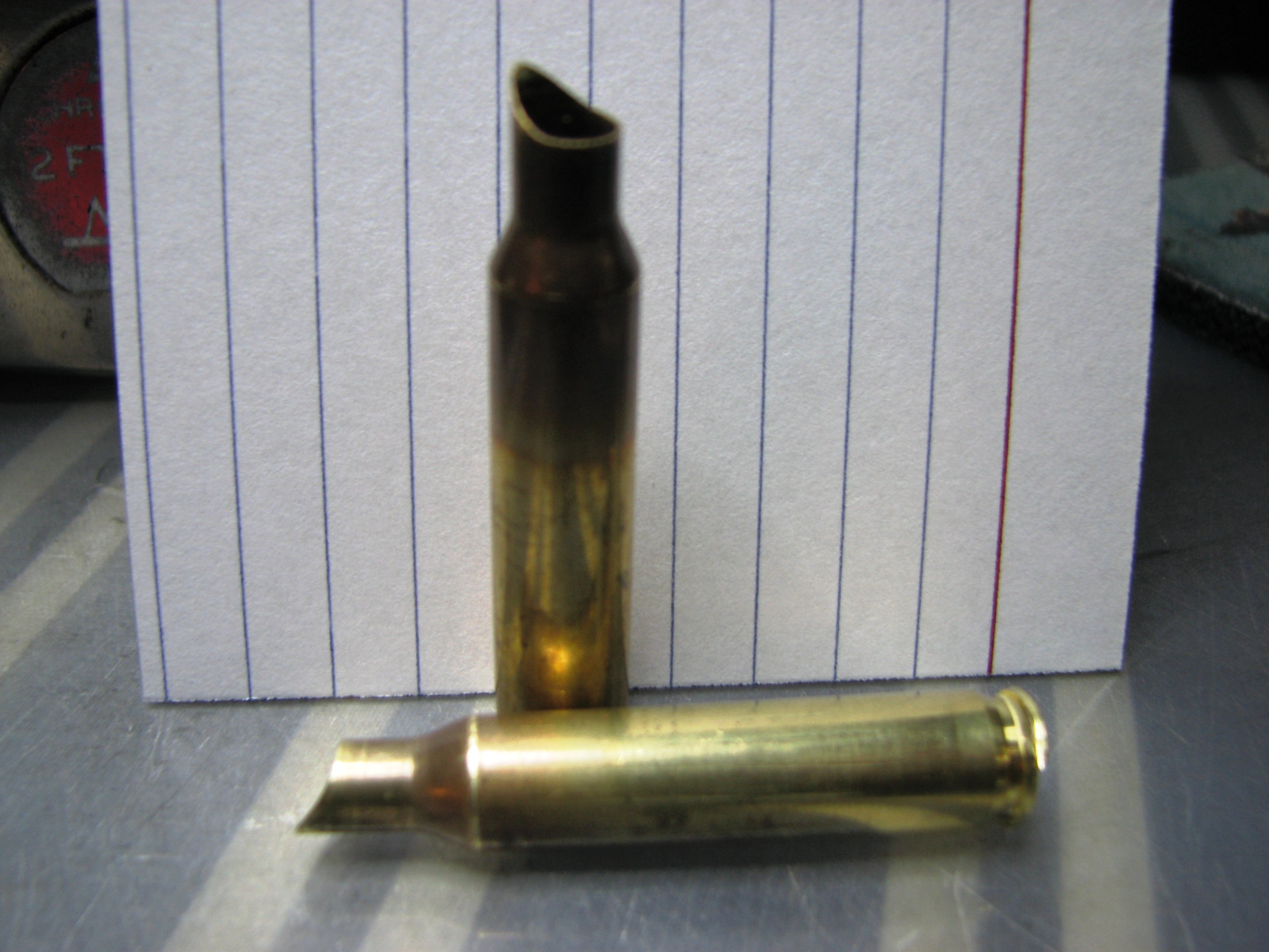

The very first .223 case got stuck to the point of upon trying to remove the case, the case holder sheared off the flange at the base of the casing.
From there I was able to remove the decapping pin and then use a punch to tap out the stuck casing.
Upon getting out the casing, I immediately noticed something that I have never seen happen before and I can't explain since I can't adequately see down into the die.
I wondered if it could have been some sort of problem with the casing itself and so I tried another one but the same thing happened and so I had to go through the process of removing it.
Upon removing, it was the same thing whereby the mouth of the casing is now significantly distorted, and just distorted on one side of it which is very odd to me and so I can't explain it and dont know how to fix the problem
I just now sent a message to Lee Precision but probably won't hear back from for a couple/few days and so hoping someone here has seen this problem before and knows what's causing it
If I had to guess, I'd say the decapping pin is adjusted too high. You are using a quality case lube, right?
Notice the portion of the decapping pin that is larger than the rest of it. This is the part that expands the neck after sizing as the case is withdrawn from the die. The large part must be down inside the body of the case when the neck of the case is being sized.
With a good lanolin lube, it doesn't take a lot of handle pressure to FL size 223 brass. By the looks of the cases, it looks like you had to use some muscle. Did the case jam up as you were pressing down on the press handle?
If the decapping pin is set too high, the neck is being forced into the die and the expander at the same time.

I followed the instructions by Lee whereby them saying to make the top of the decapping pin level with the top of its clamping nut.
I'm using Lee's case lubricator and directly followed their specific instructions as well.
I never had ANY problems with Lee's case lube when having done my .270 Win or 30-06 cases.
I didnt have to strain myself for the .223 casing to press all the way into the die. However I did have to apply a bit more effort to it versus what I had to do for my .270 and 30-06 casings.
After the 223 case fully entered the die, I then tried to pull it back out and thats when it was EXTREMELY difficult whereby it DID NOT even release by a mere few thousandths of an inch ... IT WAS STUCK AS STUCK GETS, and as previously mentioned the case holder sheared off the flange of case's base.
I just got done trying again to decap and resize the casing but this time leaving the top of the decapping pin a 1/16" above the top of its clamping nut and then leaving the top of the decapping pin a 1/16" below the top of its clamping nut.
Either way resulted with the same problem of the case getting extremely tight upon 90% of the case having pressed into the die.
UPDATE:
Found the culprit but dont know the exact problem.
Before clicking to post this reply, I tried one last process of elimination.
I completely removed the decapping pin and the .223 case was getting extremely tight right at the same distance upon pressing it into the die.
There is something majorly screwed up with the die itself .... Lee's usually excellent quality control was a bit shabby that day
So now going to wait to hear back From Lee Precision's customer service and go from there

Properly lubed, a 223 case should take less effort to resize than a 270 or 30-06. I would say maybe half the effort.
You have more mechanical advantage when lowering the handle than raising it.
Try lubing a case and sizing it without the decap pin in the die. Either confirm or eliminate that right off.
You didn't elaborate on how you are lubing the case or what kind of lube you are using.
