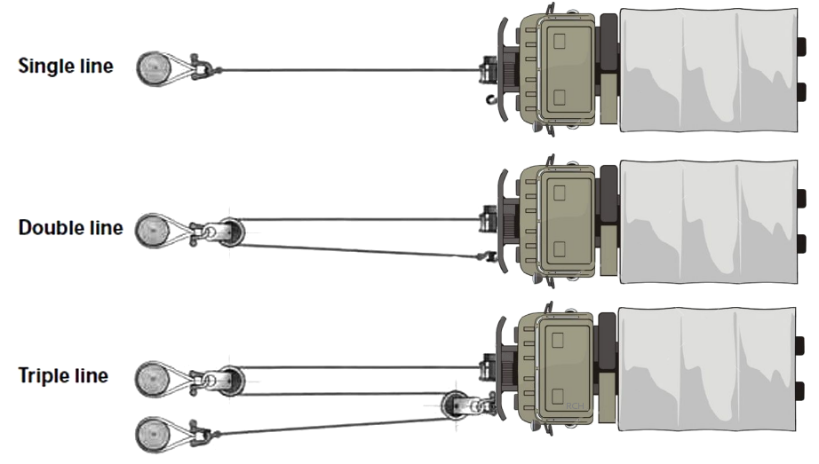

BTW, thx for the video but I have trouble visualizing coils on the ground as the actual rigging. :rolleyes: ;) So which one is it below, assuming the "trees" are the truck frame rails?

Triple line, bottom pic is how I did it. I only modified it so that I had 2 points of contact for the snatchblock on my truck instead of one to distribute weight/pulling force more evenly due to the extreme weight I was pulling

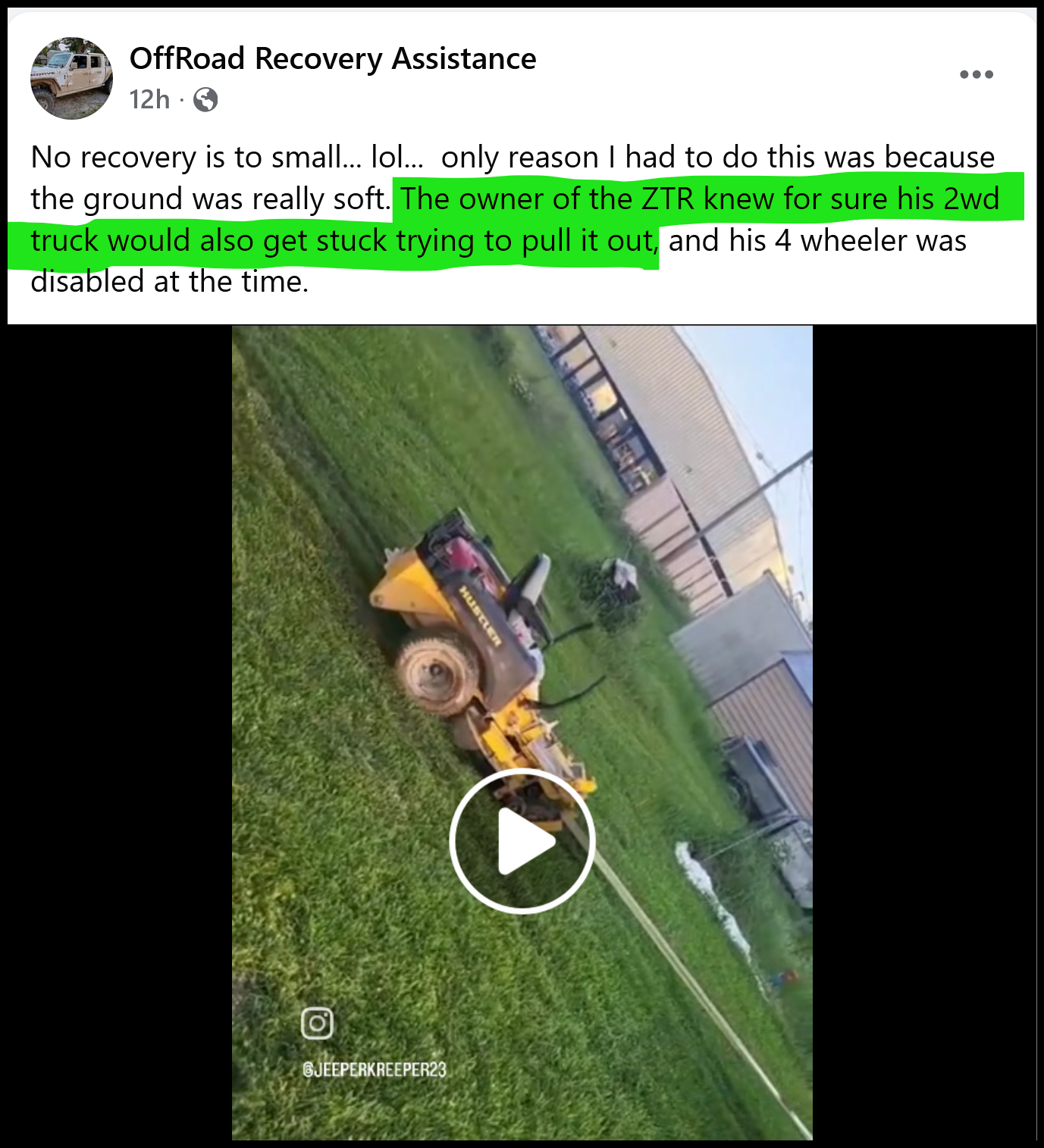

I saw your post about the dangers of "trying to do it yourself" and then saw this on your FB page:
And it reminded me of a little "incident" at my own home... My lawn tractor got stuck in some deep muck in the back yard. So, hey... I've got an AWD Subaru I can use to pull it out! Well.... that didn't work out quite the way I planned! Both got stuck, and I had to call a tow service to pull both of them out.
