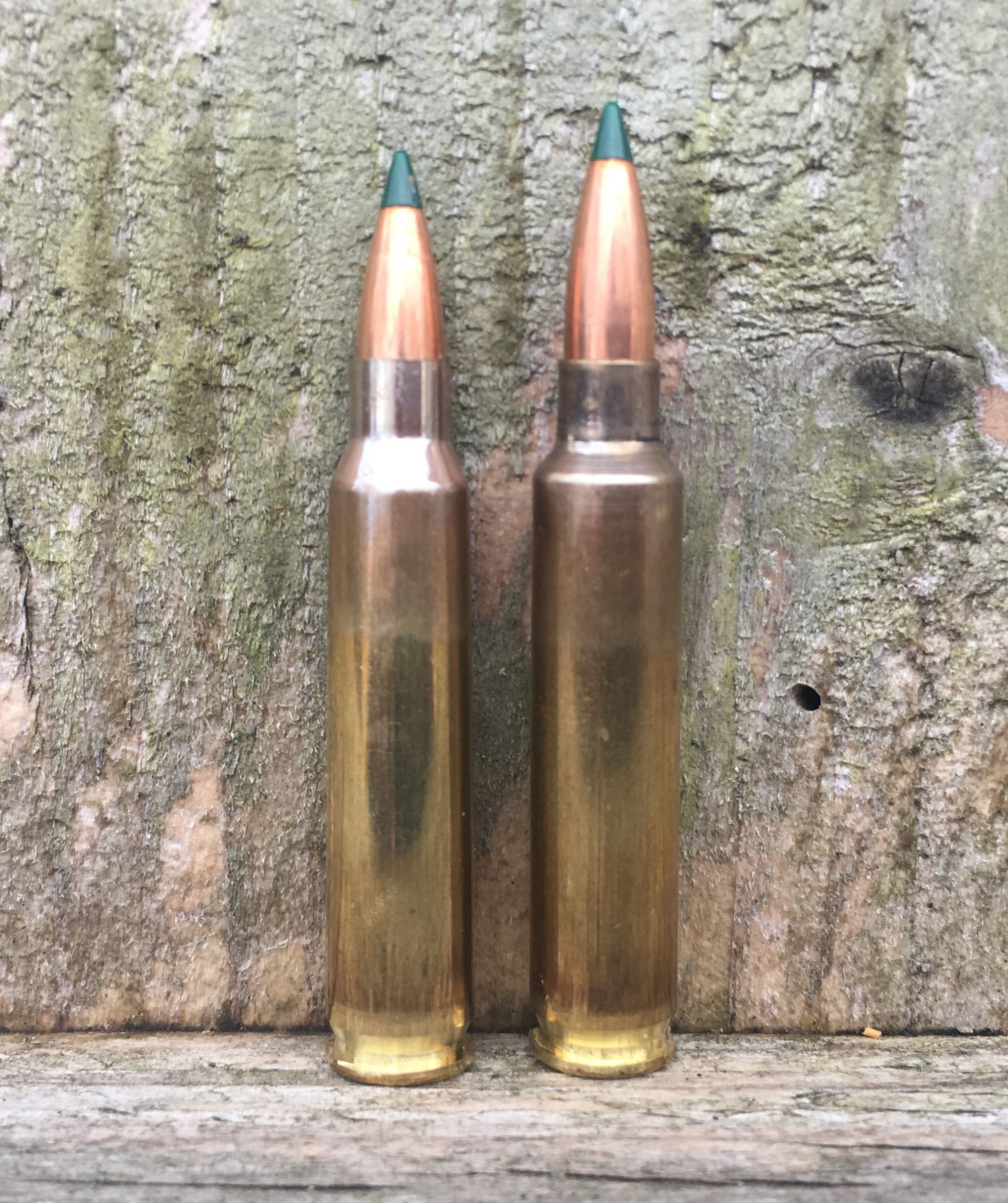

Here's a pic of the two side by side.
The benefit is a couple grains more powder capacity, a 40 degree shoulder, and less case taper. This nets you about 100-150 fps more velocity for the same pressure.
It was designed mainly for varmint hunters to get more performance from their rifle without needing to re-barrel.
