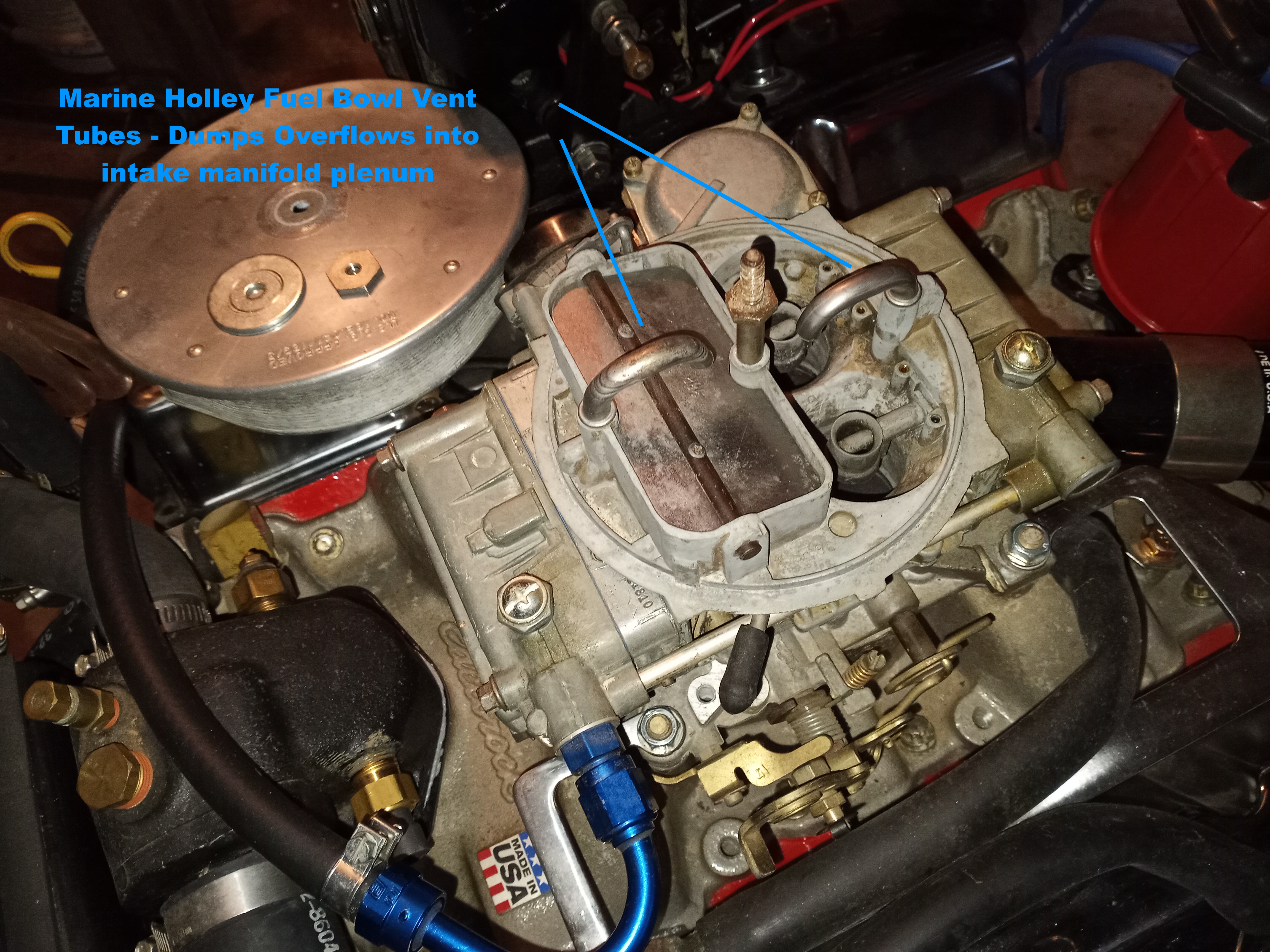

Is that Holley a Marine rated carb? Marine carbs are internally vented inside the flash arrestor.
Same for the distributor and alternator. Marine versions have flash arrestor screens.

Yes to the carb (it is the marine version with the "J" vent tubes.) It was off a Volvo-Penta 4.3 GL
Yes to the distributor. But unlike the earlier Mallory or HEI distributors, there is no difference between the automotive and marine version of the Delco EST distributor, they have identical bodies with mesh screens. Only the cap is different with the marine version, with a vac fitting to vent it to the intake manifold. The module in it is a Delco D1965A, which handles the timing curve internally, instead of the normal automotive modules that spit the timing pulses out for a external computer to chew on and feed back as a trigger signal. Sooooo... you only need one wire to operate this distributor and coil, just the 12VDC ignition. You do have the option of using the extra set-timing wire on the shift switch to kill the ignition while the drive is going in and out of gear. It is a great upgrade to older ignition systems, and much better than the Thunderbolt igntion module.

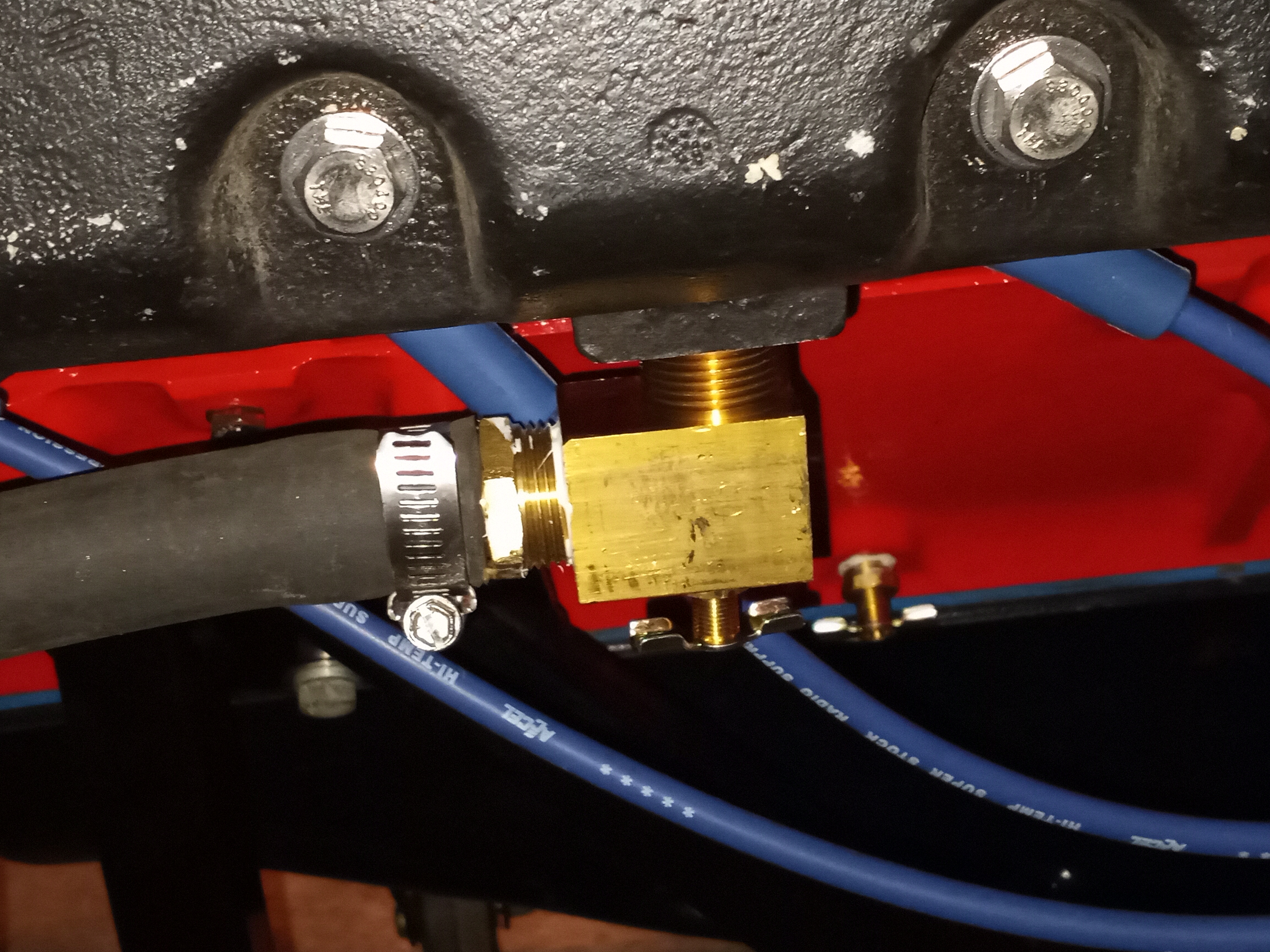

Before the power went out, I was able to finish hooking up the raw water side of the cooling system. I had to make a pair of 90 degree elbows (3/4 NPT to the exhaust manifold to 3/4" hose barb with a 1/4" NPT drain valve added to it.) So, draining the raw water side is a piece of cake.... open the valves on the manifolds and the valve on the supply line from the drive and all the raw water in the heat exchanger and manifolds dumps into the bilge and out the drain plug in the transom. ;)
Now I can hook up a garden hose and run the engine for more than a few seconds at a time. Next day off I'll roll it back out of the garage and set the timing. I also have a few rebuilt carbs to test out for other people.... a pretty eclectic mix of Q-Jets, Motorcraft 2150's, and Holley 2 barrel and 4 barrel carbs. It will be several days of checking them for leaks, setting basic adjustments, and test running them for a little bit before sending them on their way.
Easy way to spot a marine Holley carb... take the flame arrestor off and look for the vent tubes.
Marine carbs have to dump excess fuel from the fuel bowl into the intake manifold. Most automotive carbs have vents that dump into the air cleaner. It is a unique feature of marine carbs that make them safer to use on a boat. The engine bays on a car are open to the ground, so a fuel spill caused by a stuck fuel valve or sunk float in the bowl ends up on the ground. A boat isn't supposed to have a hole in the bottom ;) so a fuel spill ends up in the bilge where it will eventually turn to vapor and might go boom.
There is also a few minor internal differences with regards to the bowl vent baffles and the pocket around the power valve. You can convert any Holley 4150 or 4160 for marine use by just adding these components. But you will have to make your own vent tubes and press them into the body of the carb. Not hard, but Holley doesn't sell them as spare parts, they are considered part of the body.
The carb in the photo is off a Volvo-Penta 4.3 GL (Holley 4160 with J vents.) The fuel supply line is just temporary to test the motor out. On an engine ready for installation, the pressurized fuel line needs to be metal, so before I install it, I'll need to fabricate one out of 3/8 tubing between the pump and the carb. The low pressure side of the pump is allowed to be A-15 rubber line.

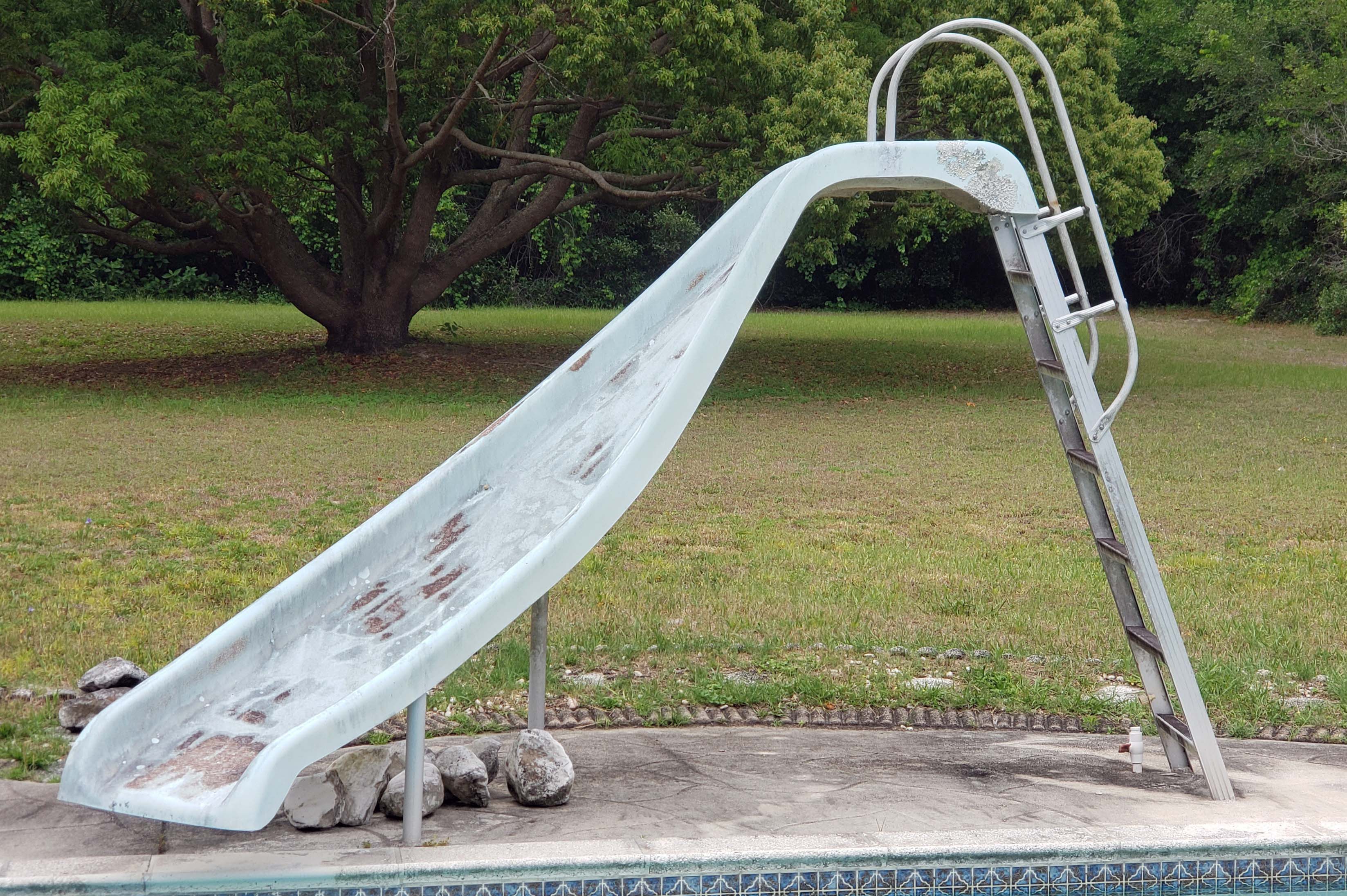

A little OT but since you've mentioned fiberglass, I want to throw a coat of white gel coat on this slide. It is still smooth (fibers aren't exposed) so I'm figuring a little rinsing and scrubbing to clean it and maybe a scuff with purple Scotchbrite before an acetone wipe. Then what would you do and use? I'm not really near the coast or convenient to any marine stores. While mainly for aesthetics, it is also to protect it and keep it functional.
I'd rather spend zero dollars since the I'm the only one that uses the pool and even then maybe once a week? When the kids were kids, the pool and slide were used every day but they haven't been in it in at least a year. :( But I understand there will be costs involved and it is not cheap to keep the pool swimmable with all the chemicals and such. I just got it cleared out after the wife let it go green. 😠 She had one job... :rolleyes:
Gel coat isn't cheap. It is a process I never did. All I know is that there are several types of gel coat and each has a very specific use. Gel coat doesn't flow out and flatten smooth. You have to sand and buff afterwards. It's one of the few boat related tasks I just call the experts.
Something like Petit EZ-Poxy paint would be easier to apply and get a smoother finish. I don't see my favorite top side paint available anywhere, System 3 WR-LPU. It seems it was pulled from the market several years ago. That sucks. It was water borne and didn't stink up the shop.

Probably the best mail order source for fiber-glassing materials is US Composites. They are pretty reasonable. You want gel-coat without wax added for doing repair work, along with a spray-on mold release to use on the last layer of the repair.
Gel-coat is polyester resin with a lot of filler added. You catalyze it with MEK (methy-ethyl-ketone) to start the chemical reaction that harden it. The catch is that it will remain tacky if it is allowed to cure in the presence of air. So, they add wax to it and form a barrier that floats to the top of the layer to make it cure with a hard skin.
So, to repair the slide you will be applying multiple coats of gel-coat like paint. You want each coat to remain tacky to allow each layer to bond to the layer below. When you get the last layer on, you spray it with mold release to create the air barrier and make the top layer cure with a hard skin.
Prep the slide like you are going to paint it. Just before applying the layers of gel-coat, wipe the slide down with Acetone. The slide is most likely made from polyester resin and chopped strand glass. So the gel-coat is already compatible chemically. Acetone dissolves polyester resin, creating that tacky layer to make the new gel-coat adhere to the old glass and existing gel-coat.

Thank you both for talking me out of gel-coating the slide. :D The prices weren't bad LINK but it quickly became a major project without me even lifting a finger... :D The surface is still smooth and about all I would have time for is a quick clean with a bin at the bottom of the slide to keep run-off from going into the pool, then brush/roll something on to make it presentable and maybe even functional.

The best "plan B" approach is to use an epoxy based paint (like POR-15) to paint it. Still use Acetone to prep the old gel coat so you get a good bond.
Plan C - polish the existing gel coat with a decent rubbing compound to remove the oxidized layer (the white chalky dust) and follow up by waxing the crap out of it with a good carnauba paste wax. I use mold release wax, which is pure carnauba wax without any cleaning chemicals added. It is the same stuff that was used in the mold when the slide was made, as well as being the wax that was mixed into the original gel-coat.

If you look at the pic, it is down to the brown. That wear is just from the sun, mainly. I'll inspect it a little better to see if it is even worth saving. As I'm the only one who does projects around here, it is down on the list. Since it was "sort of" topical and sort of a rare topic at that (ie: fiberglass), I thought I'd inquire.

Gel coat is the absolutely correct way to do it, but... It will involve a few tools you will not likely use again. The slide might possibly be made with vinyl ester resin. The color of the bare spots makes me lean that way. Darker reddish brown vs. pinker looking. Could be how the photo comes out on the site. Vinyl ester and polyester resins are close but not entirely compatible. Epoxy doesn't play nice with vinyl ester either but fine with polyester resin. Epoxy is not UV resistant even the UV resistant formulas. The cost and time penalty of something going wrong with gel coat isn't worth it to me given my lack of experience with it.
Roll and tip painting with Petit or Interlux paint is well known and pretty foolproof. With just a little practice, you will have a gel coat looking finish. It's good for 5-10 years depending on color and latitude. Easy to touch up and redo in the future. I'm at an age where redoing something like a slide is statistically my last time I have to deal with it.
