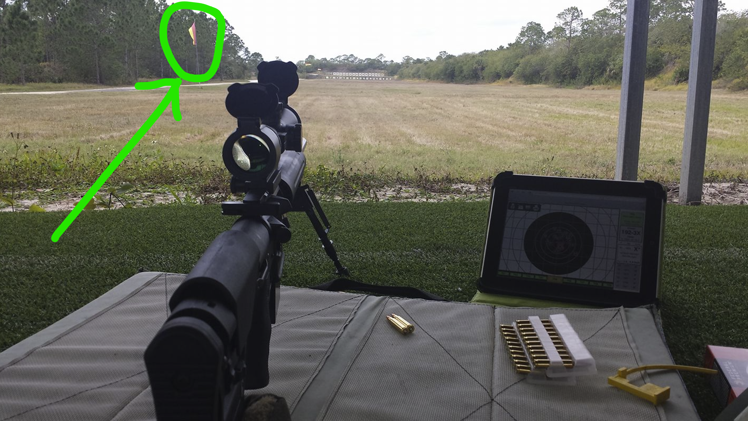

Look at the size of that wind flag and guess the wind speed. :unsure:
that's a really weird looking wind flag. I've never seen one that looks like that. It appears to have a rod in the top of it?
Looks more like a banner.

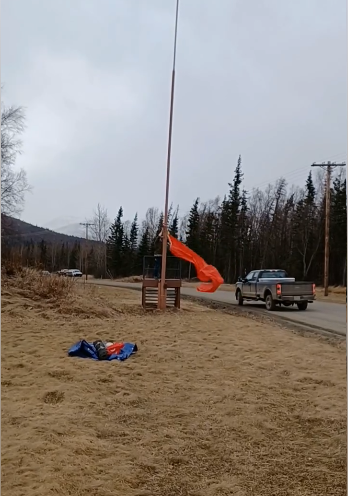

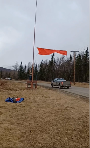

Nope, no rod. That image is a screen capture from a video. Here's another when the flag is lowered and limp. This flag has a square tip. The official winds flags are a pennant that has a pointed tip.

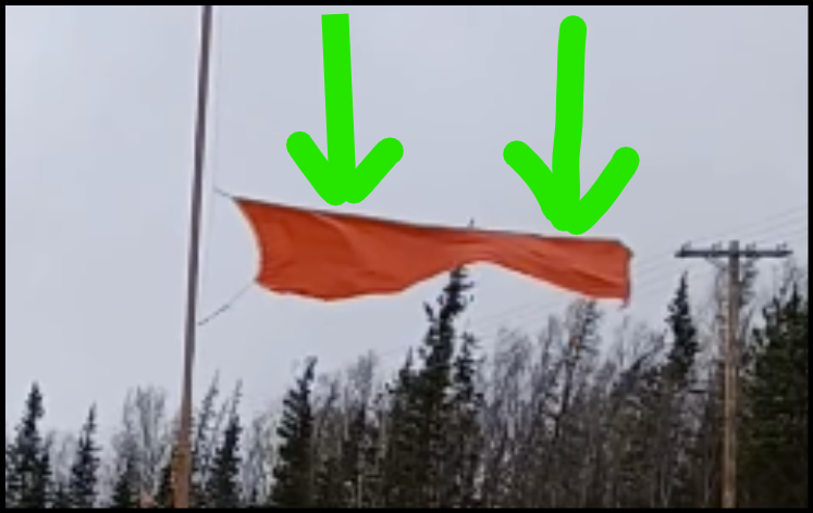

The point is that when the wind reaches a certain speed, the flag will stand straight out like it is starched. At that point, it is no longer useful in estimating wind speed. This above 25 mph. The official flags are cotton. (or they were when I was competing) Nylon flags will not give the same reading to compare to your data book wind chart unless the new ones have been calibrated for nylon.
