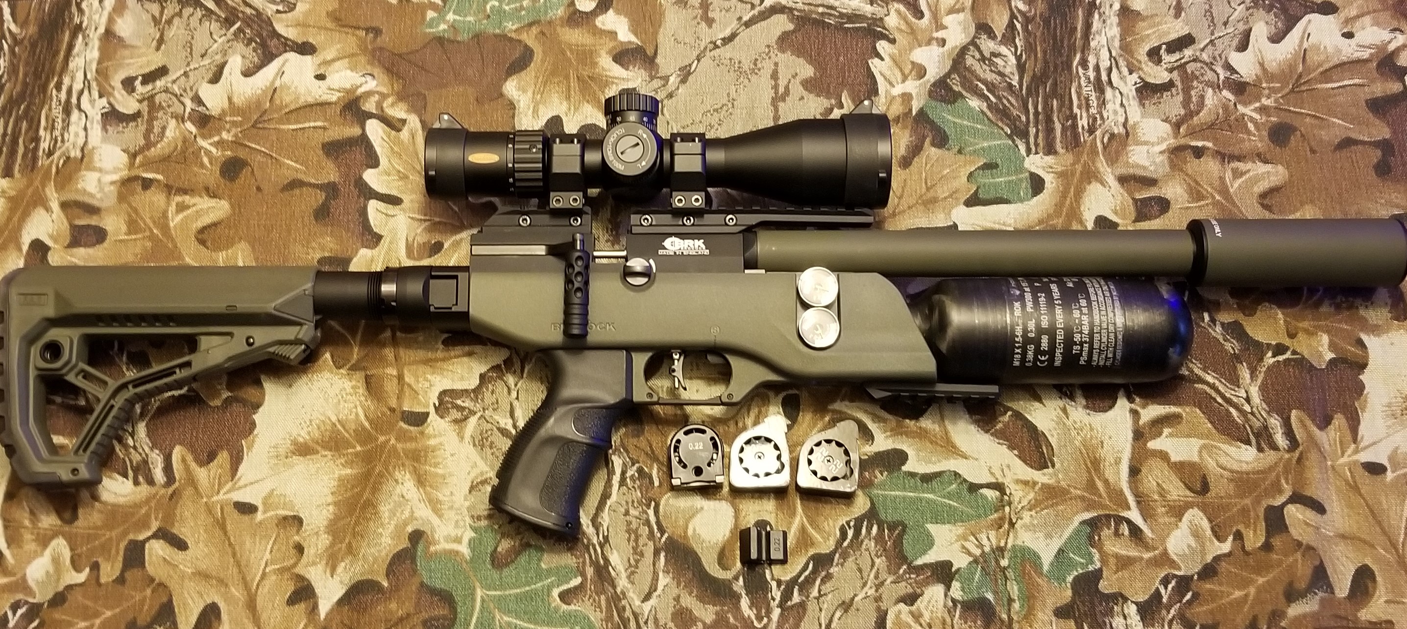

This arrived last night after a wait of a month for it to come in off B/O.
BRK is a subsidiary of Daystate. Both brands are made in the same factory in Staffordshire England. Basically, Daystate makes the traditional wood stock air guns, and BRK makes the tacticool pistol grip air guns, but there is a bit of crossover.
Highlights:
300 CC carbon fiber air flask with a max fill pressure of 250 bar (3625 psi). Air flask itself is rated at 374 bar (5424 psi)
50-80 shots per fill. (depending on power level)
Four power level settings, selectable by the user.
Folding and telescoping stock.
11 shot factory magazine.
Factory suppressor.
Max. power 27 ft. lbs.
Weight: 6.4 lbs. (no scope)
OAL including suppressor. (stock extended) 30.5-34" (stock folded) 22.24"
Just got the scope mounted and still need to square it up.
More to come. ;)

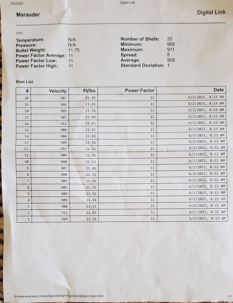

Velocities.
Here are some readings I was able to take today. Dunno if my chrono is just getting old, or the pellets are harder for it to see, but everything had to be just right to get a reading. So I focused on that and will leave getting groups for another day.
I ordered a sampler pack of pellets to test an assortment of weights/styles.
13.4gr.
Marauder
Avg vel. 841
SD 7.2
MAD 5.1
ES 10.2
Pathfinder
Avg vel. 848
SD 19
Mad 14.3
ES 51
15.9gr.
Marauder
Avg vel. 812
SD 2.5
MAD 1.8
ES 6.3
Pathfinder
Avg vel 795
SD 1.4
MAD 1.0
ES 4.5
18.1gr.
Marauder
Avg vel. 773
SD 3.8
MAD 2.8
ES 10
Pathfinder
Low power setting in parenthesis
Avg. vel. 783 (600)
SD 2.7 (14)
MAD 2.3 (9.7)
ES 8.2 ( 33.9)

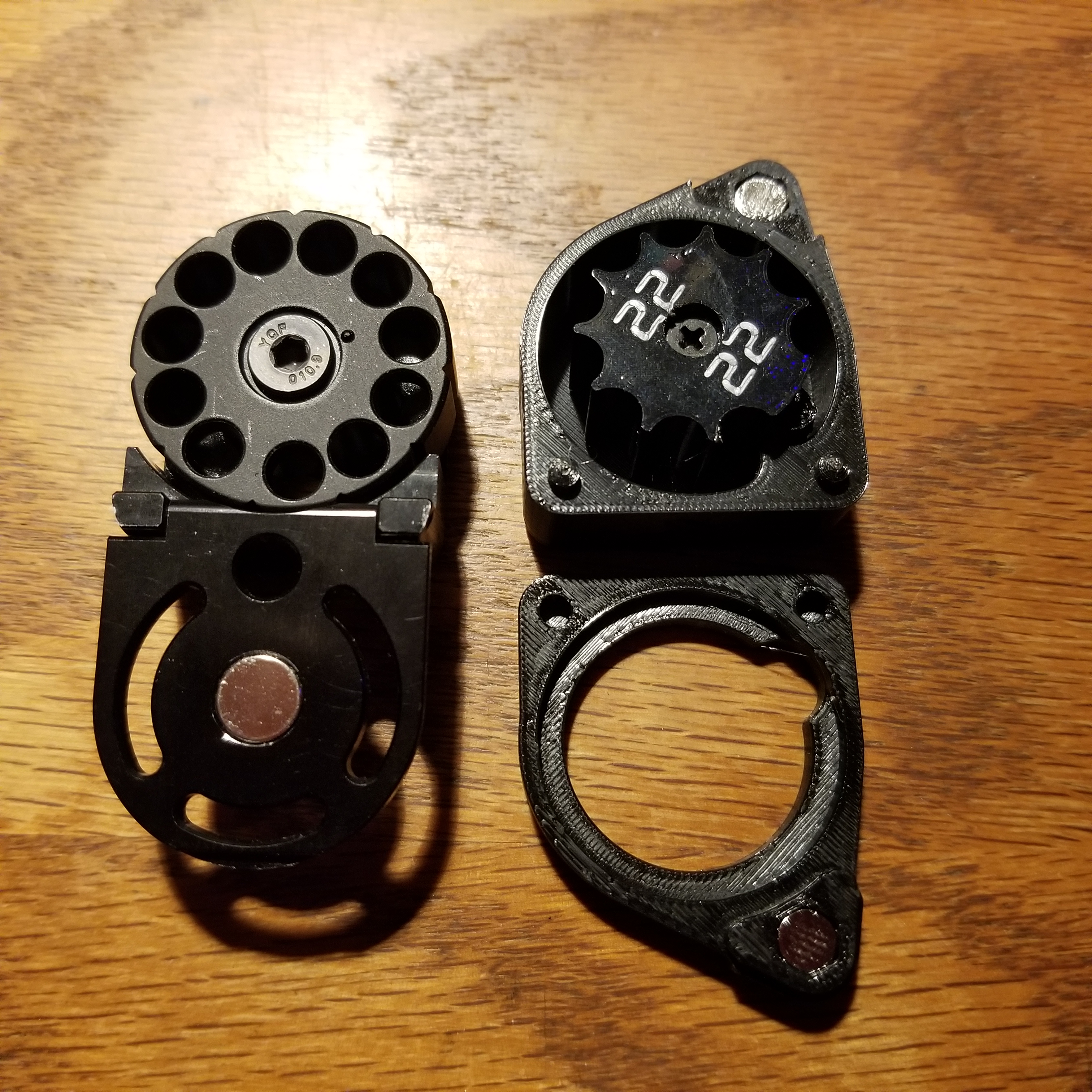

Magazines

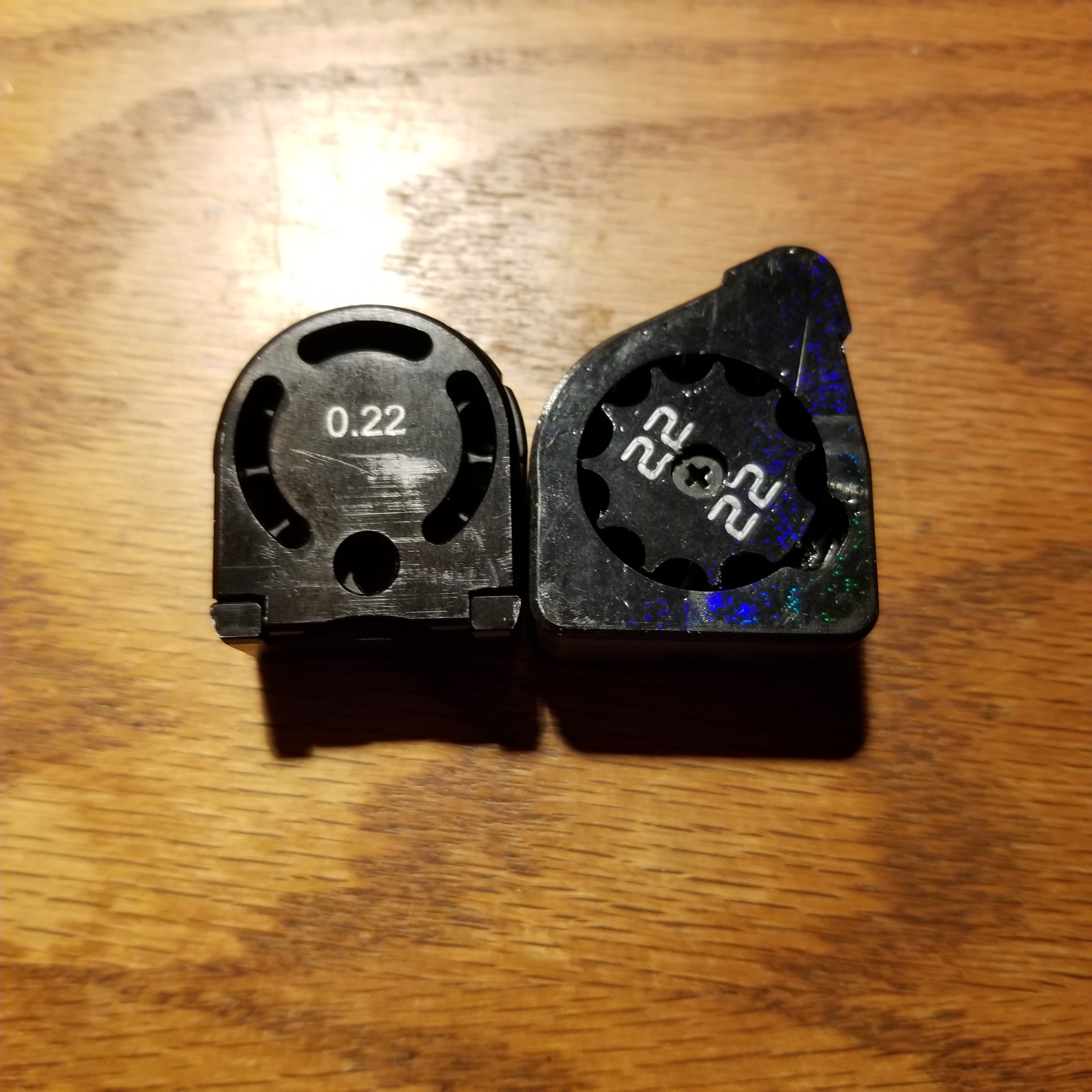

As mentioned, the factory BRK mags are billet and pricey. But they work like a dream. But at $119 ea., Homie don't play dat.
A company in S. FL named Orion makes 3D printed mags for a bunch of popular air guns however, and at $30 ea., these were much easier to take.
Factory mag on the left, Orion on the right.
BRK mag has a hinged lid that makes loading a breeze. Orion has a magnetically attached lid that you pop off to load.
The Orion mag has a block that prevents you from closing the bolt on an empty mag. The BRK does not.
Both mags fit and function flawlessly.
Holy crap! $119 for ONE magazine?!?? That's crazy.

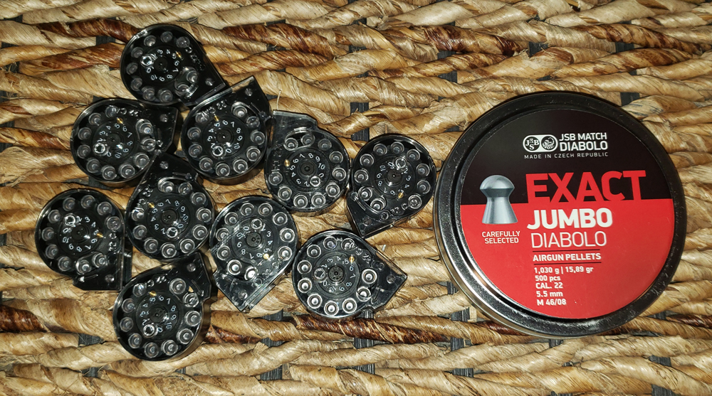

$18 each for Marauder mags. So I got ten of them! Saves time when I pre-load them at home before going to the range.

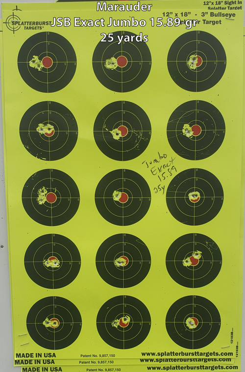

This was one of my 25 yard targets on my inaugural range trip for the Marauder. Two shots per target. A few of them were true 1-holers. I was impressed!

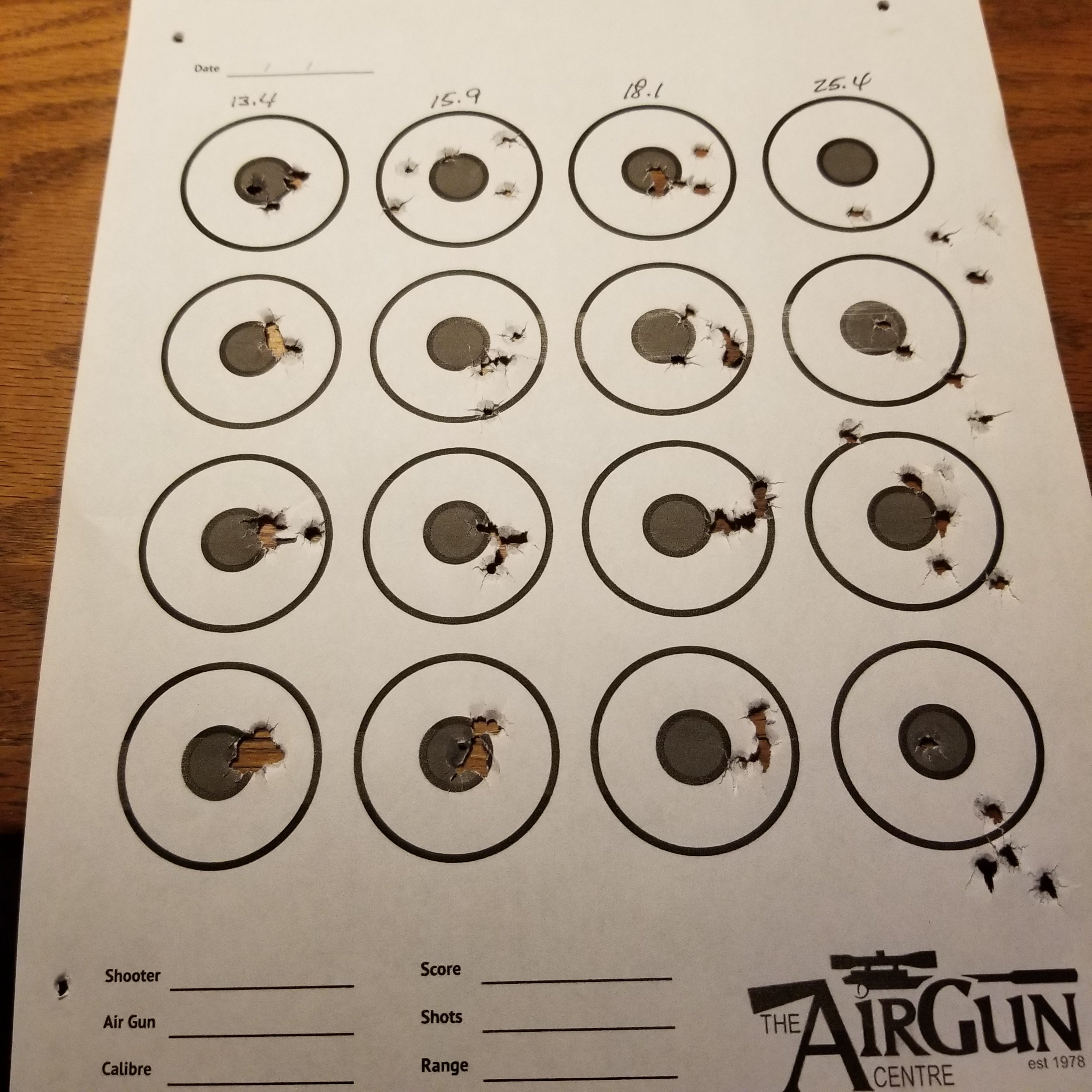

Second shooting session with the Pathfinder today.
I ordered the JSB pellet assortment to see if the gun had a distinct preference.

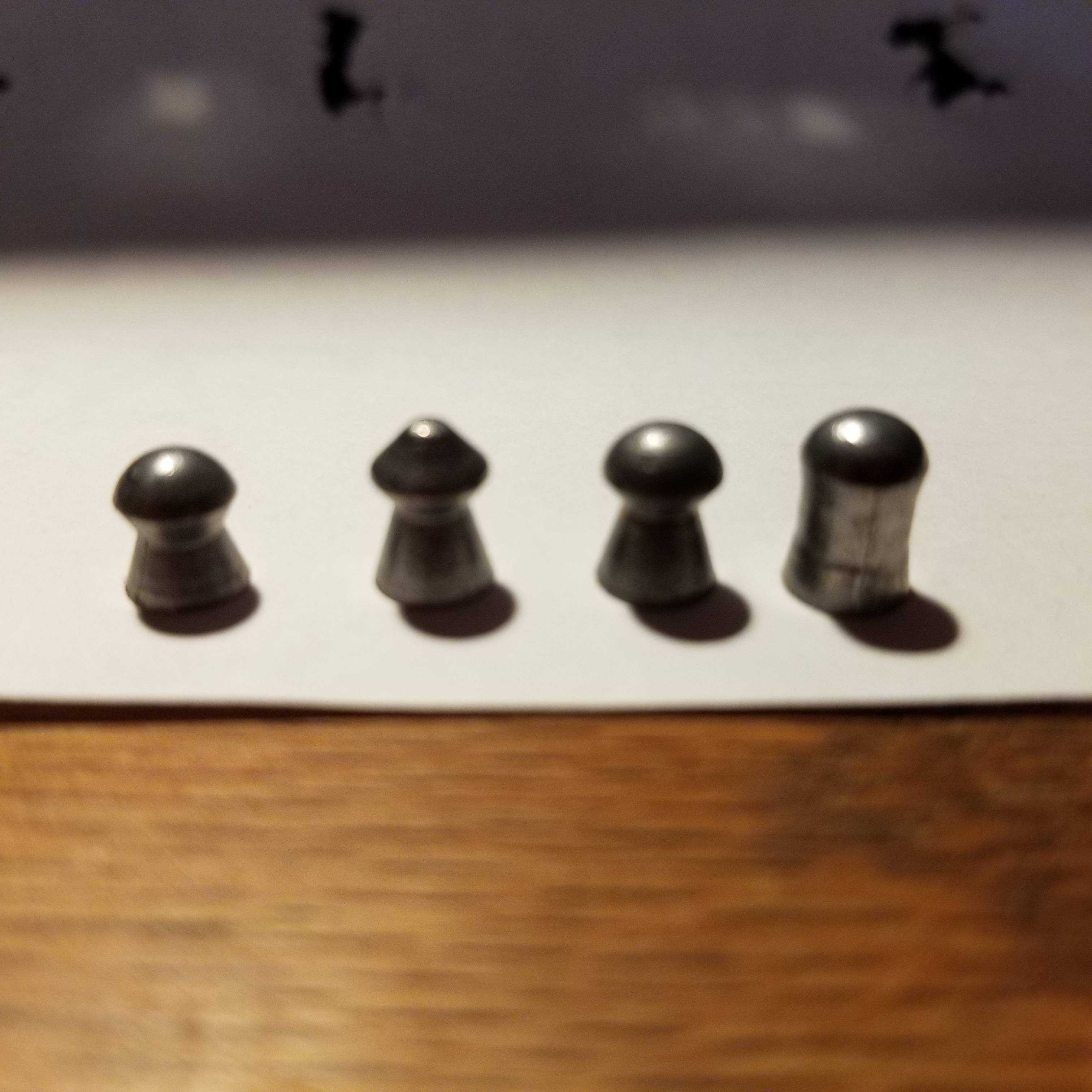

Here's the pellet line up. L to R 13.4 - 15.9 - 18.1 - 25.4
I started out shooting the rifle with the same hold I used for the Marauder. Turns out, for benchresting, less is more.
Not holding the rifle firmly resulted in better groups, except for the 25gr. pellet. I will keep trying and see if there is a technique that works, or if the rifle just doesn't like the heavies.
Each column on the target is the same pellet. So, the first row is holding the rifle like the Marauder. The second row light shoulder pressure on the stock, and the bottom two rows are barely touching the stock. This is not as easy to do as with the Marauder. The round air bottle is what is on the rest, and it doesn't want to just sit there by itself like the Marauder does. So, you have to hold it some to keep it upright.
The bottom two rows tell you more about how the rifle shoots and the top two on how much more practice I need learning to shoot this gun.
Strangely, the 13gr. pellets didn't seem to care how I held the rifle as much as the others.
All targets are 5 shots at 25yds.
The trigger pull on this gun out of the box was 6lbs. Because it is considered a field gun rather than a target gun, BRK sets the pull weight higher. It is user adjustable...kinda. You can only adjust the first stage, and backing out the screw as far as I felt was prudent dropped the pull weight to 5lbs. Useable, but not ideal. Would rather have about 3lbs. However, the release is a very crisp, clean break.
The internet says you can send it off to a pro and have it adjusted lighter, but who that is and what it costs is unknown. I haven't dug that deep yet.
I think I will just shoot it as-is for now and see what a couple hundred pellets worth of break-in does for it.
