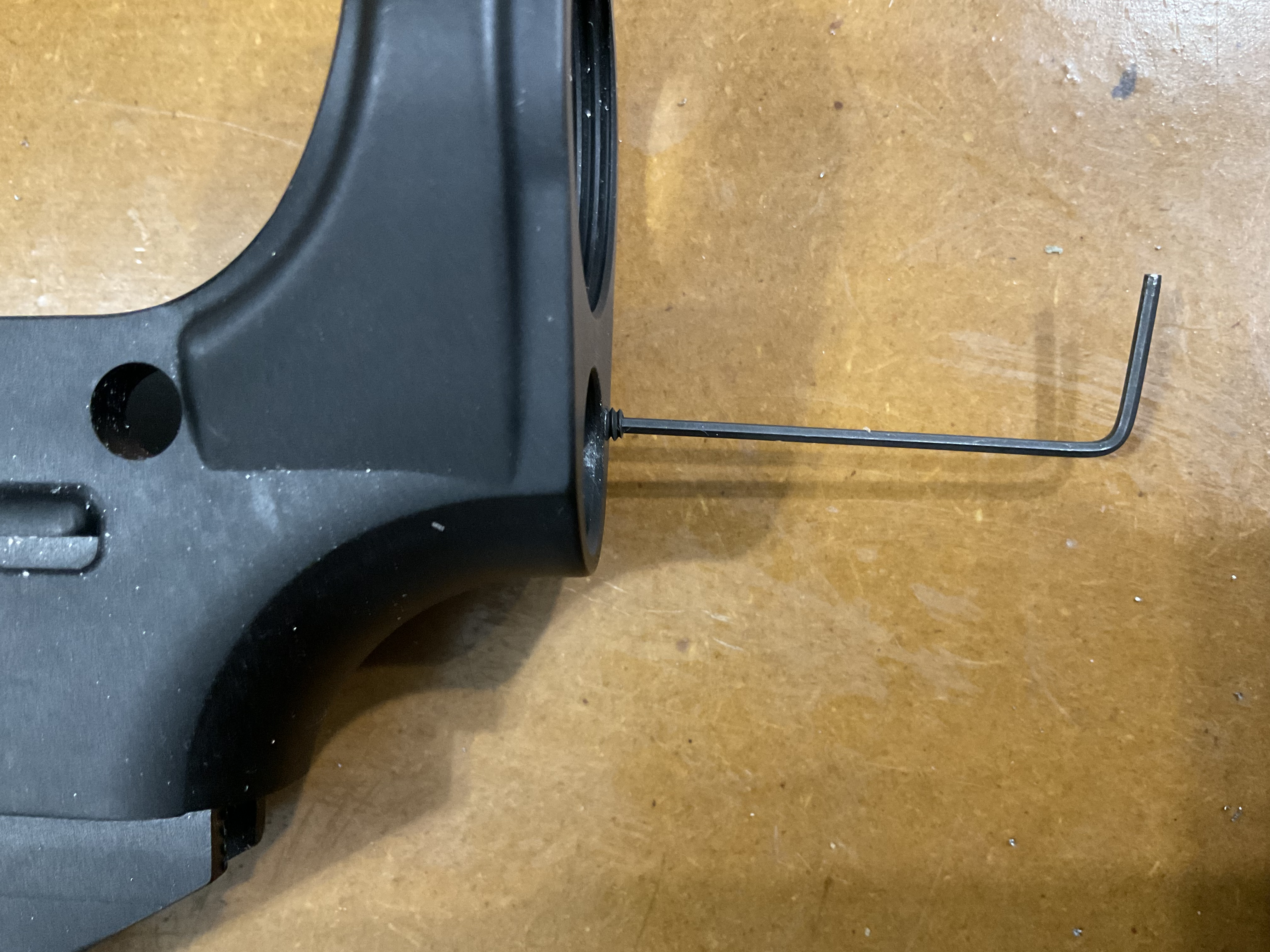

I’ve seen so many great tips on this site and wanted to share one. This might be so basic and everyone already does it, but if not, here goes.
After loosing a couple rear takedown detent springs when I removed the receiver extension/buffer tube, I came across a helpful tip of inserting a small set screw in the hole on the back. Some higher-end manufacturers already do this, and some 80% receiver are using a set screw for the bolt catch pin.

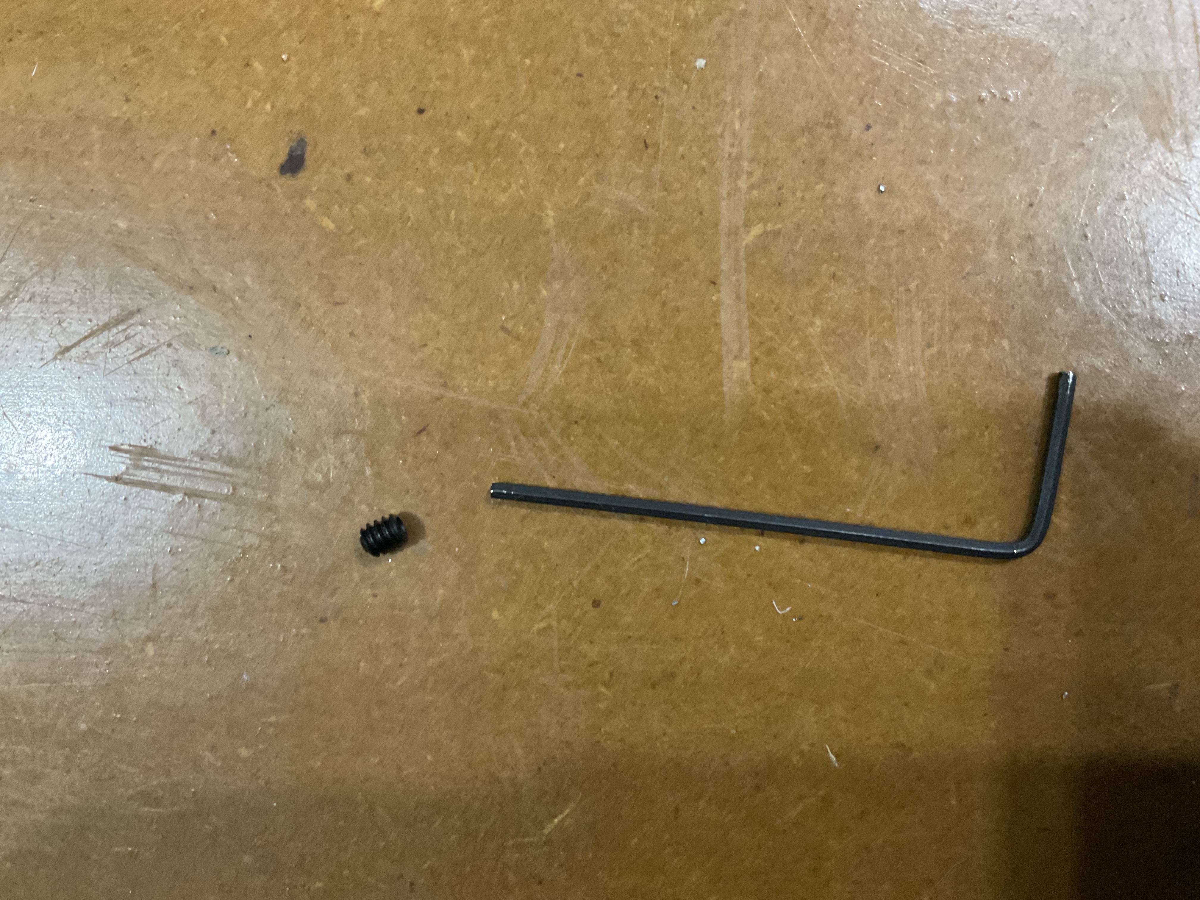

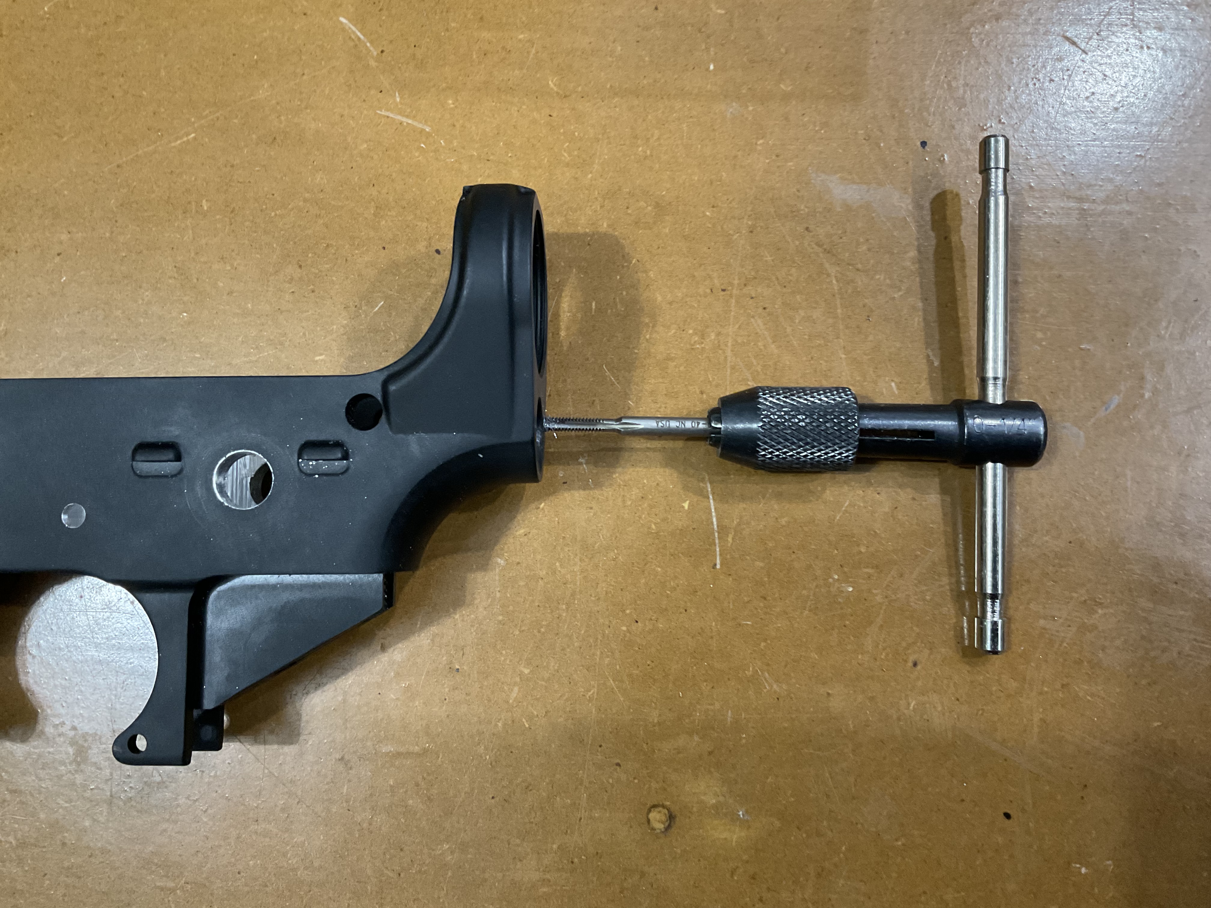

It is simple enough to tap the spring and detent hole on the back of the the lower and insert a set screw to keep the detent and detent spring in place. I use a 4 X 40 thread tap and a 1/8” long set screw. After threading the hole, shoot a bit of compressed air in the hole to remove any filings. I don’t use any threading oil since pretty quick and not cutting that far. I also don’t worry about touching up the exposed aluminum, but it is simple enough using Beachwood Casey Aluminum Black if desired. I do trim about 1/8” off the detent spring or it gets a bit difficult to get the set screw started.

I got a kit wit extra grub screws from Brownell's and I did every AR platform I have.

All my lowers are AERO and all the pins are replaced with set screws and all the springs can be held in with set screws. They are nice. Just sometimes you may have to trim the springs down a little depending on the size of set screw you are using. Sometimes it puts to much pressure on the detent.

Ordered a whole package of 4-40 set screws.
