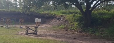

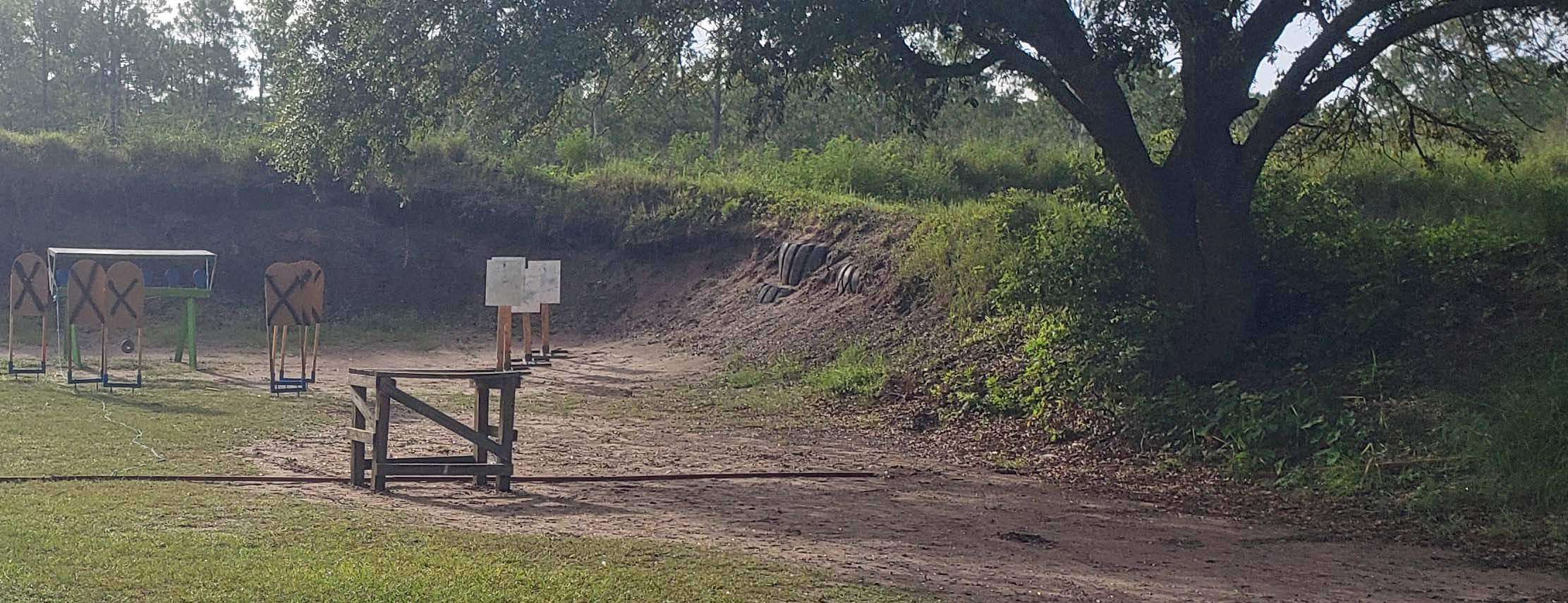

My concern regards the side berm in-between the Plinking and Special Use range. It seems "low" to me compared to an Orlando range I go to. Their berms are probably 15' high or higher. The berm in question is probably not more than 10' high and much lower near the pavilion.
The last couple/few meetings I've brought this up. Especially since they just spent a TON of money on the Competition range including raising the berm between it and the Pistol range. They also put down a bunch of concrete and a larger roof is forthcoming. The Comp range is used for ARA, service rifle, silhouette and other "slow" fire competitions. Coincidentally, all of the club officers shoot in some or all of the aforementioned competitions. :rolleyes: The Special Use range is only used for Action Pistol, Defensive Carbine, Hunter Safety and new member qualification so it is the ugly stepchild of ranges... :( Personally, I'd like to see the SU range get more use to help bring younger members into the club. We had 7 new members join tonight--I'd say half of them were under 40yo which is promising. :)
After tonight's meeting I brought up the berm issue again with the Treasurer, who mentioned during the meeting that he was unsure how high the side berm should be and if it even needed "fixing" (ie: $). The VP chimed in and said "we have the NRA book (older) and it says the side berms only have to be a minimum of 8'. The Special Use range is at least that". I would have called BS had I known the ACTUAL NRA recommendation for side berms on a steel plate range. "What if spalling enters the plinking range while someone there is putting up a target?" The President then chimes in "if that happens we'll have to limit Action Steel to lead ammo only." Me: "That would effectively shut it down because 95% of the guns we shoot are 9mm!" At that point I determined the Pres was a definite Fudd. 😠 I think he was VP when the members voted FOR Action Steel several years ago and was AGAINST it and apparently still is... :rolleyes: If I had the time I would run against him in the next election. I KNOW I could round up the support... ;)
QUESTION: What is the NRA recommendation for side berms on a range where steel targets are shot?

This is about the best pic I have of the berm in question. The 5 plates are stage 1 of one of the events. The majority are 4' high, one is 3', one is 5'. Now figure the grass on top of the berm is probably 3'-4' high. How high would you say the berm is? Keep in mind on the other side of the berm, people will be walking to set up targets on the Plinking range.

In your range pic, the distance from the ground to the top of the berm appears to only be about 6'.
But with the targets on posts, the distance from the tallest target to the top of the berm looks to be only about 3-4'. (Hard to tell with the grass on top of the berm.)
So, 3-4' then becomes the effective height of the berm.
Something I have seen a few clubs do is to stack dirt or sand filled Super Sacks up to create a berm without the need of a lot of heavy equipment.
The bags come in different sizes and if you can find a local plant that discards the bags, you may be able to get them for little to nothing.
Level the top of the existing berm with a Bob Cat, and then stack them as needed.

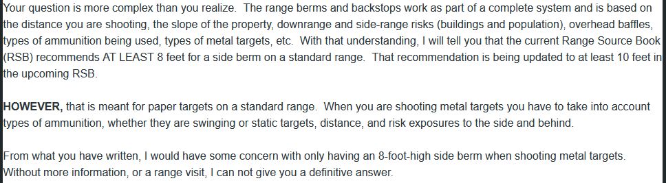

Thanks for the info. A guy from the NRA Range dept. got back to me today. While he answered a few Emails with pics back and forth, he soon determined that the range will have to be inspected by them to the tune of $750. :eek: And that is IF we are NRA-affiliated. :unsure:
I don't know what affiliation entails but we USED to require NRA membership as a condition of membership of the club. Then some weenie(s) at the county council made the club drop the requirement as a condition of lease renewal. :rolleyes: The property is leased from the county (5yr lease).
This is the extent of info he gave me before he started asking for money... :rolleyes:

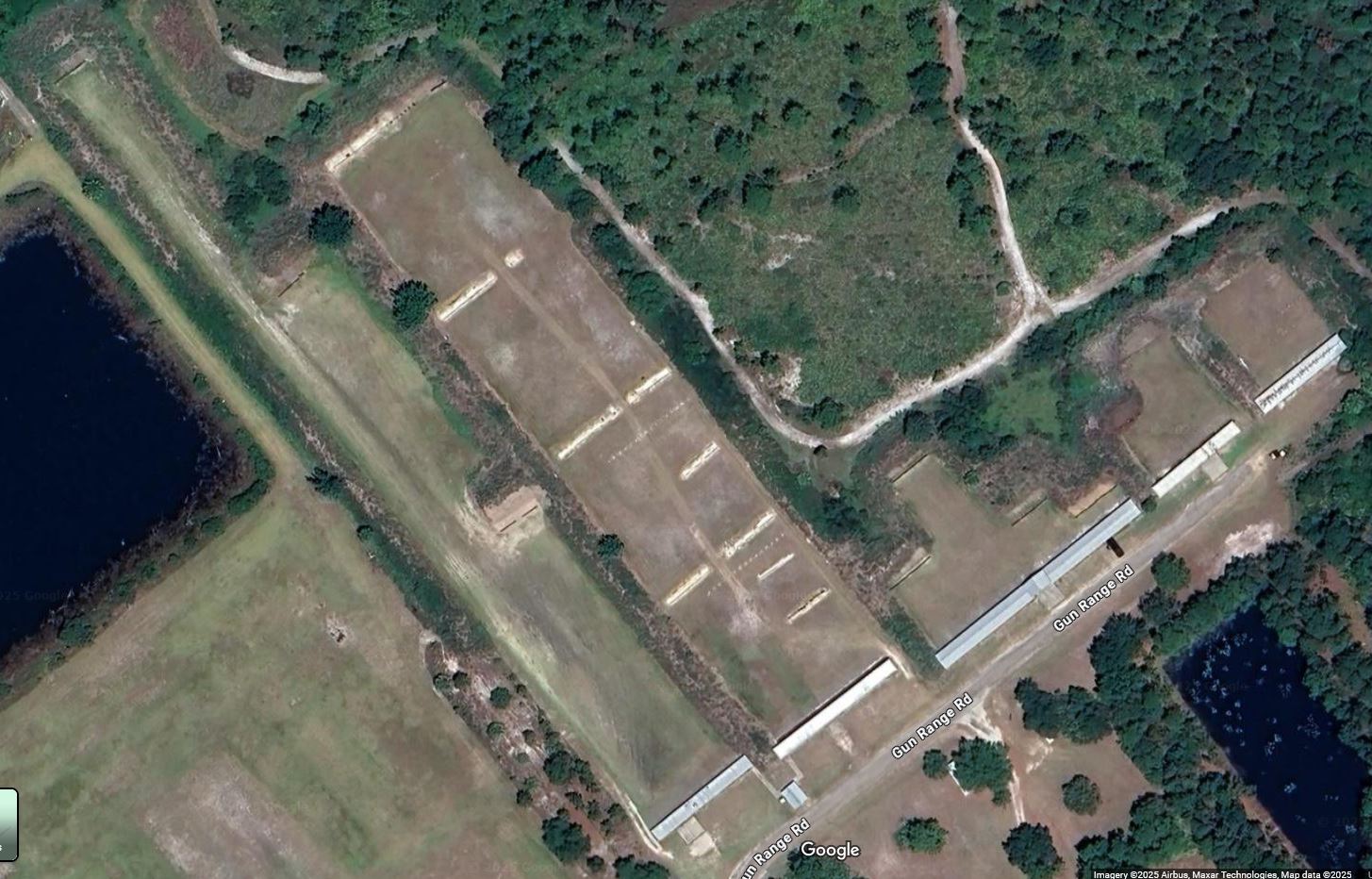

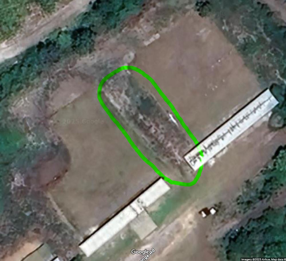

I looked at one of the pics from the Orlando range (below) noting they have stacked equipment tires under the berm (in the corner). I'm also noting this particular side berm isn't THAT high. :unsure: I HAVE been struck with spalling from adjacent ranges here before. :eek: They rebuilt another of the ranges last year and it ended up probably 15' high in places. Maybe this one is on the list to be rebuilt. :unsure:
