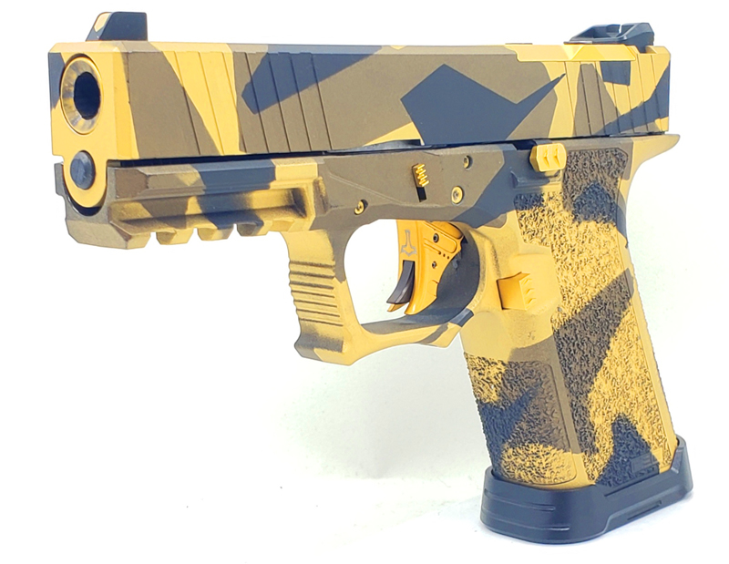

I've been happy with Armorally stuff.
G19 - "Goldi."
And future G20! "Rebel Yell."
