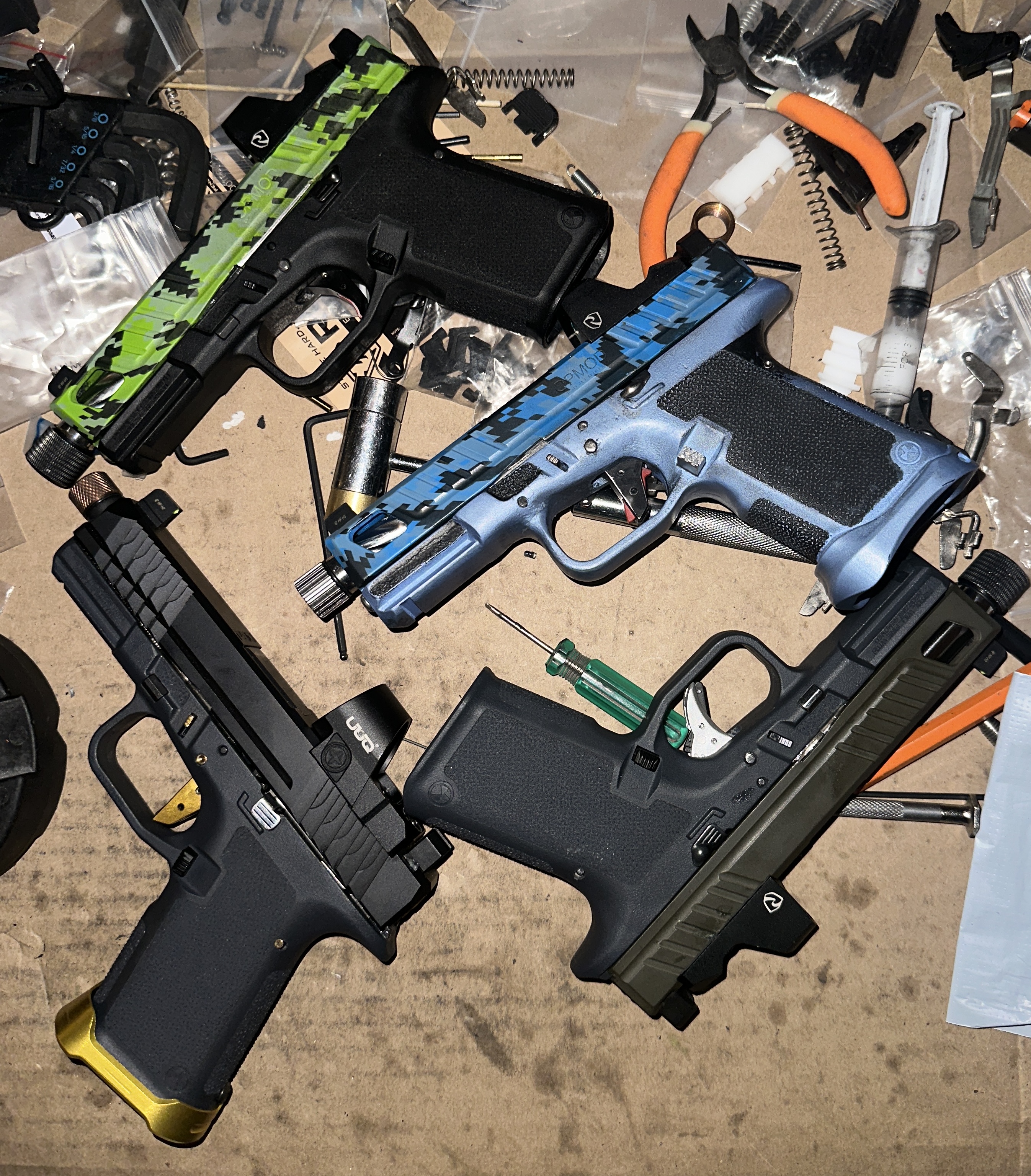

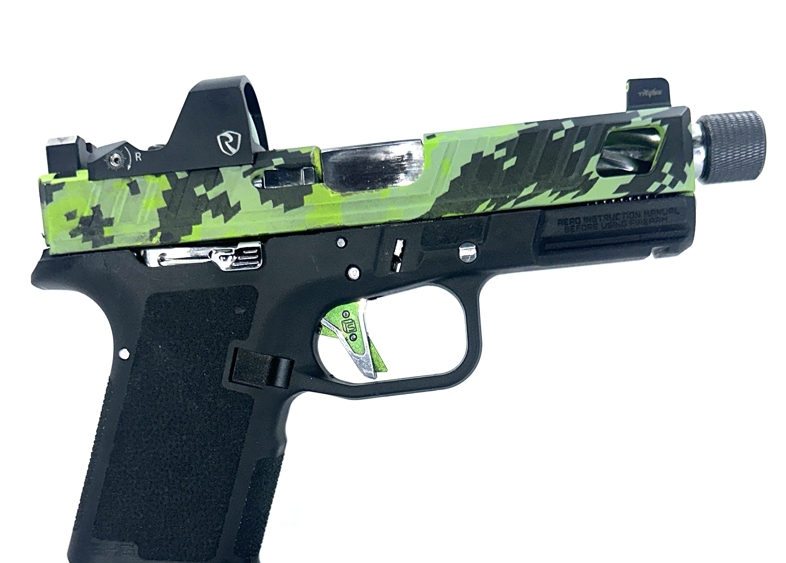

Built a total of 4 of the FrankenRuger RXM’s. I’ve used some different parts to do so such as front rails from a PSA Dagger, P80, and my own using the RXM locking block. For the rear rails, I’ve used PSA Dagger rails, P80 rails, and some generic rails for printed Glocks. For the other ones I made, one has a GPT, another has a Timney system I modified for the stock Ruger trigger housing (Timney is now making a drop in system for the RXM and that would have saved me a ton of time), and one with a Gen 4 trigger housing but will be replaced with a GPT the next time I order some.

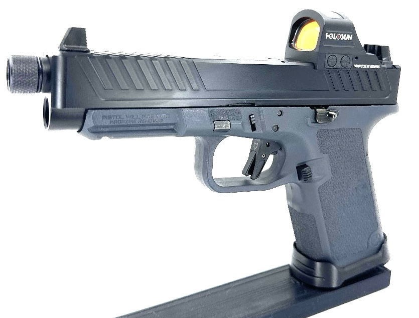

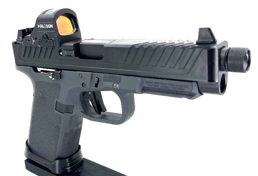

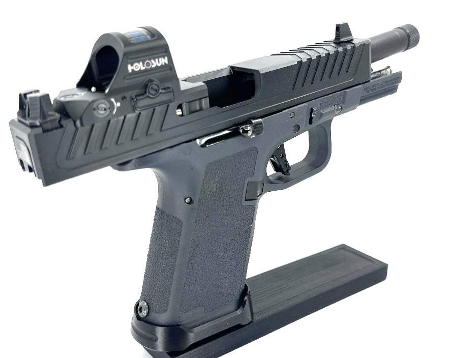

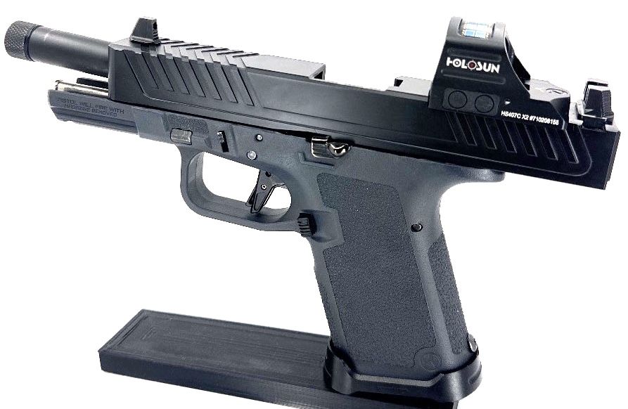

For this build, I wanted to create my own version of the G49 based on one of my FrankenRuger RXM’s. This one has a Gen 5 ambi slide stop, Lone Wolf trigger shoe, minus connector, Ruger RXM trigger housing, Gen 4/5 Alpha slide, NDZ Gen 3 to 4/5 RSA, VDI billet firing pin and VDI billet extractor, Gen 5 G17 threaded barrel from AIM, OE Glock firing pin safety/spring, spring cups, channel liner, spacer, and extractor depressor plunger assembly. As you can see, it also has an aluminum magwell and Holosun red dot.

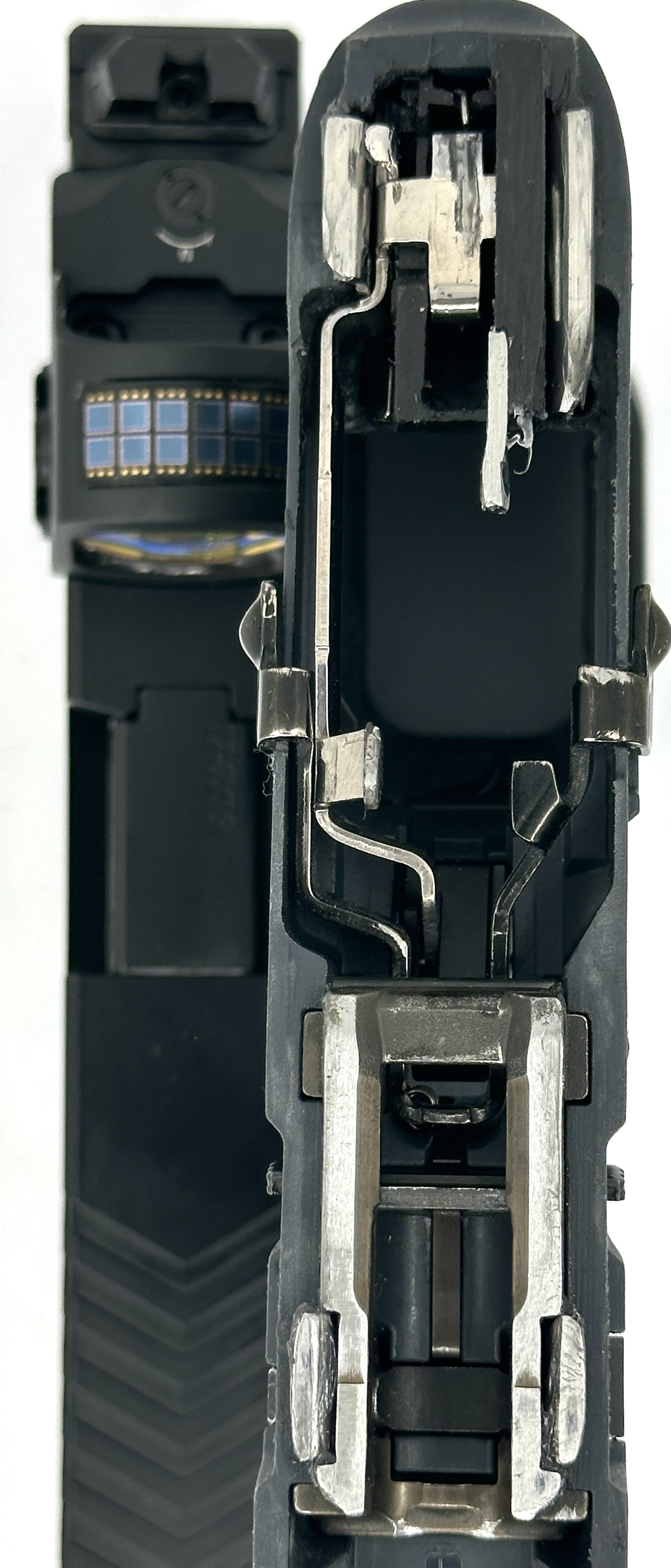

None of the ones I make have the Ruger FCU assembly as it is not needed to make this a working firearm. Also, all of these run best with Magpul magazines, imagine that.
