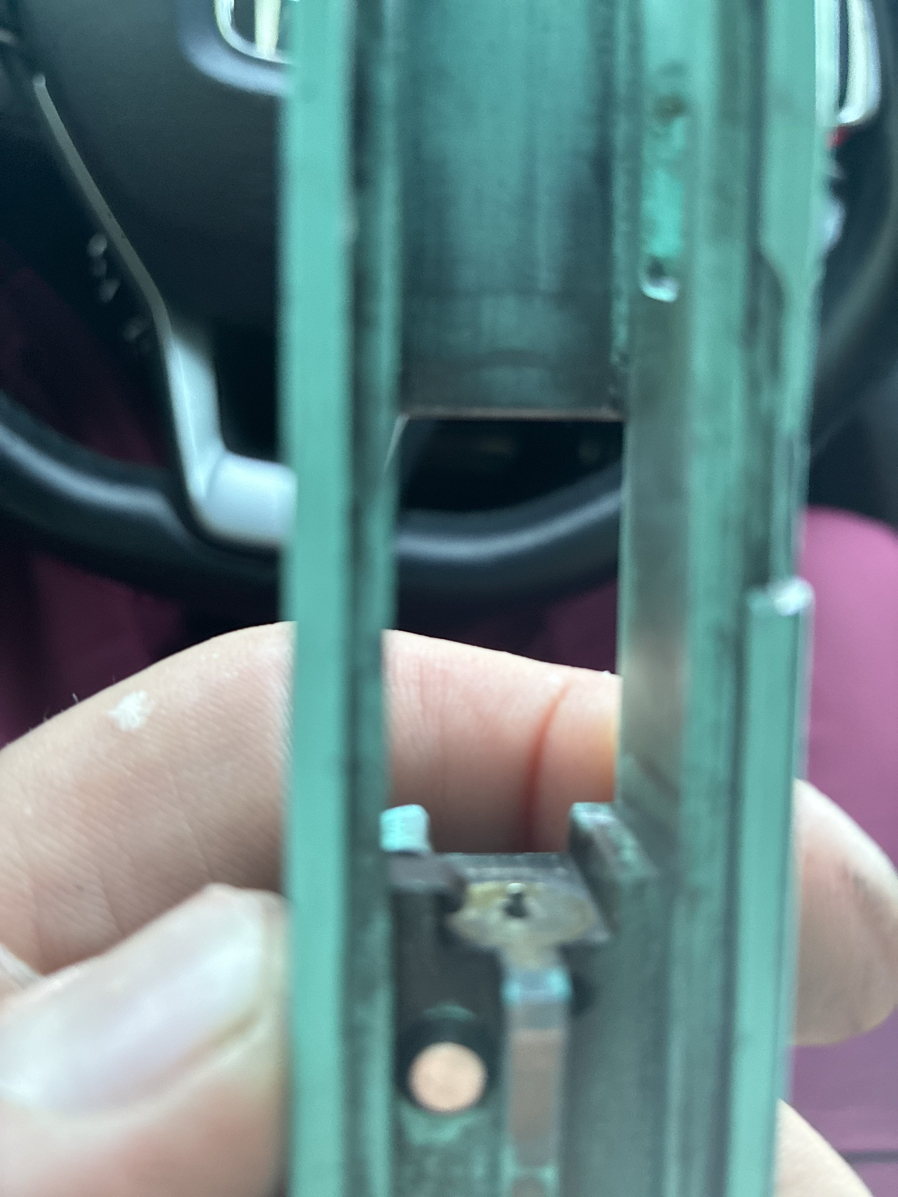

Here’s a picture of the slide just so you can tell me if everything looks like it should, but like I said, the same slide worked on the other frame with the same parts in the lower of the other frame

Racer brought up a good point. Does your firing pin safety allow the firing pin to pass? Take your barrel out, press the firing pin safety, and move the firing pin all the way forward. Can you see the firing pin? If it is not moving freely, your firing pin spring is probably not installed properly.
I just did that. That’s what it looks like.

So, something is holding up the firing pin. That might explain the light strikes.

how high is the rear of the slide sitting? light strikes was onea the issues I had with the Geisler frames originally before I identified that the rear rails were not bent to an actual 90* and this will explain everything working in one but not another... As Racer said an armorers plate is essential Glock builder equipment as the reason the slide sitting high is an issue is...... Say it with me guys "STRIKER ENGAGMENT"
IF you have not read through all of the geisler build posts go to the one "Whats up with the huge gap" I posted several pics in there as did others in the end the fix was pretty simple but does require a vice and some care to correct the angle of the rear rails

I bought 3 geislers myself only 1 had the rails not fully bent a friend bought 4 after I told him they were GTG.. 2 of the 4 I had to correct the rails on... these are all gen 2 I've not seen anyone selling the gen 1s anyplace I think the majority of those are now already in use or pulled all the sellers I've seen only have gen 2 versions
so yea ya could have 1 frame with the rails being higher than the other frame..... that will cause the striker to be released before being fully cocked I experienced that with one of my friends with my first ne the slide catch would not engage and the slide would ride over cartridges in the mag without catching the rear of the case head
because the quality control seems to be pretty spotty with geisler there tends to be some frame to frame (actually the polymer frame seems to be GTG its the rails that are inconsistent from kit to kit) inconstancy that the end builder will have to address.... was the same with early P80s as well as the lone wolf freedom wolf etc etc... thats the thing about building 80% guns... go check out the AR10 threads we had a very popular dealer that had every single receiver being made with the safety detent hole 1/8" off from spec.... took myself and another member writing andf sending pics erc.. for them to finally contact the manufacturer and get it corrected I still have 2 of those blank AR10 lowers I needa fix and machine someday..... when I was doing 1911 80 % frames there was one brand we'd get through SARCO that the grip forging was consistently "bent" so part of the build was to use a press to straighten the grip before ya ever started any milling its the nature of doing these builds
