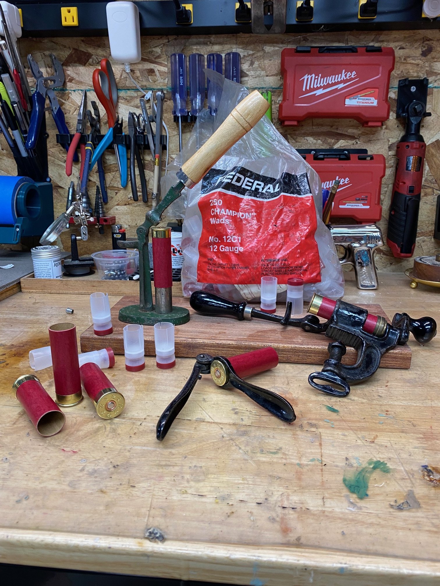

Everything is just about coming together for my paper reloads. All I am waiting on is my Red & Green Dot (coming tomorrow Tuesday the 7th) I going to be reloading them with an old roll crimper I got off ebay.
Here is my first loads:

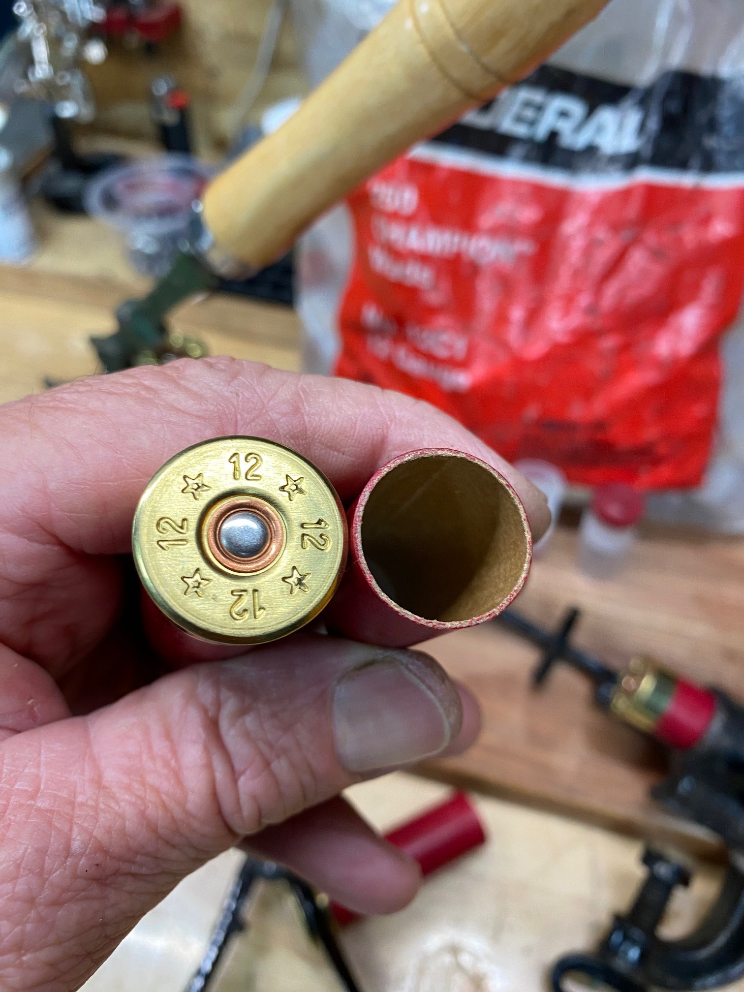

Cheddite 2 1/2 Paper Hulls with CX2000 primer
Federal 12C1 wad
Red Dot 17.5 Grains
20 Gauge Felt filler wad (If needed)
#00 Buck 6-8 Pellets (We will see)
Over shot card
Rolled crimp with the vintage machine.
I also plan on doing the similar loads with #1 (10 PELLETS) & #4 (20 to 21 Pellets). I will most likely also try a different wad (CB3118-12R) and powder (Green Dot, & e3)
